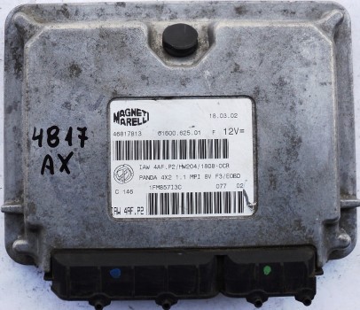

Anyhow, I am getting closer and closer to indeed have a practical stand alone out of this thing. Some things are yet to be tested to confirm.
The important factor missing here is some intuitive software so people who can't see the Matrix can alter the mapping. Maybe you can write some. :D
I guess the other way (the way you are planning?) is to sell pre flashed ECU's for specific modifications but since every Cento (especially Turbocharged) contains bespoke parts for the conversion they will likely require a different map. I'm assuming the auto adaption will do its thing to a small degree but unless you can add a knock and wideband to your armory that's still not much use? Alternitively you could travel the world supplying these mapping them on site but I guess that might make the cost prohibitive. Of course the final option is to sell a complete kit with all the required parts manufactured the same.
Keep are the awsome work anyhow. (y)
This intuitive, no? Why would I write anything myself while there is TunerPro out there. Some things are and work better than in the DET/EMU software (y)

A small update. I managed to solder on (pics perhaps later) the two missing coil drivers for the sequential spark, and, after muscling the ECU program a bit, I squeezed the sequential spark out of the thing. Being safety (for the driver and for the engine) critical this needs a bit more testing though. Then the Launch Control is also in place already, and I started working out a diagnostics interface in TunerPro, now it is a bit of tedious work of defining all the data items I want to have in it, but otherwise it is there and works. Idle valve control things also worked out and tested, was not as self-adaptive as I thought, but very clever nevertheless, everything is based on expcted load on idle (judging from system's voltage, air con system pressure, etc.) from which the ICV opening is then derived. Now it is really slowly the time to think on how to live map this thing...
Another video for Mr. Honeymonster visualising the EBC closed loop mode and showing off TunerPro and convincing him it is better than he thinks. The correction kicks in when boost error is below 15kPa either way, otherwise stays 1.0. Boost control itself kicks in at 120kPa of MAP. On the top you can see the DC table for boost, where the current cell is marked (RPM vs. Target boost to DC). It stays fixed in one position, because the RPM and TPS are constant, I was dialing only with the MAP. The diagnostics readouts are also part of TunerPro.
