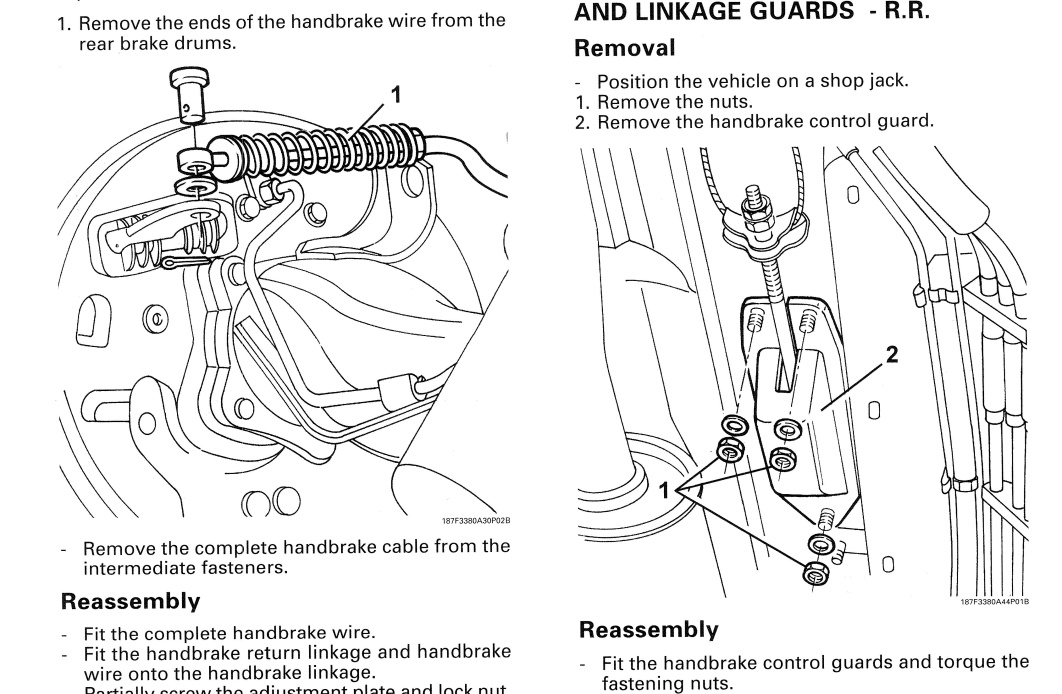

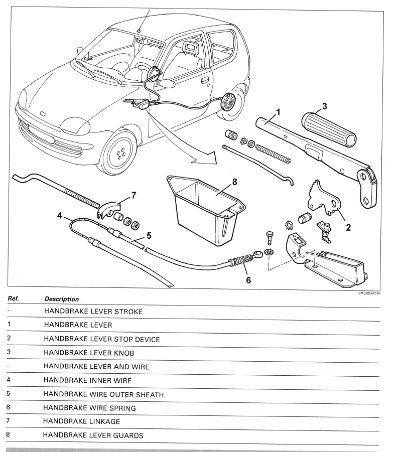

Also this morning when I went to take it to the garage when I went to release the hand brake button it wouldn't release, it was like the button was stuck, dunno what I did but after a lot of cursing and hitting it released. Got to the garage an engaged it but the button didn't pop out again
