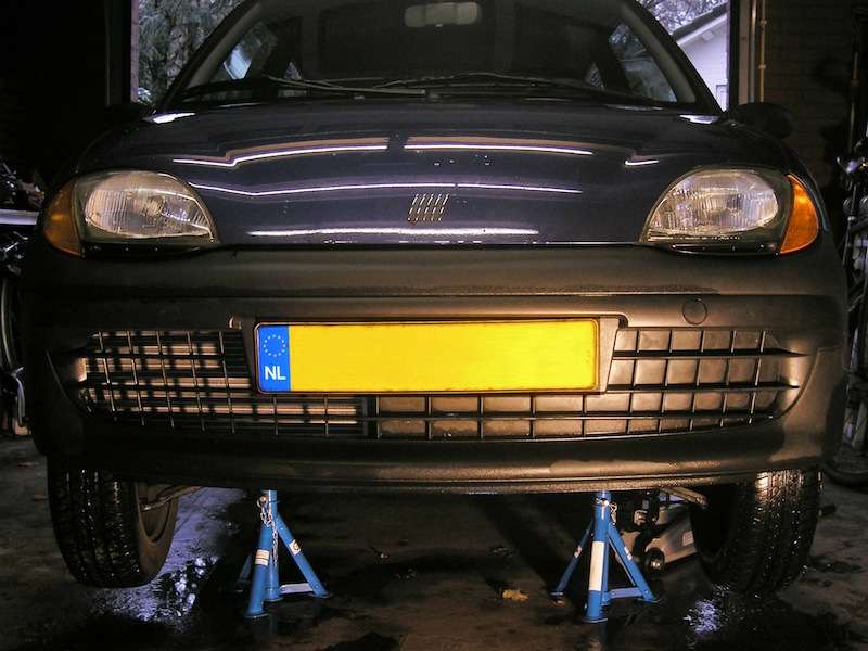

Jack up the Seicento and put it on axle stands (not necessary, but comfortable):

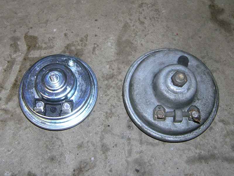

New and old horn side by side:
Simply bolt on the new horn and connect the wires:
The new one makes a lot more noise
