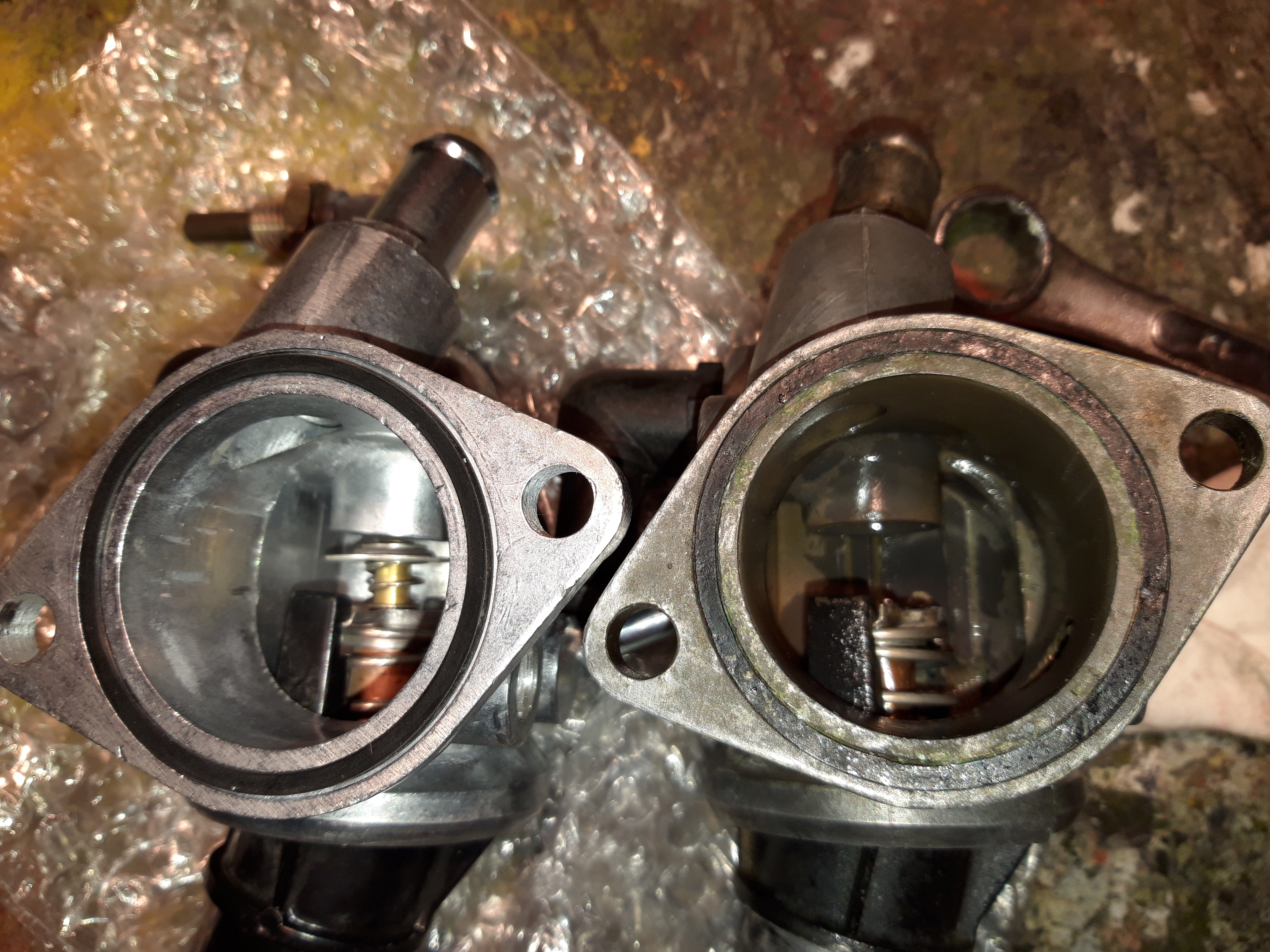

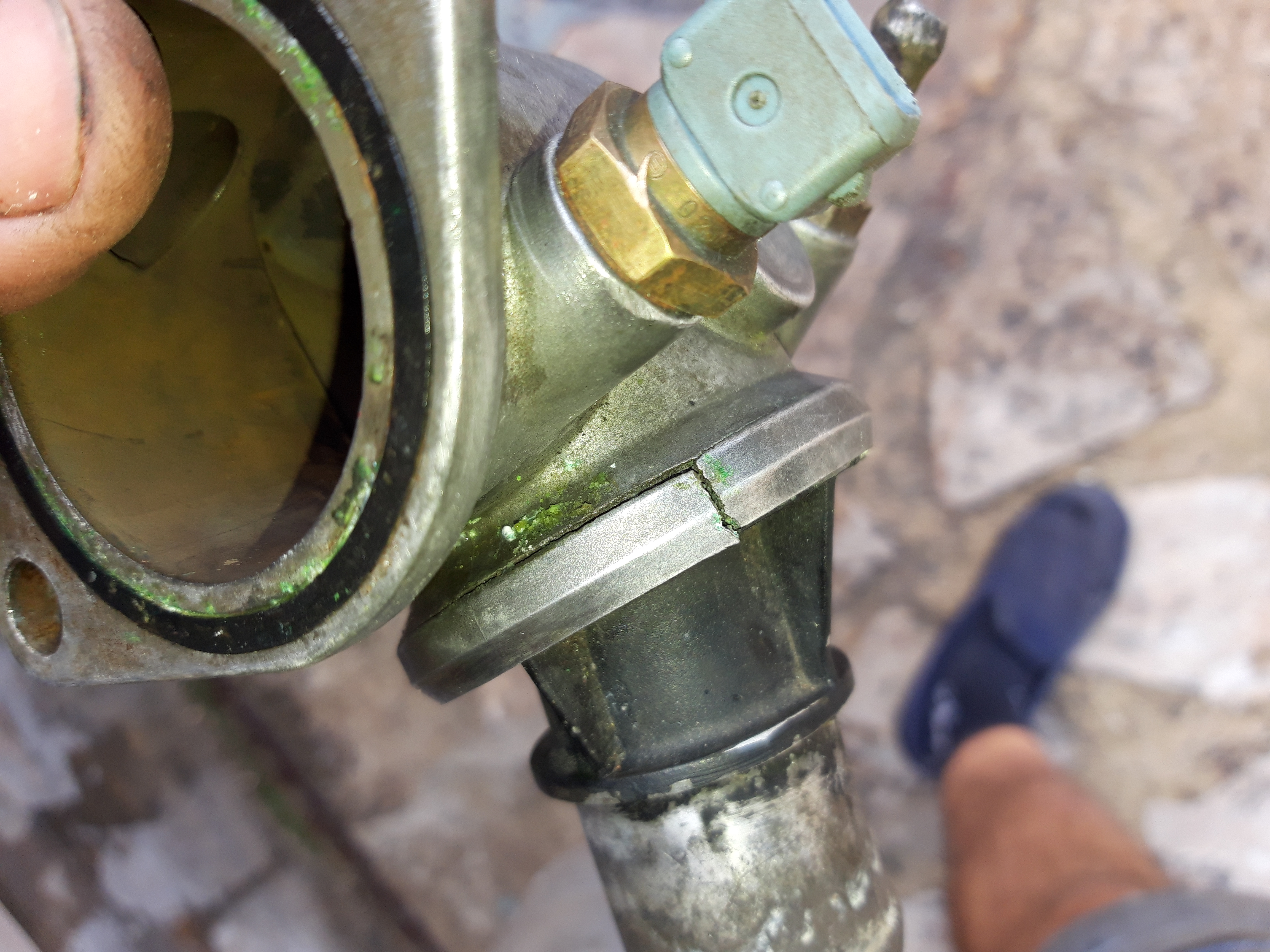

My temp gauge always appears a tad low, which i thought was contributing to the idle valve issue, taking ages to drop the revs when car heats up.
Ive also had a minor water leak, but couldnt find the source.
As ive been tinkering in and about the thermostat, i thought it looked as if it was coming from that ??
So bought a new one €30, online and delivered today. Removed the old one and found underneath a crack in the housing between metal and plastic pipe section.
Also looked inside and the old one appears open ???
Am i correct ?
Look at the new one compared to old one!!
Glad they are still delivering parts, so i can do jobs on the car whilst in lockdown !!

Yes, thermostats normally fail open....I think you can be confident the new thermostat will cure your cool running(it did on mine) and your water leak. I've also been doing a few little jobs, think I might take the opportunity to do a full service
All the best
Mike
