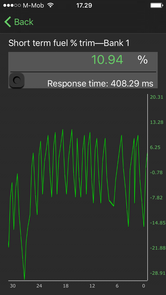

Reading from my OBD app, the o2 sensor nr.2 seems to go to 0 every time the engine runs on 3 cylinders. Also the fuel trims seems to fluctuate alot, going from a "normal idle" short term trim -60,9 to 37,5 when idling with 3 cylinders.
