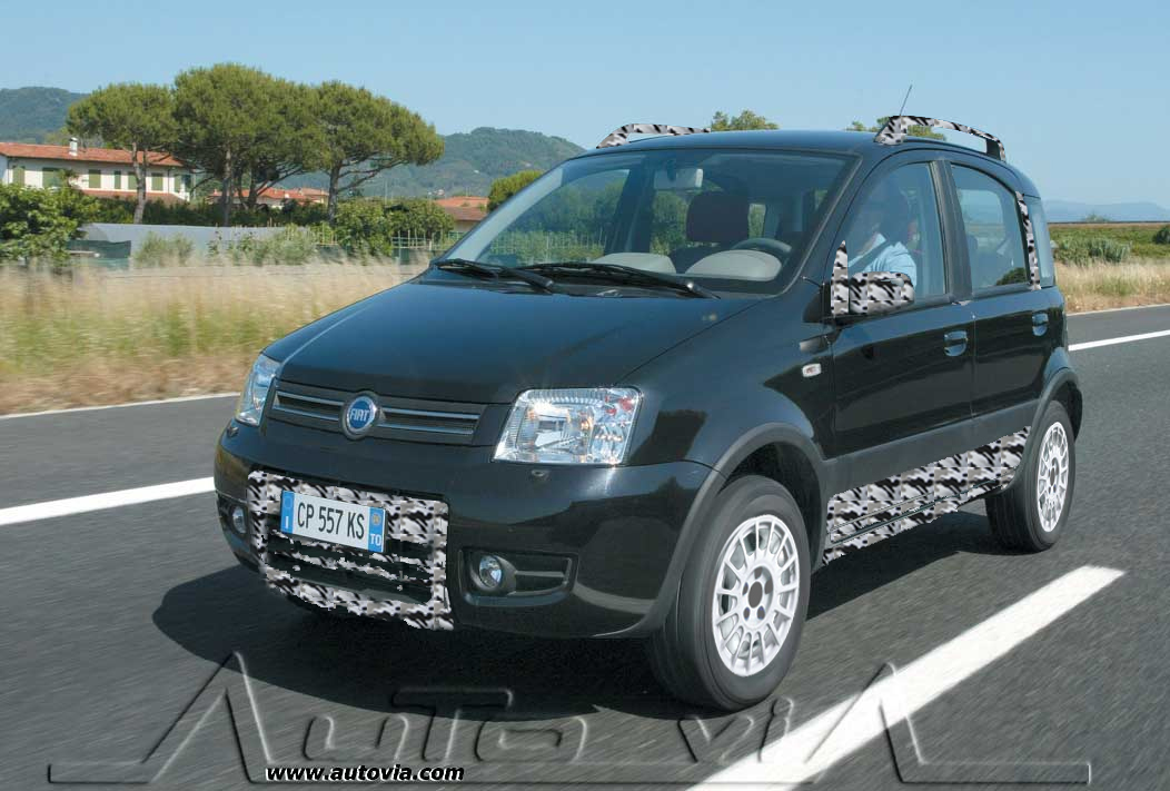

its time to get some winter tires for my Panda 4x4. I've decided to get som white compomotive TH3's as I have had very positive experiences with the compnay's products before on an EVO VI.. bit of an overkill on the little panda.. but they will look really nice against the black exterior.. :)
the standard tyre/rim combo on my climbing version is 185/65 R 14
my question is to all those in the know.. what are the possible sizes of rim that I can put on the car without modification?

Appreciate that you like the look of the rims. They really are top quality as well, you will find that a lot of race and especially rally cars are mounted with compomotives.. yeah yeah, overkill, I know. But they will look great.. especially after I put on some snow-camo vinyls on the roof racks and lower body panels. and add some nice white mudguards.. juvenile, yes.. but fun.. it should even manage to turn some heads in Verbier, hehe

For a 15inch rim the TH3's are available in 5.5x15 through 7x15 (no 16 inch but there is a 17). I could go with 165/65, 175/60, 195/55, 205/50 on the 5.5x15s. Would there be any reason to choose a wider rim than the 5.5s if I wanted to use one of the three wider tire options?
For a 16 inch rim I would have to choose the TH2 (which is also nice, it’s what I had on my evo) that is available in 5.5x16 and 7x16.. so I could go 185/50, 195/50 or 205/45.
I will only be using the Panda during the winter months, so I’m inclined to get the nice big rims on my winter tires since I will never mount the summer ones again.. but I like the TH3s more than the TH2s so I just don’t know anymore..
..have added som pics so everyone understands what I'm talking about.
