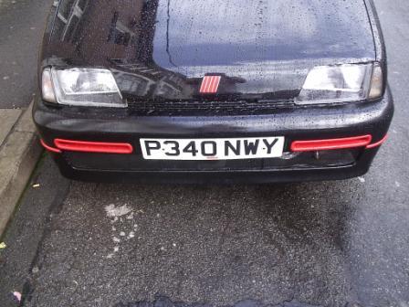

when i did mine not so long back i used spray paint and lacquer from a can
i stripped the bumper down and made sure it was well primed and waited for the primer to dry then spray the paint on in thin layers once you have done that wait fo it to dry and then apply the lacquer same again think layers and just build it up
did that with mine and this what it looked like
hope that helps
any ting else just ask and i will try and help
