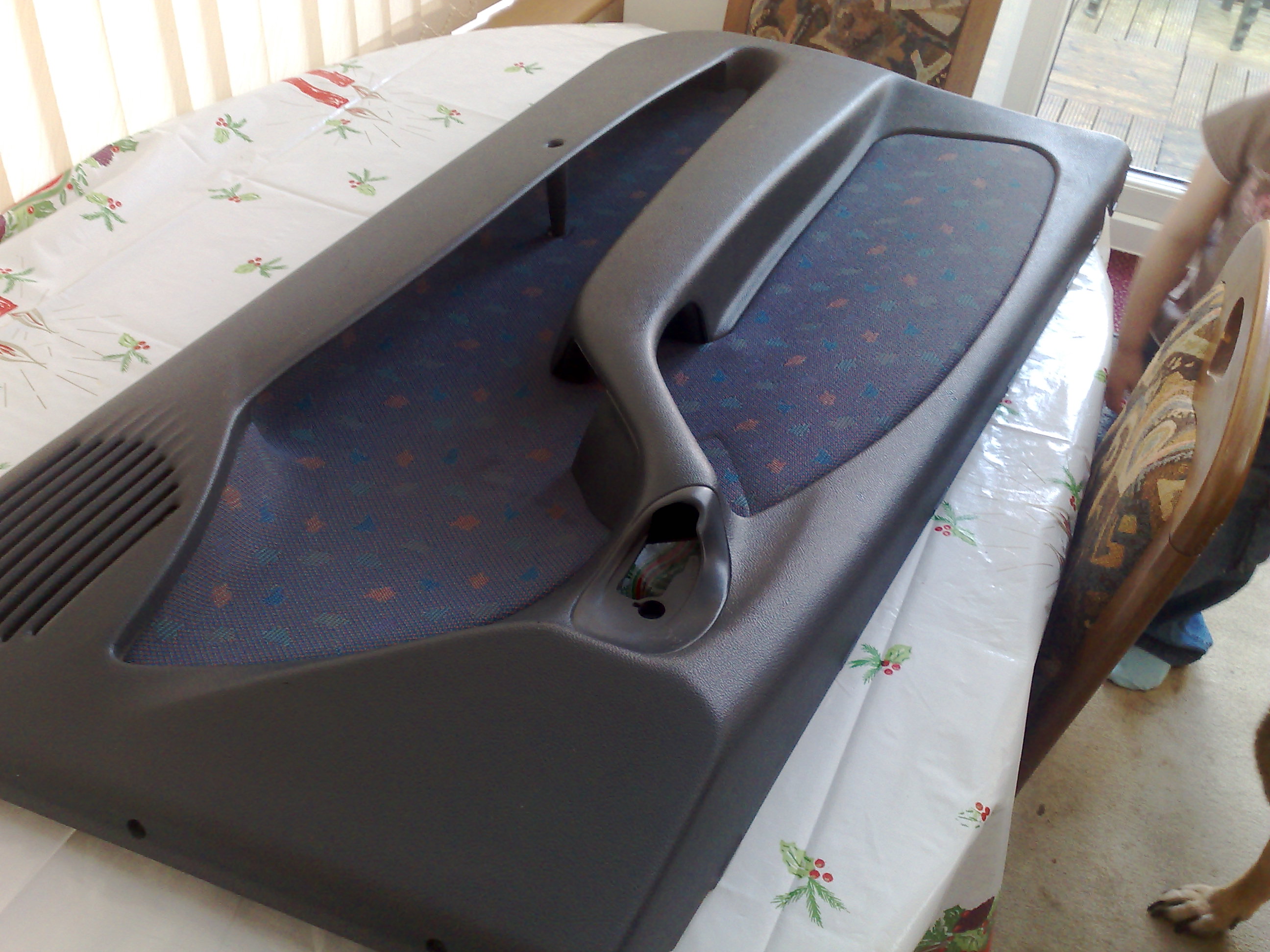

now you've got the trim off.. hijack your parents dining table and prepare for the worst bit :rolleyes:
this is what you should be faced with!
the cloth door card is held on in a very weird way.. its like.. the card has holes in it.. the plastic trim has spikes.. the spikes go through the hole, and then had the top melted so its like a T up and through the card.... if that makes ANY sense

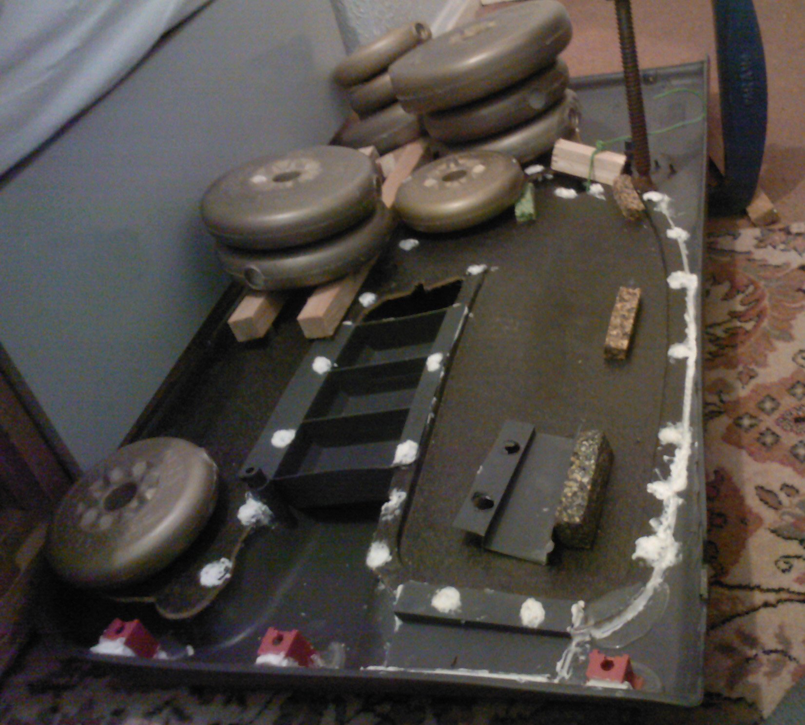

this bit is really hard.. the only proper points are the plastic pegs.. but the leather has holes in it where it was removed from the HGT plastic trim.. i just covered each peg in adhesive, and then found anything i could that was heavy to push the leather down. at this point i had to take it outside cos my parents wanted to use the table.. :rolleyes:
its quite hard to get the leather attached, so try anything you can.. i tried to get some silicone to try and make more pins like the orignals.. which you can see in the picture.
ive not reattached the trim yet... cos its dark.. but it should look good! it comes away abit from the trim but when its pushed back on, the points behind the leather should push it up against the trim more.

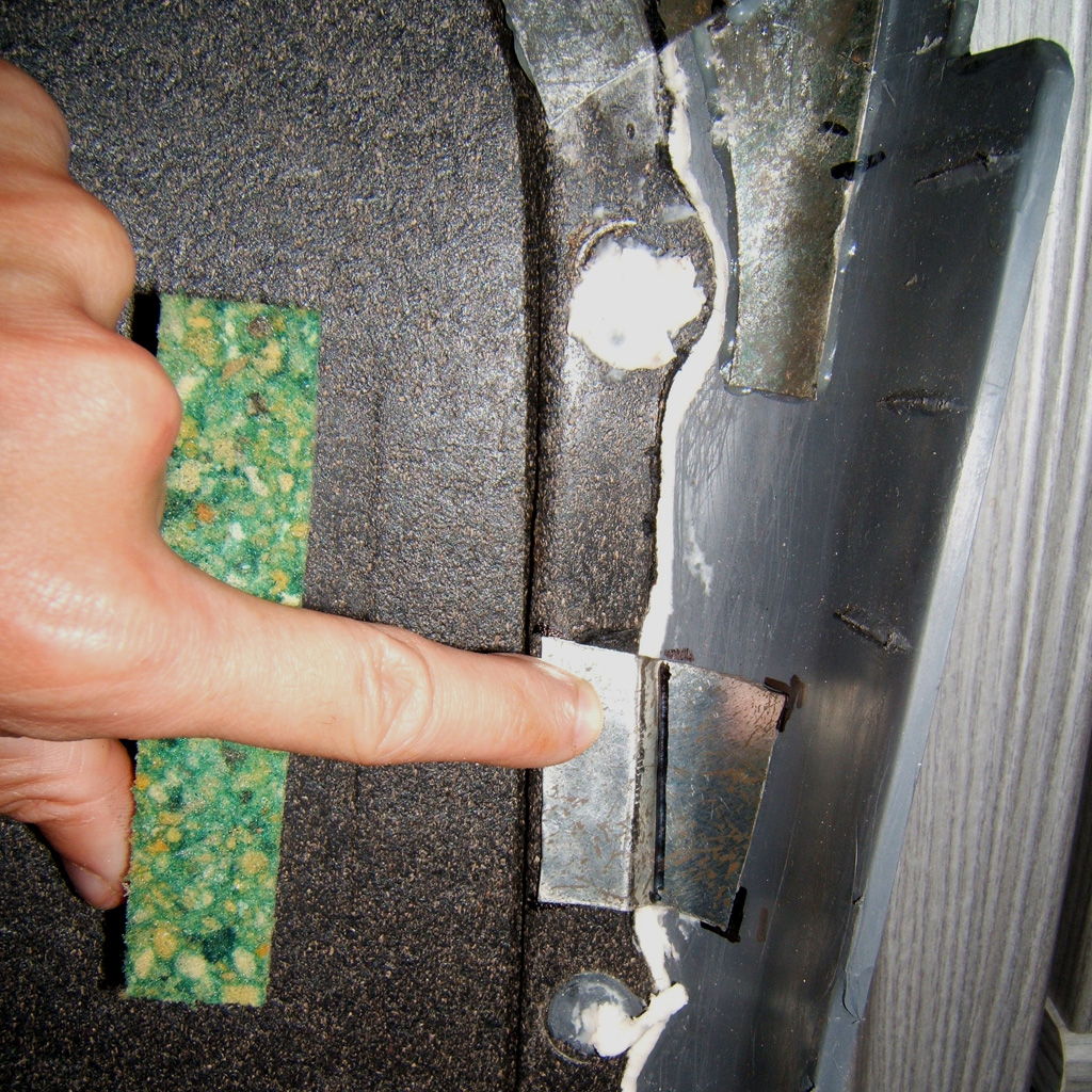

Its tricky seperating the card from the plastic. I had to do it cause my plastic was smashed to bits and I couldnt find a card in my colour.
I used half a tube of no more nails one one card :p Its rock solid now.
The plastic box in the middle was good, for extra strenght. I put no more nails down the sides and where it meets the card.
Those red plastic clips are a nightmare badly designed. My originals where smashed to nothing, my new card was ok but the original glue wasnt holding them
Oh yeah I think your supposed to lift the card of the door with the black top trim still attached, much easier. Even though haynes says not

On my new door cards I used araldite and buscuite tins!
This is so solid. Worked really well, especialy where the plastic snapped at the door pin.
Make sure you use G-clamps while the glue sets.
