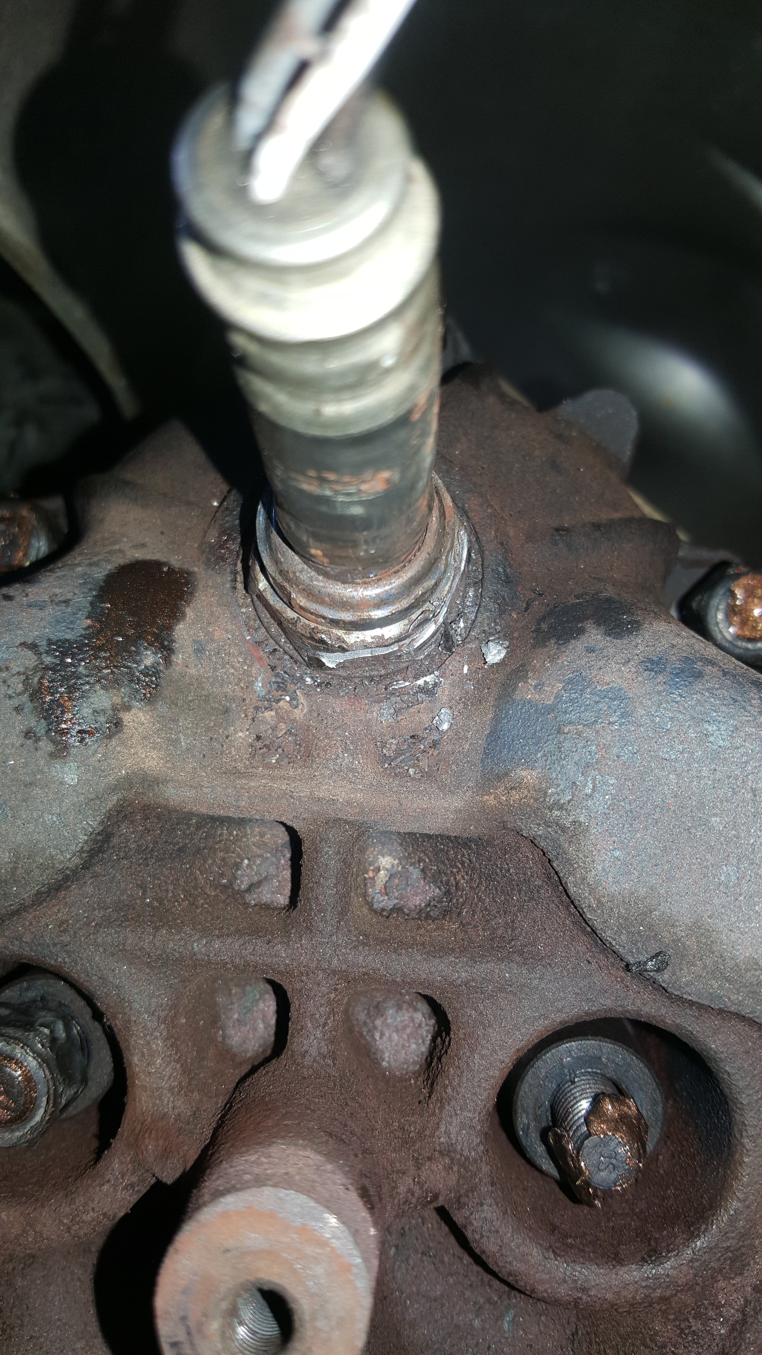

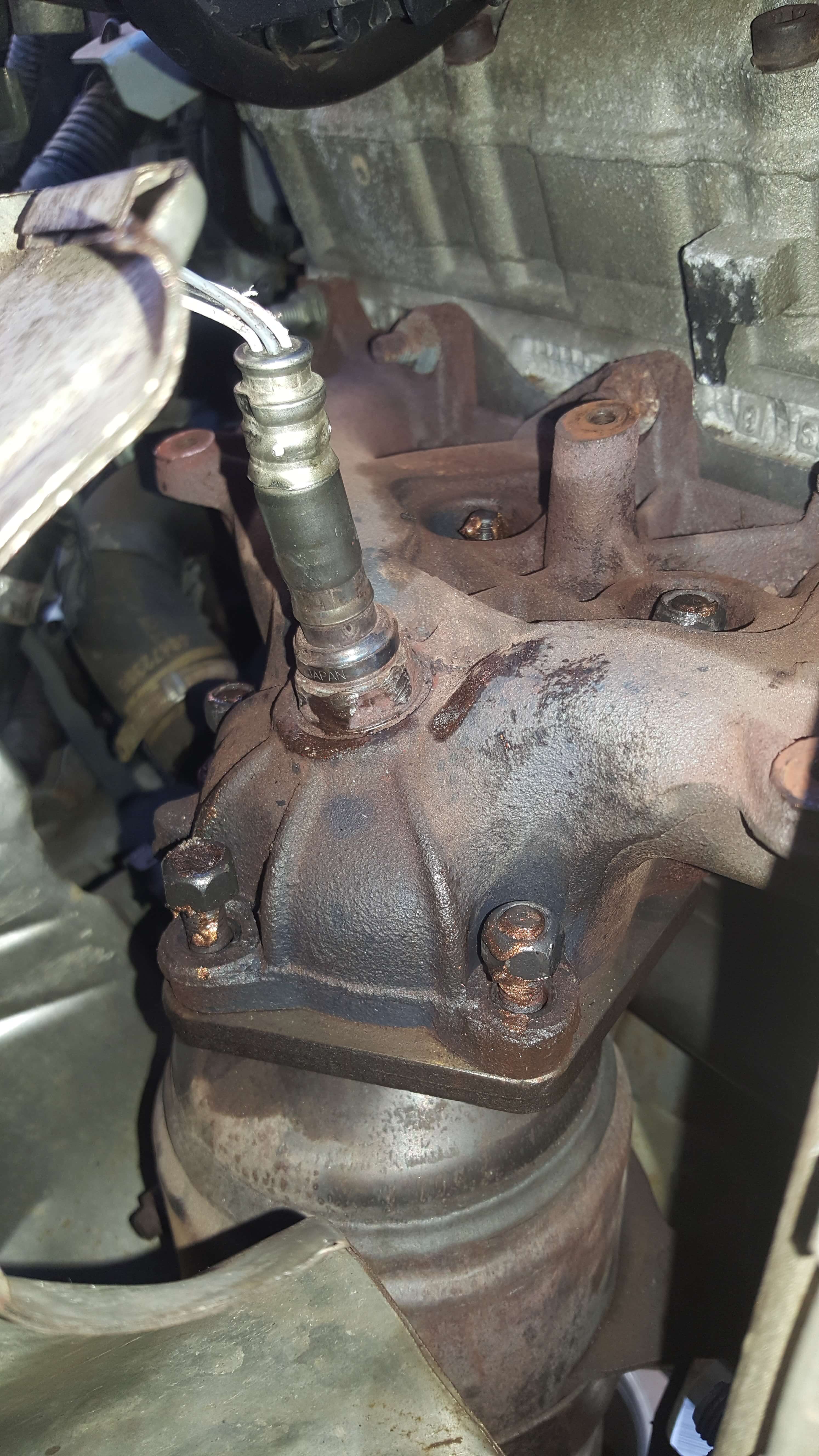

Come to think of it, when I jacked up very slightly the exhaust pipe from below, to try and see whether keeping the cat flange pressed against the manifold would help in unscrewing the studs, i actually noticed that the cat flange detached itself from the manifold by almost half a cm!

You're trying to withdraw the unit off the studs..?
With the nuts removed the unit should just pull down off the studs. Don't be afraid of using a big hammer and a really wide screwdriver /chisel to force it apart. Bad language and cursing often helps.
If all the nuts won't come off - remove those that you can, then use one of them to put onto a stud that has a stuck nut. Tighten the top nut down as far as it will go, then use a ring spanner on the lower nut (extended the ring spanner with a piece of pipe if need be..) and use the '2 nut method'. Chances are, the stud will also undo.
The new unit has studs in? If so .. it doesn't matter about damaging the old studs.

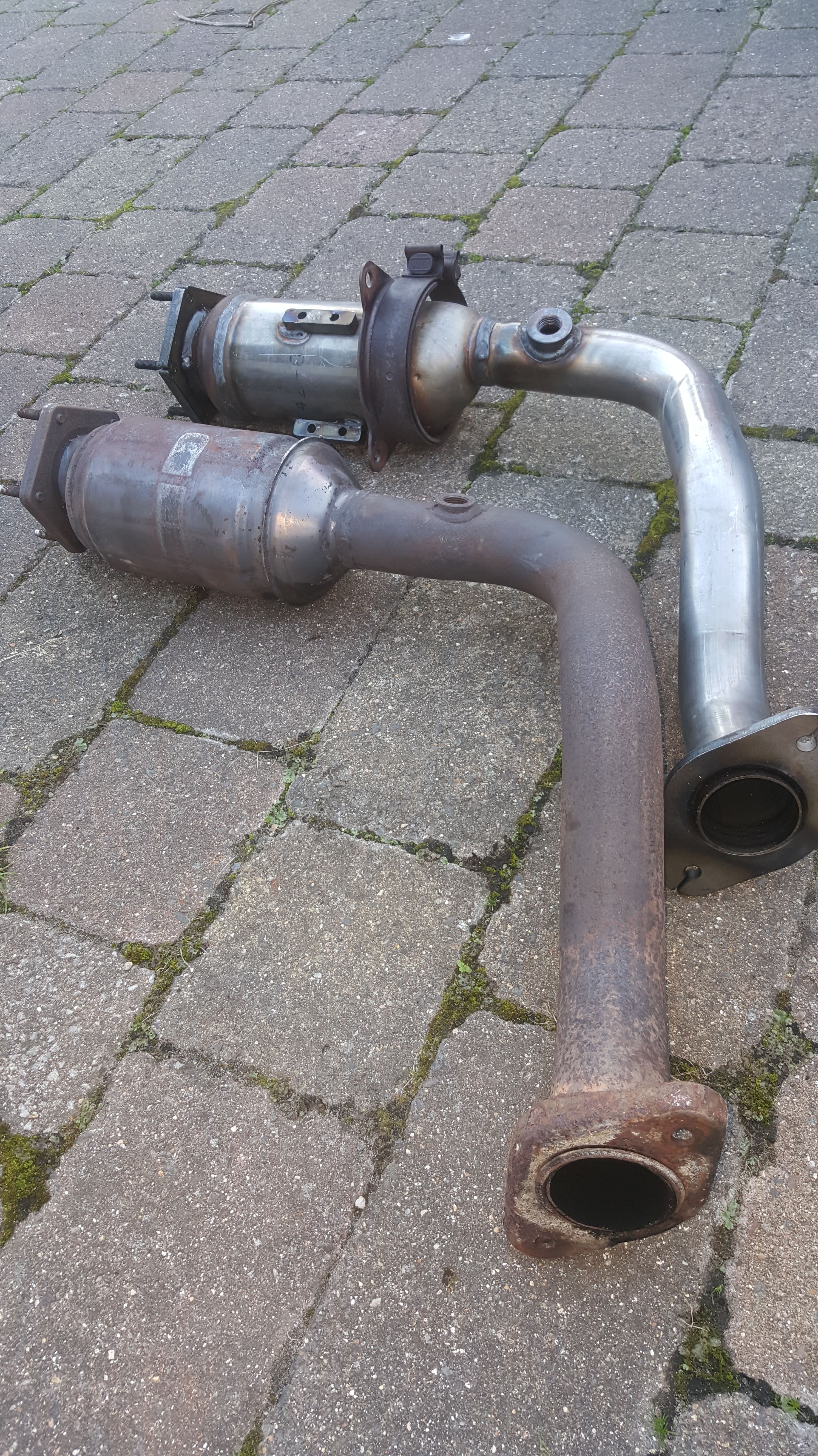

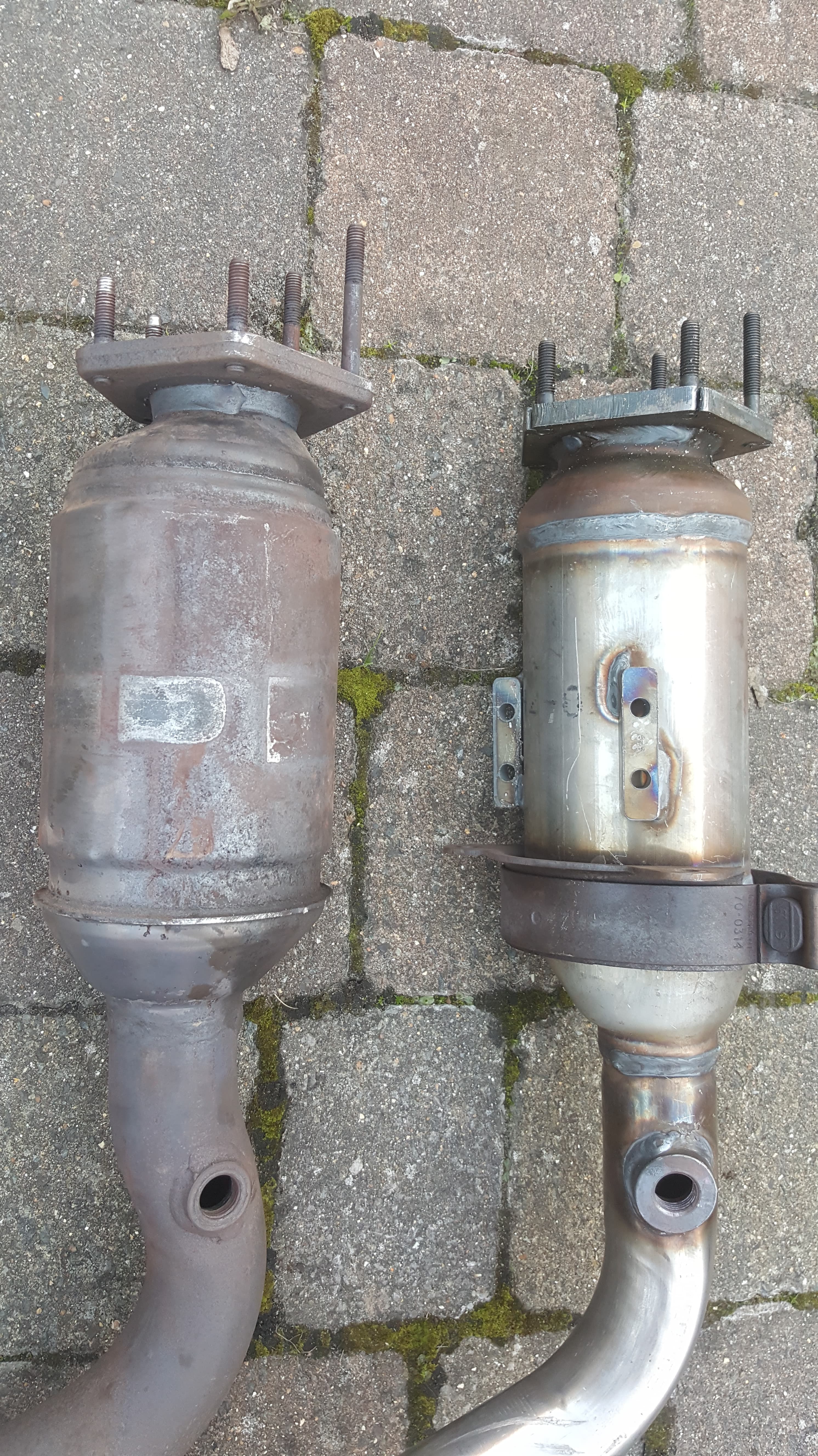

BUT as soon as you overcome one problem you are faced with another one. I only noticed now that the replacement front exhaust is slightly different in three ways:
- it is a bit slimmer (which means that the metal band which holds the catalytic converter mid-way is a bit too big for it;

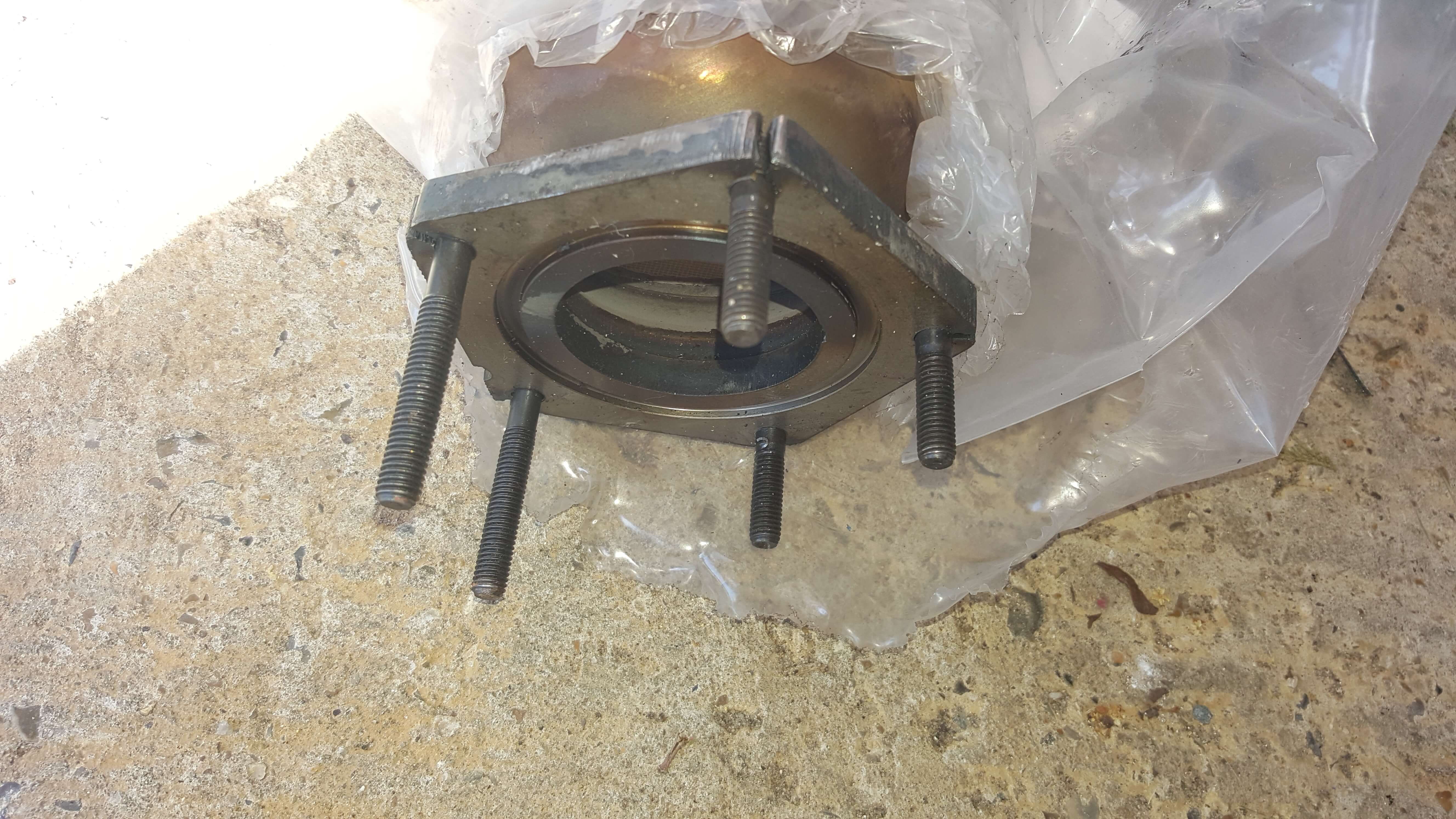

- maybe to compensate its being slimmer, it has two vertical metal ridges, with two holes each, mid way on the cat, where the band would be in the original part;
- two of the five threaded bolts that join the front exhaust to the exhaust manifold are too short, so that I cannot secure them with a bolt on the other end!
I'm attaching some photos to illustrate what I've written above.
At the moment the new front exhaust is only partially re-assembled: meaning that it's hold in place just by the three bolts I can actually screw on the studs (which I haven't even tightened for the moment being).
I guess the proper way of doing things would be to order some studs about 2cm longer, then pull out the front exhaust once again, swap the short studs with the long ones, and reassemble everything.
But I wonder if I can simply apply exhaust putty on the star shaped flange/interface between front exhaust and manifold, and simply make do with tightening the three studs which I can actually tighten? Or would there be the risk of leaking exhaust fumes?
Exhaust assembly paste is commonly used to connect exhaust flanges together. It sets rock hard within minutes of the engine being started and the exhaust warming up. It provides a gas-tight seal.
If there's any studs/bolts that aren't long enough .. for whatever reason .. change them. There's absolutely no point in spoiling a job for the sake of a few quid. If you're going to fix something, fix it once.
When fitting an exhaust, don't just connect one flange to another and tighten the bolts. Put nuts on finger tight - at each end - and then 'jiggle' the pipe and wait 10 minutes. This allows the pipe(s) to 'settle and hang' correctly.
Don't just fully tighten each nut/bolt in turn. Do it progressively. For example, if your flange had 2 bolts, you would tighten each one in stages alternatively. This allows the 2 mating faces to be drawn together smoothly.

With regard to the fact that the two longest studs in the new exhaust were not long enough, what I did is I managed to unscrew them from the old cat, and again I re-used them as they were not rusty nor the thread was damaged. Perfect!
Then I made sure the two surfaces were very clean, spotless, and I proceeded to tighten 5 new stainless steel nuts to the 5 studs, going in a star pattern. I did not add any exhaust putty/paste because there was no trace it had been used, and I don't think it was needed (I had not yet read your post!). I also I feared it could make the seal less good if applied incorrectly... We'll see!
