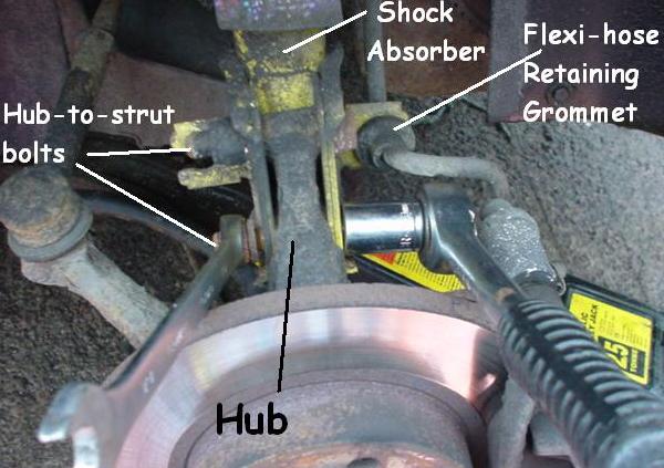

Put on your safety specs and get your wire brush and clean as much of the mud, grease and rust off the two shock-absorber-to-hub nuts and bolts as possible, then liberally spray oil on the threads of the bolt, especially where it protrudes through the nut.
Go and have a cup of tea while the oil penetrates. When you come back give it another spray – these things are likely to be SOLID.
Use a breaker bar with 19mm socket on the nut side (don’t use a ratchet to break it off as it will wreck the internals) and an 18mm ring spanner to keep the bolt head from turning. Assuming you are at the driver’s side and the bolt head is on your right (at the front of the car), the breaker bar will need to be pushed upwards to slacken the nut. Be careful when it ‘goes’ as you may smack the wheel arch, or worse, your gob. After this, you can exchange the breaker bar for a ratchet to make life easier.
If it’s the passenger side, the breaker bar goes DOWN to undo the nut.
On both sides of mine, the lower of the 2 nuts were utterly doomed and I had to replace them. They were so corroded in fact that I had to use a smaller spanner and socket.
You can see in the photo below that I have the ratchet on the (18mm) bolt head and the spanner on the (19mm) nut.
- Personal preference once the nut is …errr…. cracked off. Once you have taken both nuts off, take off the two thick washers that are probably rusted to the shocker – put all of these somewhere safe.
Using a small hammer gently chap out one bolt. Right after it is out, the other bolt will be loaded by the weight of the hub. Gently tap the remaining bolt until it is flush with the shock. Use a suitable metal implement (poadger) – around 5mm is ideal - to tap the bolt all the way through, expect a good bit of waggling of the bolt and poadgering to free them both. Watch that the strut doesn’t annihilate your finger when it drops down the centimetre or so it does.
