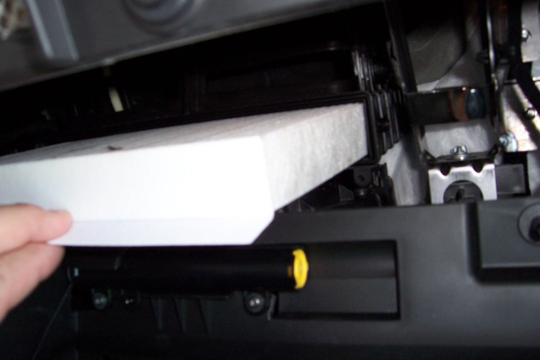

Replace Cabin/Pollen Filter on 500L Trekking
Apr 27, 2011
29,689
Near the M4
Thanks.
Looks pretty similar to the punto..
My 2012 filter looked similarly black.. no leaves on mine though.. as Im careful where I park ;)
I didnt recognise the white cylinder :eek:
