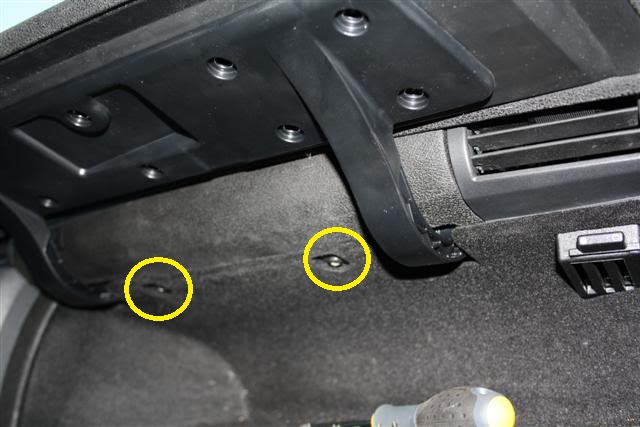

If it's only the liner (part that holds the CD changer) you want to remove, there are two Torx screws in the top of it. Remove those screws, then pull the liner out.
