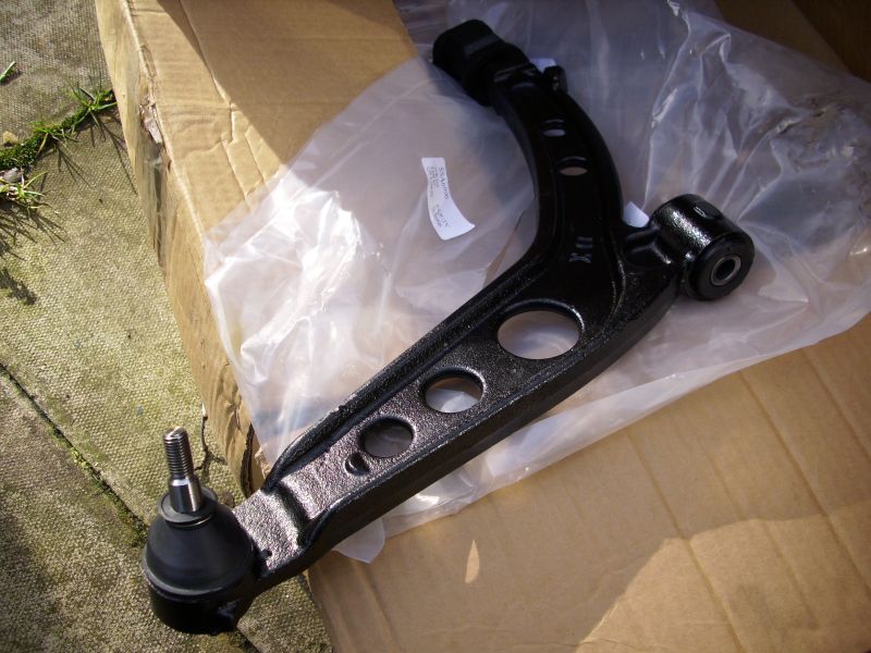

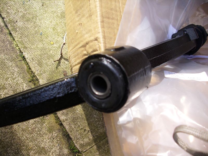

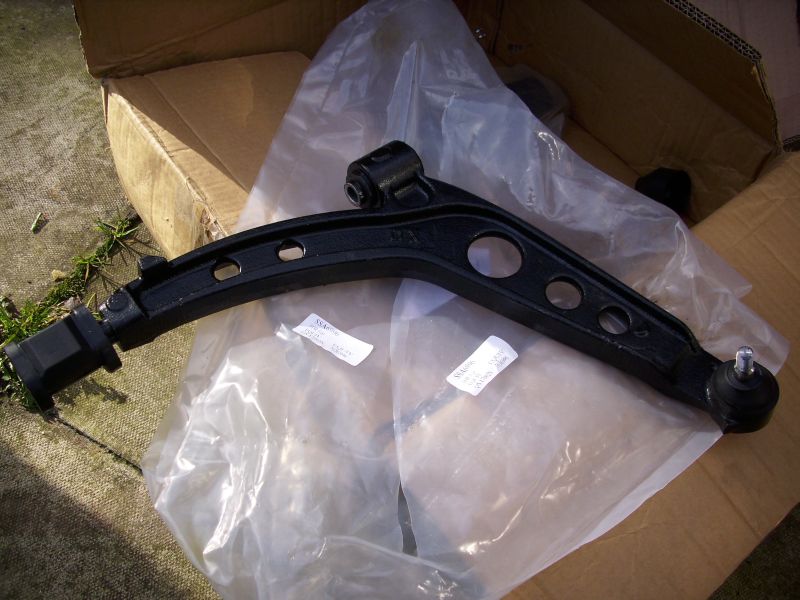

Needless to say, new arms were ordered and here they are [or one of them]

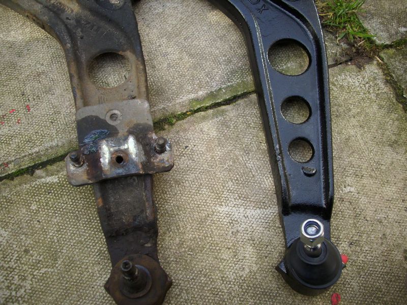

With the arm now off, you need to swap over to the new arm the outer ARB bracket [899 models dont have this], check as you go as its possible to fit this upside down [yeah, it happened!]

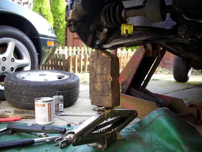

Once these bolts are done up, push the arm up to the hub and push the thread into the bottom of the hub and do up the nut, I found using a scissor jack to apply upwards lift using a block of wood as a spacer pressed the joint into the arm enough for it to grip enabling the nut to be tightened
