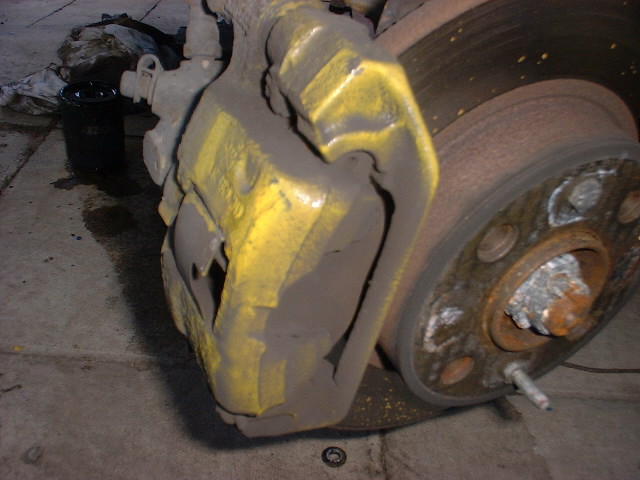

It helps if you turn the steering so the caliper is more accessible
Here we have the caliper, complete with old pads inside,
Look at the bottom of the caliper and you will see a pin, with a very small clip going through it:
