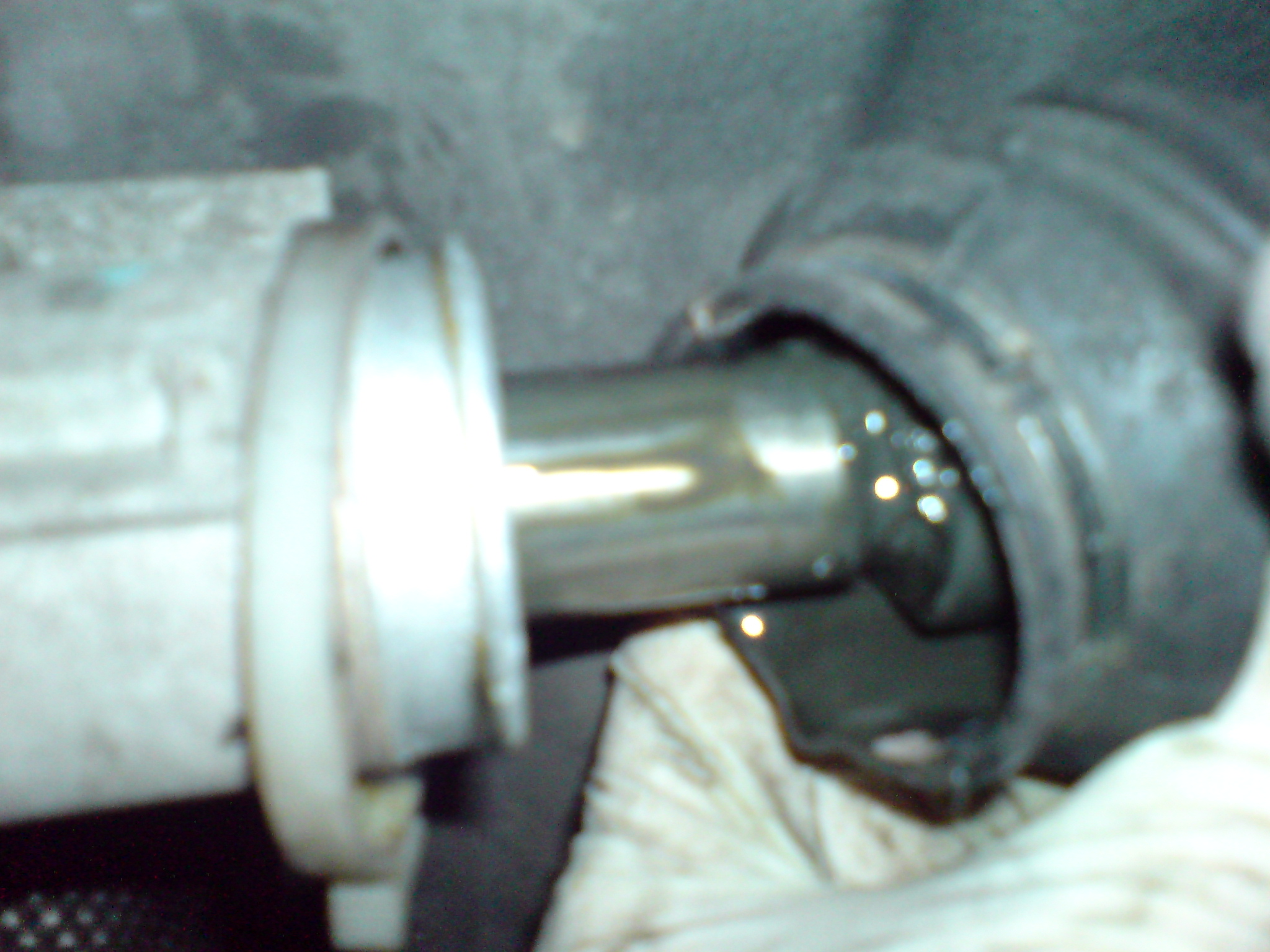

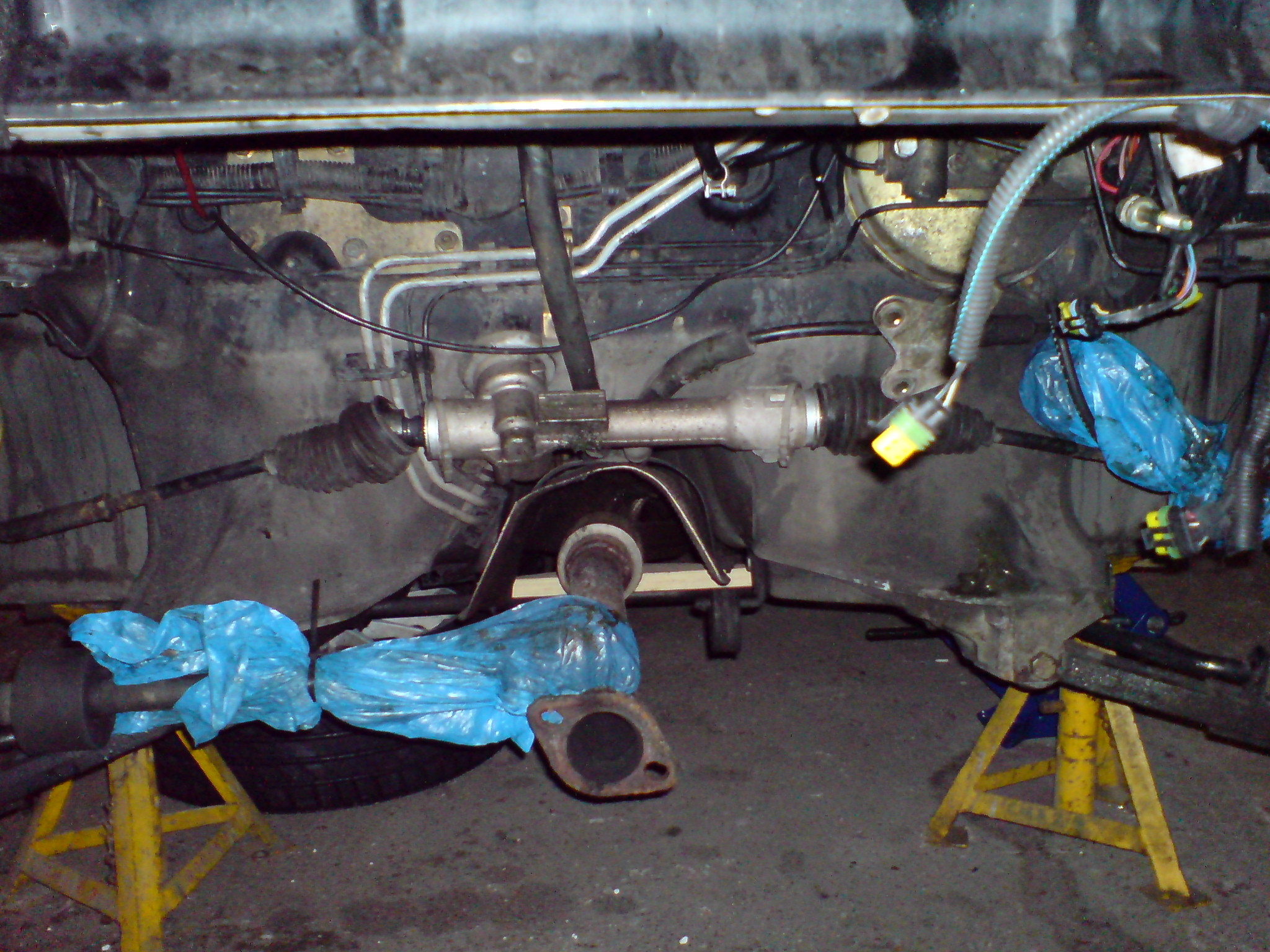

Heres the rack:
Heres the one end, the end with the teeth:
Here's the other end, no teeth here:
Is the idea to fit something over these teeth, and at the other end, thats is secure and solid, so it won't track over any further.

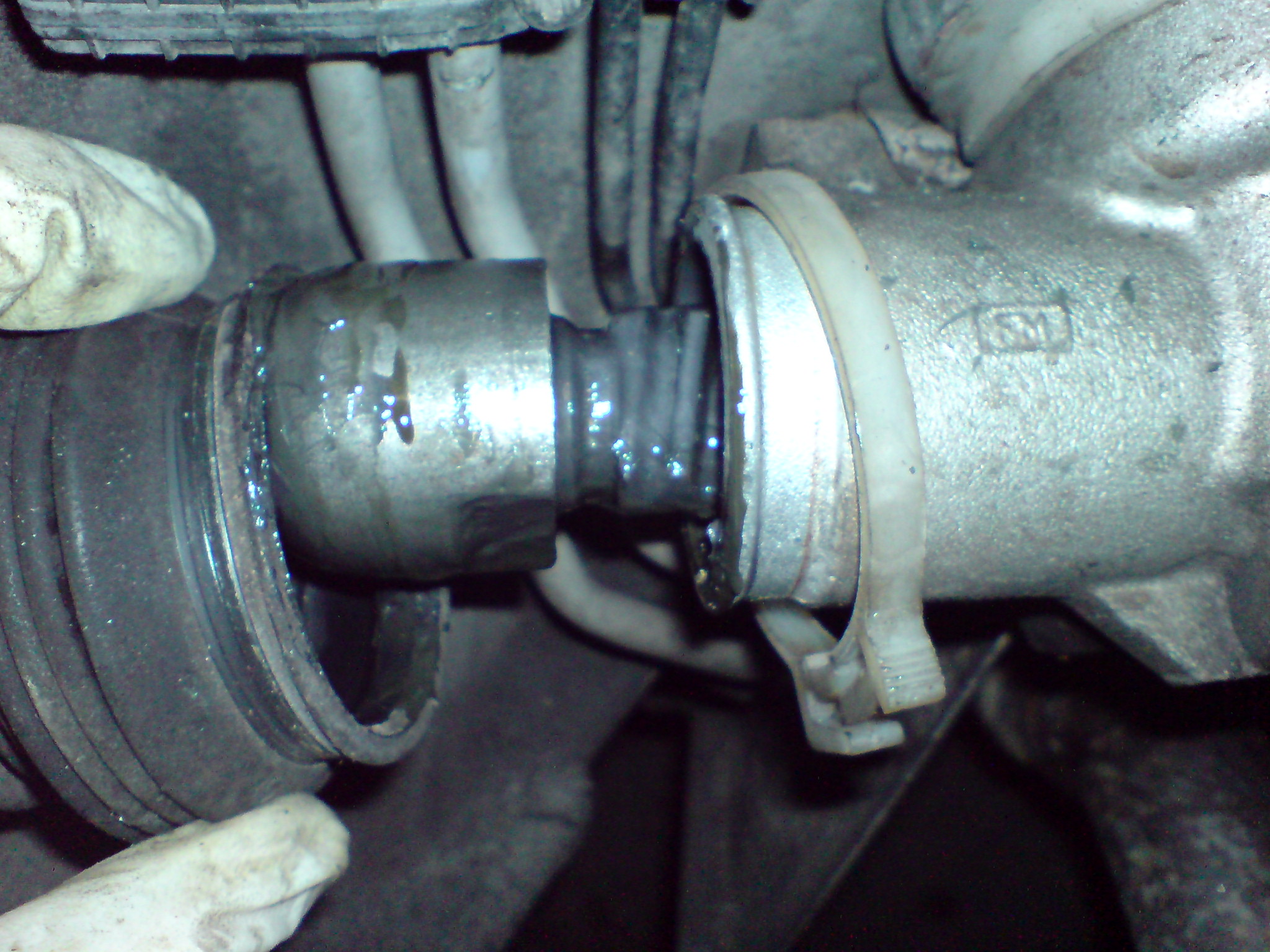

The picture below shows the inner track rod joint under the gaiter. The rod can rotate in the end.
The red highlighted part of this joint is metal, and flat, and it hits a flat metal surace inside the rack housing. This is what stops the lock.
I will get this made in metal as it strong and is how its done at the moment.
To fit them though, they will have to be slipped over the teeth, and this means the inner ball joint an housing needs to come off.
Highlighted in yellow are two flat faces on this joint, so i presume I can unbolt it from the rack...but not 100%. Anyone done this?
A two piece reduce can't be used as there no way to securely clamp the parts together, space is tight.
The green highlighted part is slightly recesed, so i will leave a lip on the inner of the reducer at the end to stop it moving about too much.
Hopefully be cheap enough to have made.
Just need to know if anyone has had the end off the rack?

First, an apology -- I still havn't had the time to pull the one off the scrapper and strip it. So, I dunno how it comes apart.
But, I think you have it right: there should be two things stopping the rack, one for each side (of lock, I mean). The bits you need to have made up will look like extremely (I mean, extremely) fat washers -- should be very cheap if you don't specify anything exotic, literally 10 minutes work on a lathe.
