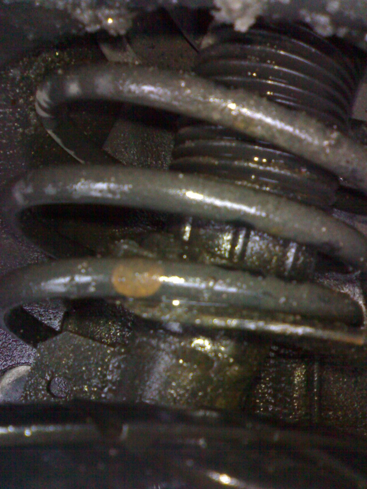

Hi guys
How do i tell if one on my front coils have gone, as it seems that this might be the case as i went over a hump and something seemed to go
Thanks
Lee
heard a bang! but the car doesnt seem to be on one side yet, ill c if i can take a picture of the spring as it looks like they are close together
Has the coil gone?
how can you tell?
By your photo I can just make out the drop link joint and the spring is wrapped around the link adn should be positioned on the mounting point so thats gonna cost you a drop link as well as with the force of the spring wrapping its self around it they bend ..:bang: sorry to be the bearer of the bad news :bang: have you contacted anyone yet ?
