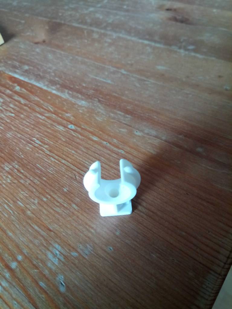

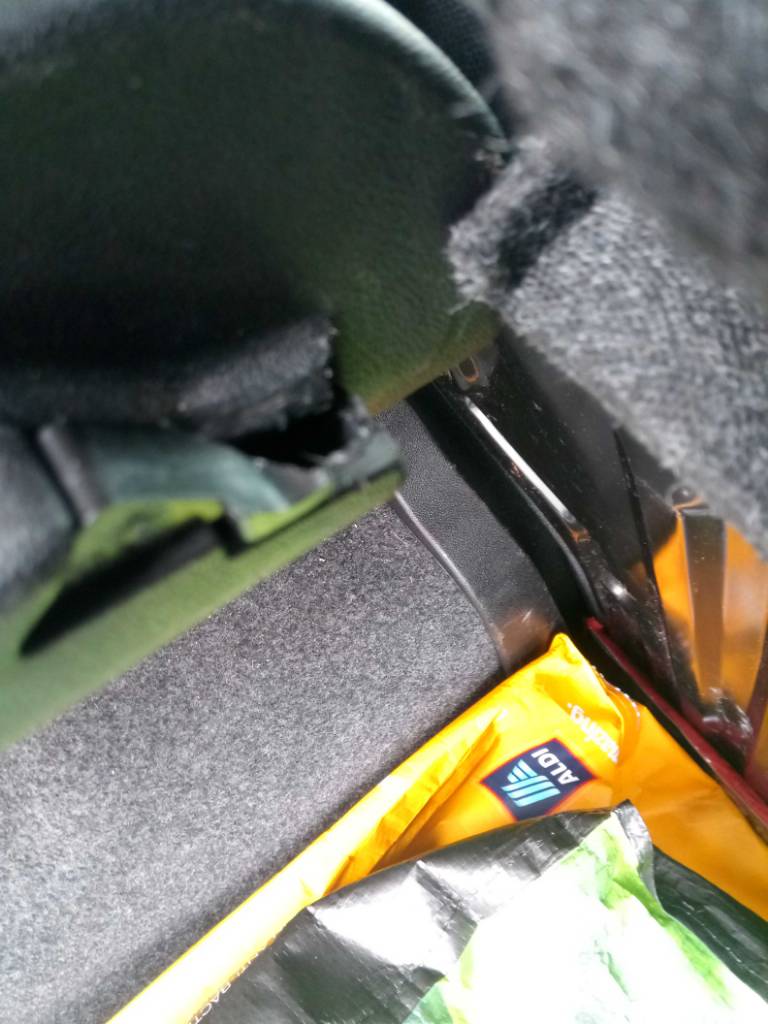

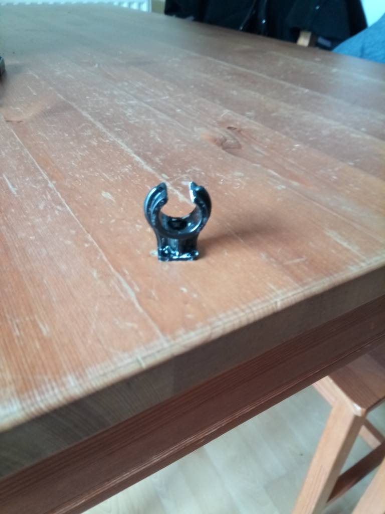

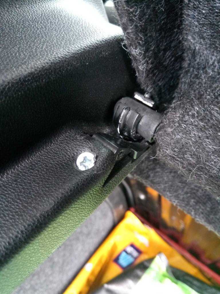

Hi sick of parcel shelf sticking up,here's a quick fix,see pictures below 1560692987486.jpeg IMG_20190616_145145.jpeg
Hi sorry not allowed to add more pictures says am not allowed but the clip does slide in a broken clip , but if yours isn't there or completely damaged probably use a self tapper screw, and hope this helps,sorry again can't add pictures,

Thanks A handy idea as mine has broken away on the fixed part of the shelf.
If the pivot peg falls out of the shelf, acrylic car body sealant/goo is great for a permanent repair. It's available in grey so not too obivous.
