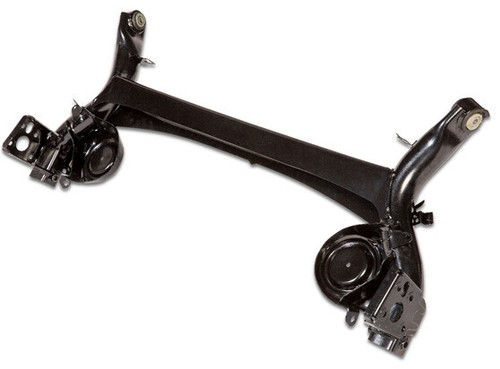

This is a new replacement Panda axle for £145. You can clearly see the hub spindle mounting brackets (four M10 studs and nuts each side). eBay item 153516226784
The question is why are both of your wheels toeing in. They should be at 0 degrees. Has the axle been damaged?

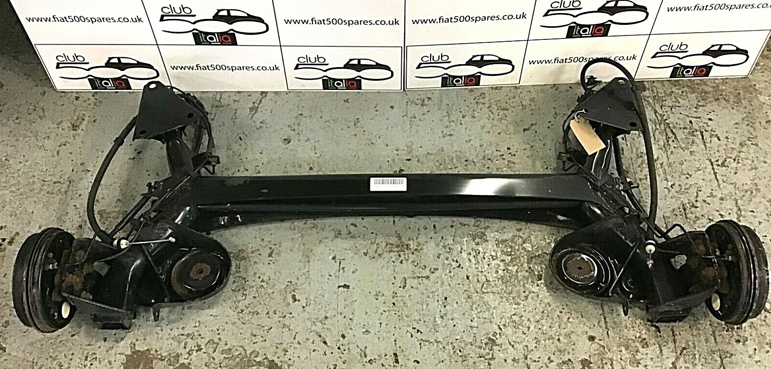

This one is a bit more cash but looks as new and you get all the equipment (brakes, cables, hard lines etc.) image shows the mounting bolts. All it will need is a pair of rubber brake line hoses or better some 600mm long braided hoses going in one from chassis hard line to brake.

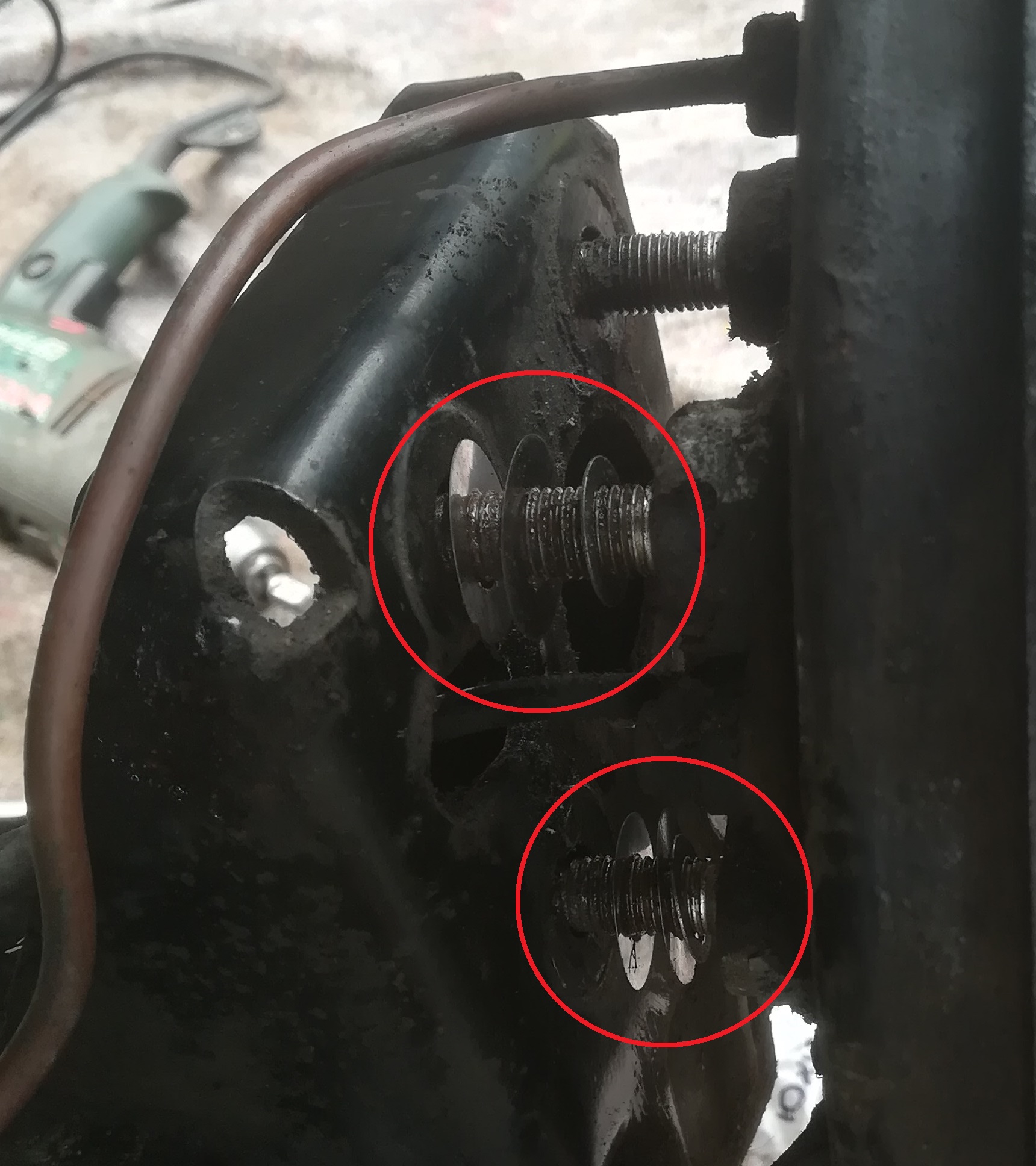

Hi @Ians Panda, I also fitted shims to my rear hubs to cure excessive tyre wear caused by too much toe-in.
I fitted a combination of 0.1mm & 0.5mm M10 shim washers from Screws City in Edinburgh.

More details on my thread here. I would advise to clean the threads of the hub bolts and soak in penetrating fluid, and take it easy backing the nuts off.
I'd guess you only need a thin shim on the front two hub bolts on each side as the toe-in doesn't seem excessive on your car. Maybe between 0.2mm & 0.5mm?

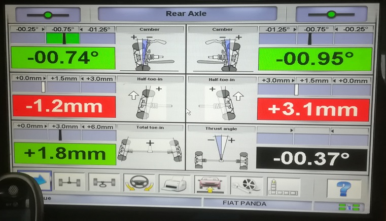

My 4-wheel (mis)alignment shows rear should be +1.5mm toe-in each side (0 to +3.0mm each side is within tolerance)

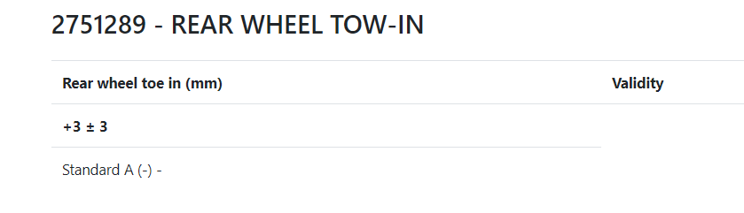

Strange fiat specify plus 3mm as standard and plus or minus 3mm but don't specify rim size
thats 0 to +6mm total and don't specify a max or min per side just total.
Are we talking toe change in mm or degrees? IIRC my tracking was laser measured in degrees of toe and camber angles.
After fitting new wishbones with new track rods (inner and outer) and tracking corrected on a laser system, mine was pulling left more than it did before the new parts went in. I tried setting more toe at the front which helped but it still pulled so I put it back as was.
The tracking was rechecked. Front and rear were all correct at 0 degrees. However, I suspect there is no measure across the car to confirm the axles are parallel and square to the car's centreline.
