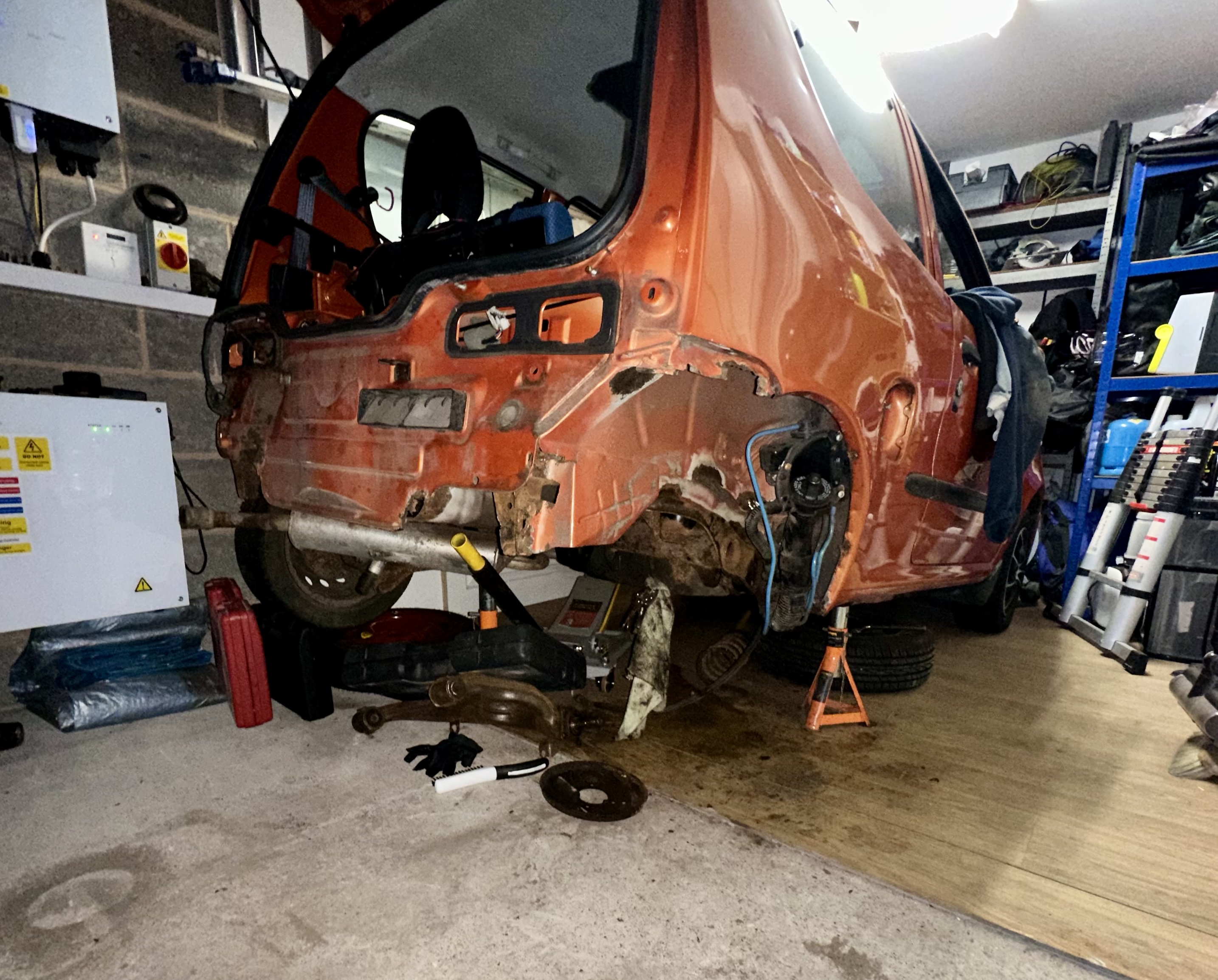

Thought I would update this post.
I got the old axle off after procastinating about it for a long time and getting a breaker bar.
I was so surprised that the bolts holding the axle on came off so easily (with the breaker bar). I was sure they were going to snap off on me, but nope, the threads were super clean! It was just the heads that were rusty. So after chipping rust off the bolt heads and getting the correct size 6 flat socket, bob was indeed my uncle.
I now have a replacement axle and arms to go on. They need some work before they go on right enough. I also need to get a couple of new bolts. In fact I'd love a fresh set of bolts for the axle and the rest of the rear suspension mounting as some are not coming off from my old parts (shock bolts).
Hopefully after cleaning up the mating surfaces and painting them. I can get the rear end back together, new brake lines and handbrake cables. Then I can take the damn thing to the body shop for some rust removal/replacement metal and some paint.

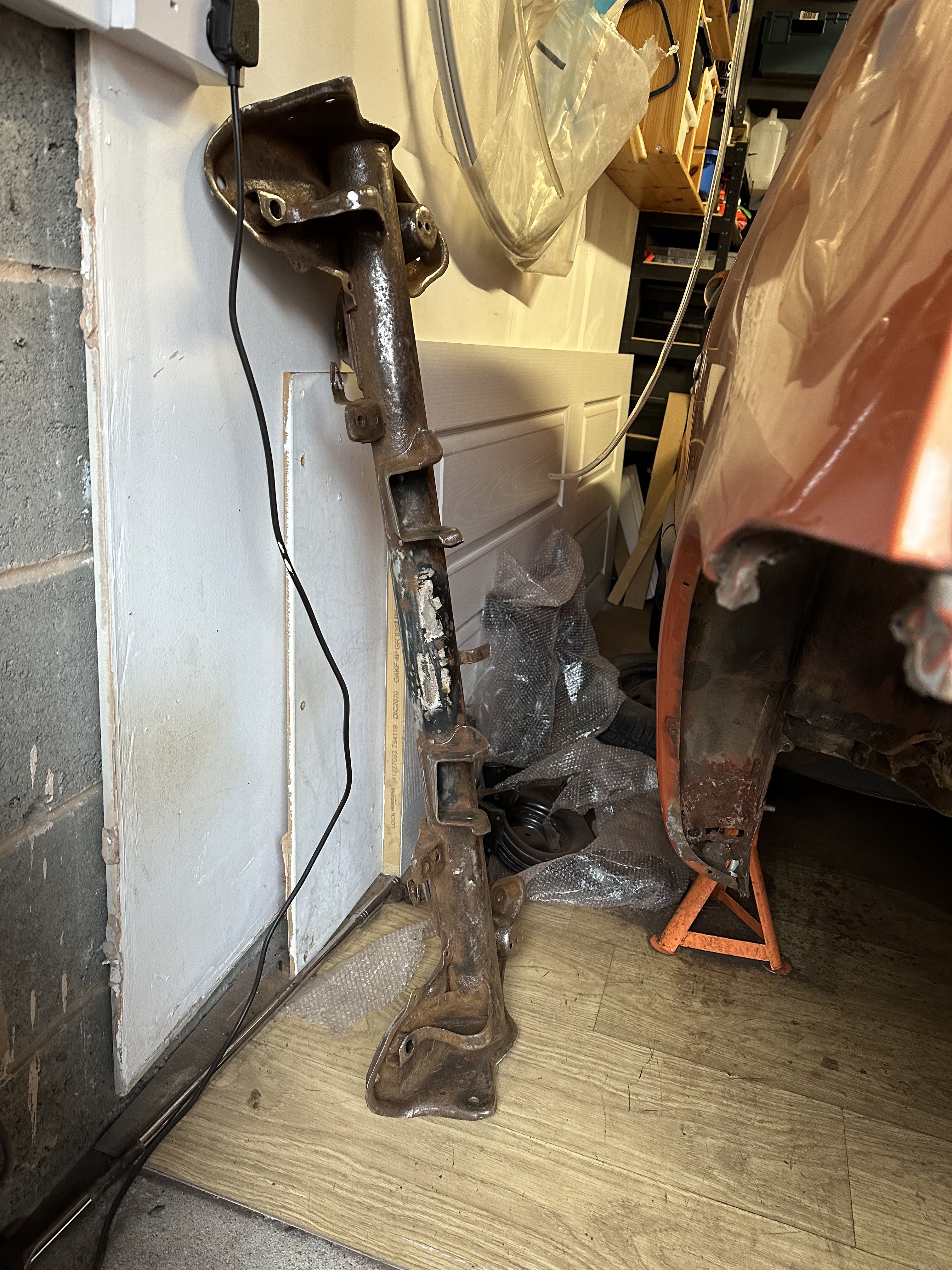

I’ve been at my daughters seicento for a while now the whole back end is now off beam too , clean up the beam and fuel tank of rust waxoyl’d it , clean underbody and waxoyl’d that too .plated up some small holes and bits . its. now ready to go back together with all new bits ! shocks ,coil springs ,trailing arms ,brakes and drums ,wheel bearings,brake backing plates plus brake pipes and handbrake cable .picture is of half way through dismantling it all .

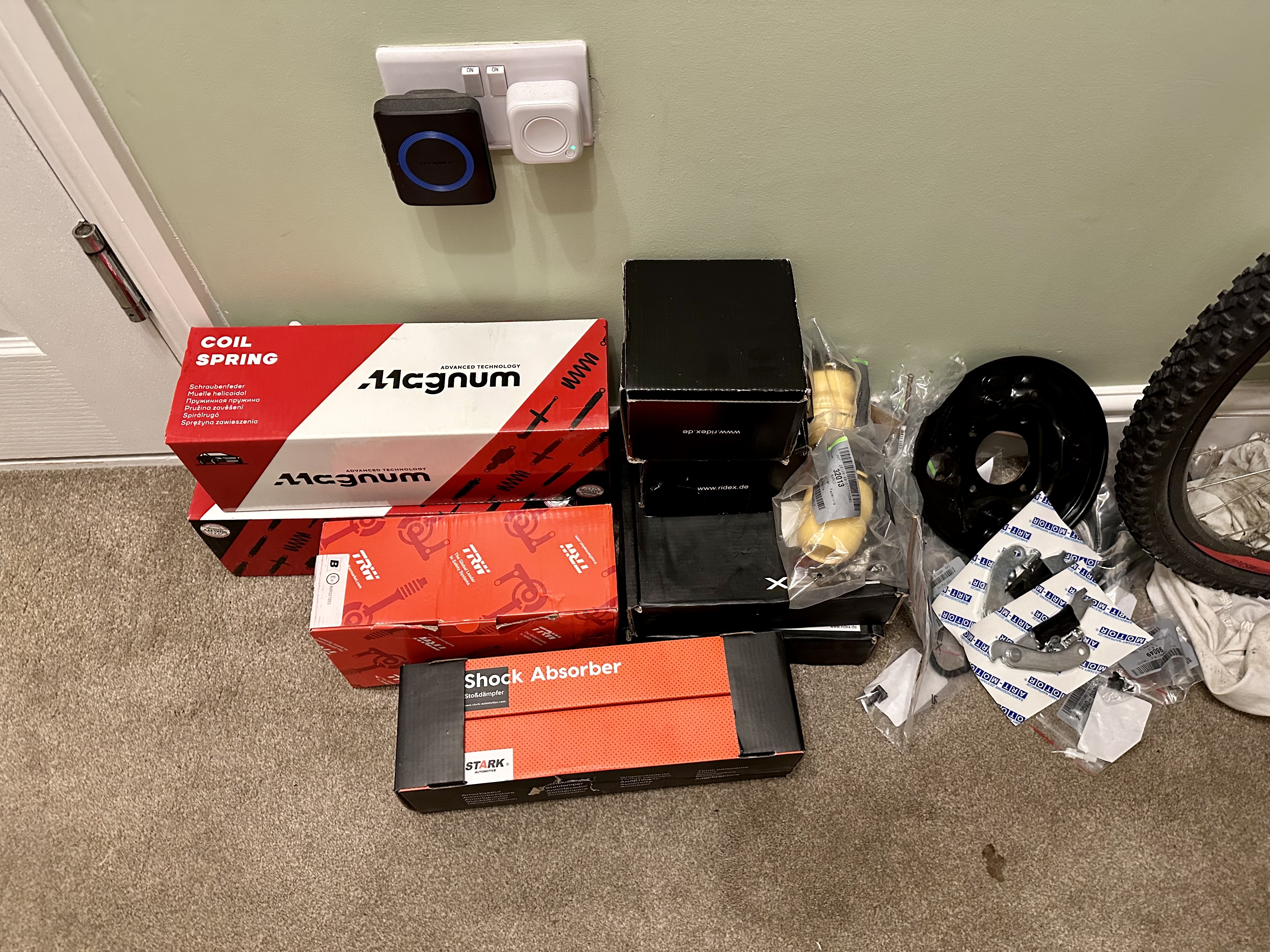

Slowly getting their , welding due to be done in the neat few weeks . the parts are 99% all here from all over europe lol . Rear axle is ready to go , all cleaned up and resprayed with zinc based primer and wax oyle top coat . Once on the whole of underbody will have Coat of Lanoguard protection. I will be building the new brake drums and making brake pipes tomorrow.
