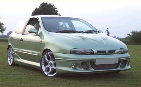

Is that your old Bravo mate? It is sweet, probably the sweetest one I've seen IMO, not OTT, just with enough subtle differences to make it look a bit special, lovely :D
Keep the wheels for your Stilo?

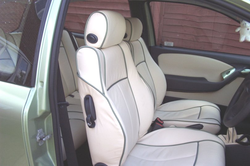

sorry to be so off topic again but cant resist:
Stilo due back sat! Lets hope its sorted and will be happy again!
