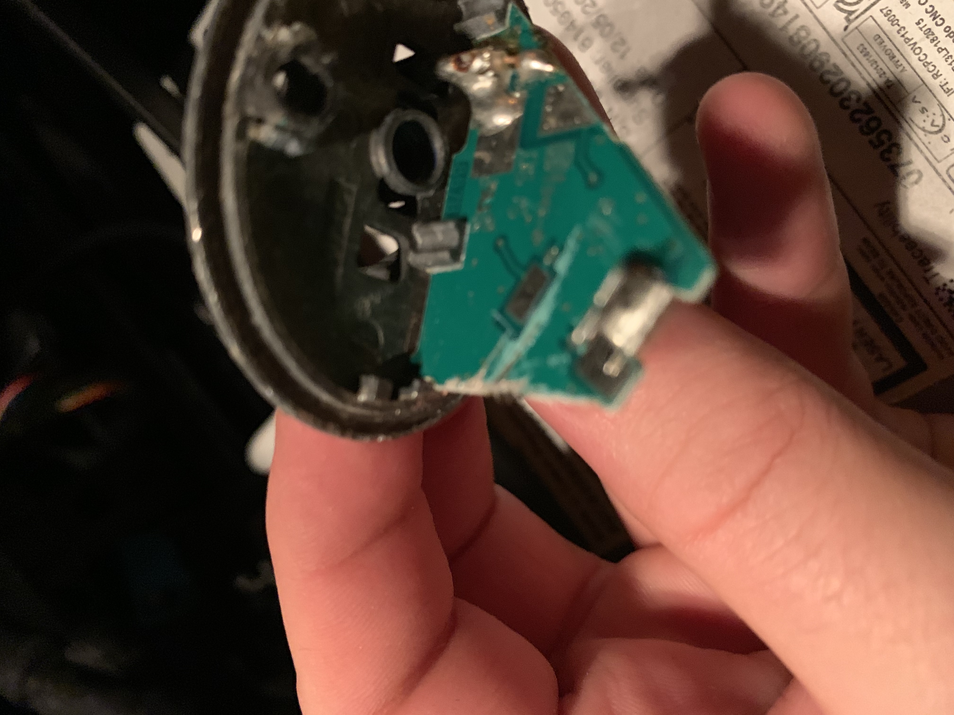

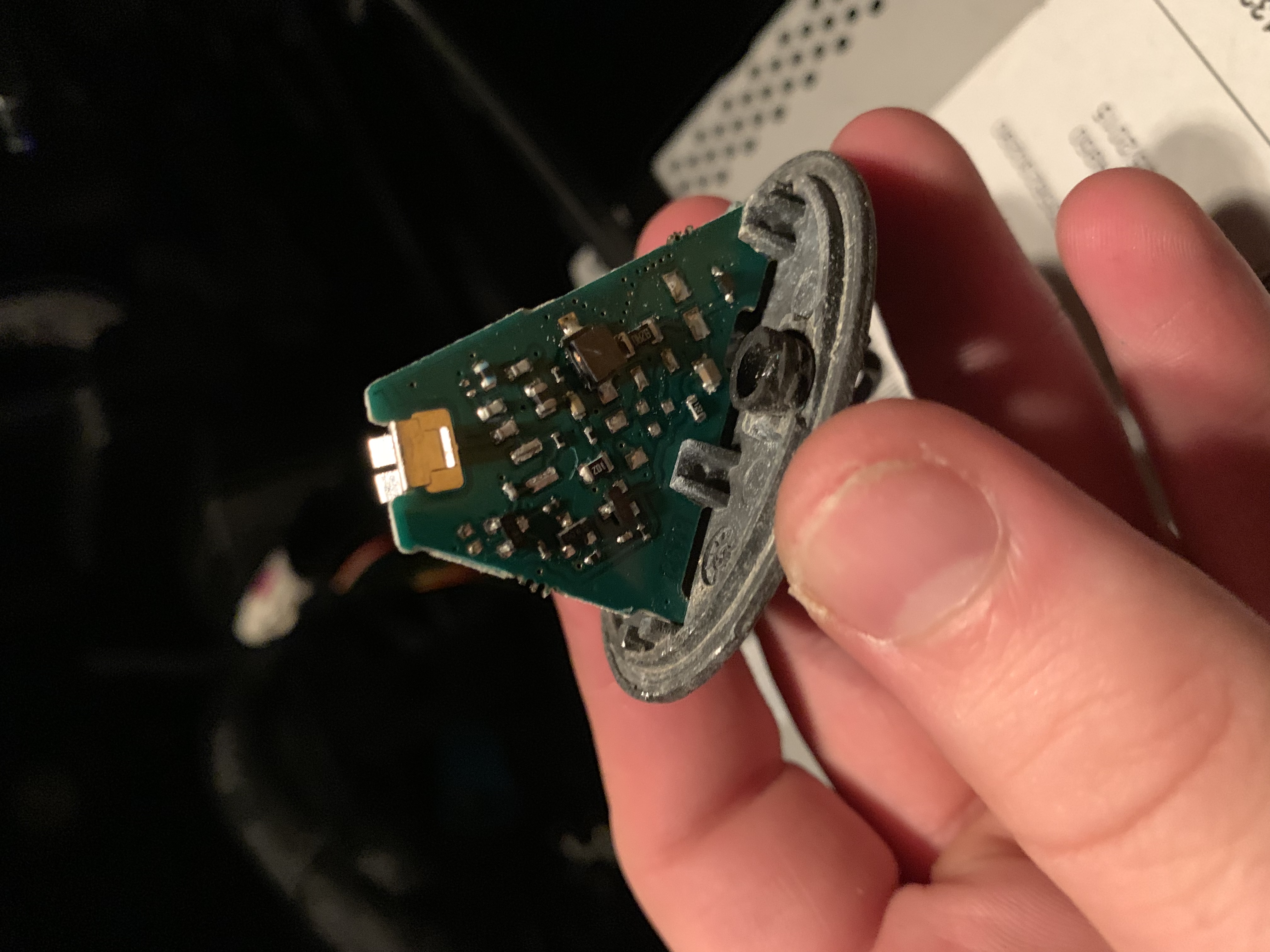

I took the original 500L antenna off and inspected it.
I believe there is a booster installed in the antenna on the roof itself. There is a chipset inside per images:
I tried putting the original antenna right into the car radio unit and the service was just as bad.

Final update, as I like to keep things OEM I had ordered a fiat genuine base roof mount and aerial, but it was coming in from Poland. Fiat 500 Part 50540987. Signal is brilliant, even better than the aerial above, so the original unit must have been faulty. On observation the original unit had a booster in the base roof mount, and this was slightly damp / wet which I am sure was causing troubles.
Validated with fiat, the radio headunit sends a signal to the aerial amplifier via the standard aerial cable.
