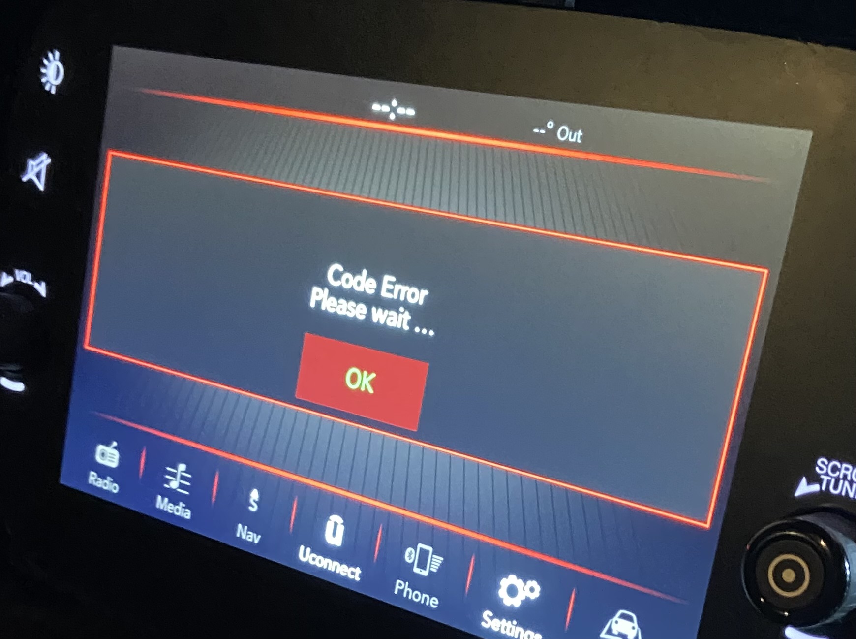

I have purchased a new radio. It keeps showing code error and will not let me enter the code. I disconnected the power but no joy. Any other suggestions? Thanks
Hi it’s a second hand from a fiat 500 into a fiat 500 as pictured. There is power getting to it but this is what it’s displaying and won’t let me click ok so I can’t even attempt to put in the code. This is how it’s been since installation
Far to fancy for the pre 2012 panda section
I assume there is a clash between the code stored on the radio and the body computer and it's licking it out, pure guess
But people on the 500 section should be able to help you more
