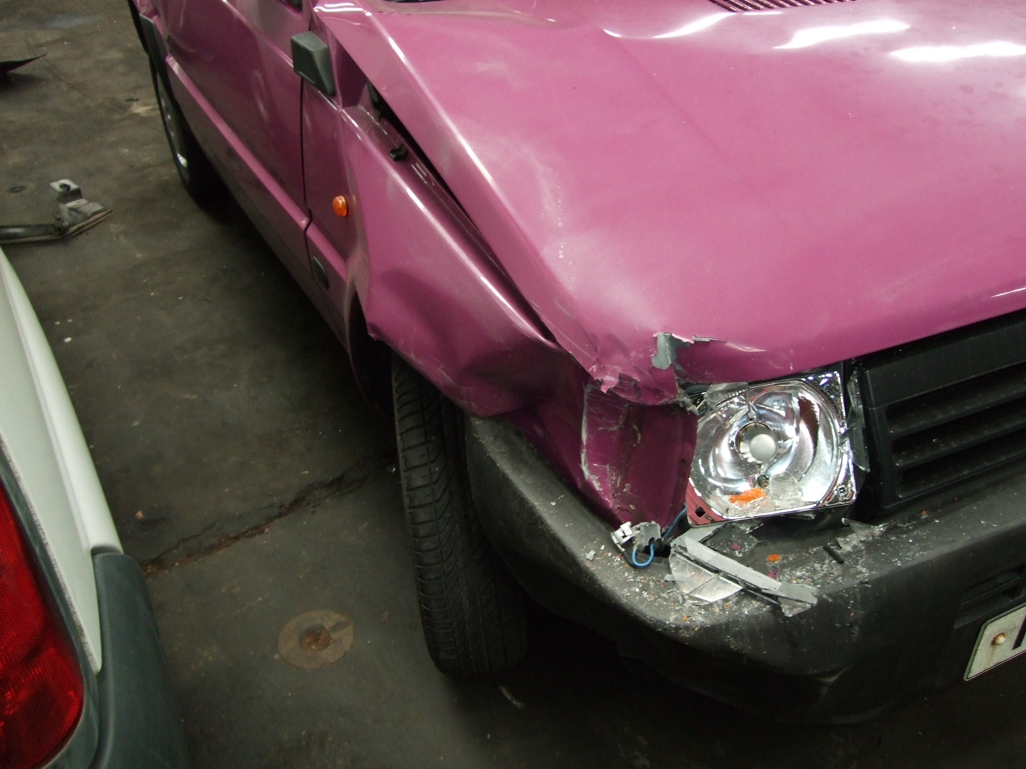

Totally devastated. I've been away this week and got a message from the other half with the bad news. The Panda was found just around the corner from our house crashed into a silver Fiesta. In truth it's probably a write off because of the amount of repair work that will be needed but we're not quite ready to admit defeat just yet. The O/S front is caved in. New headlight, bonnet, windscreen, wing and the intererior front panel is badly pushed in. Ignition ripped out as well of course. Worst of all it looks as if the front shell has twisted because the N/S wing has also moved and the O/S door won't shut properly. I think we're looking at somewhere between 1,000 - 2,000. It's at a salvage place now and I've been and taken all of our stuff out of it and took a few (poor) pics. Going to mull it over this weekkend and maybe try to get someone to look at it early next week. I fear the worst though. :cry::cry:
The pics don't look that bad and I was expecting worse. The dmage has not got as far as the engine. Trouble is when it all adds up it may not be worth it. Any thoughts/advice would be appreciated.

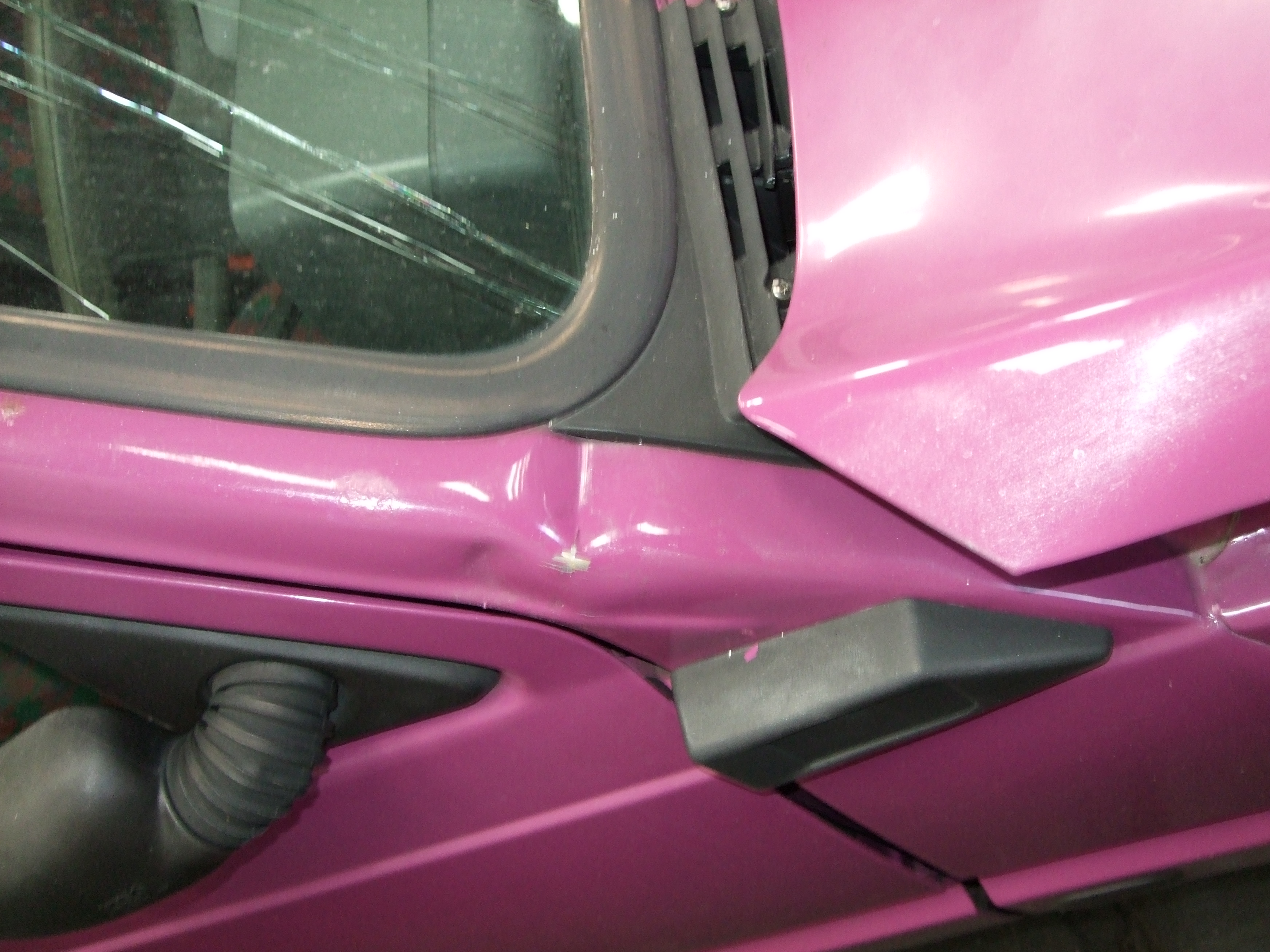

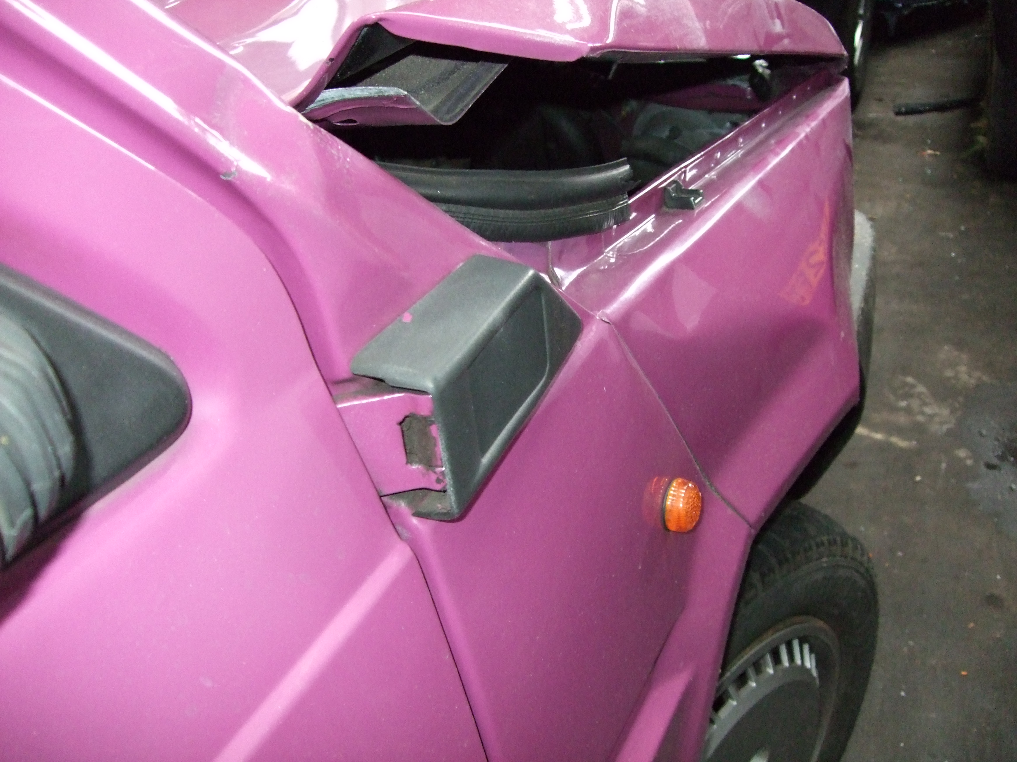

sorry. some photos but they won't tell much. I couldn't manage to get the bonnet open.
On initial thought it doesn't look that much, I'm not happy with the bend in the A piller and not sure if it would protect you in the future if that was repaired? If you are advised that it could be safely repaired I have a brand new front panel and front wing you could have, I could even let you have willies old bonnet with all the advertising on it (there is a slight dent in it but would do you till you find another) So you would just need a new light and the inner wing repaired and possibly pulled. I even have a front grille if that is damaged/cracked at the side.
You'll probably find that when the front wing is removed it will relax the other parts so the door will be OK. I don't think the damage is bad enough to have twisted the chassis but would just check obviously to make sure.

Sorry to be a bearer of bad news but surely that's a right off... bent A pillar and inner wing, plus price of parts + spraying (decent paint jobs don't come cheap) will send the price well over £2000 IMO.

Re the A pillar as mentioned by rockbottom that is really the crunch matter, if bodywork says no go I just wouldn't take the chance.

My personal opinion is that the little f**kers are found and dealt with but not immediately by the police if you catch my drift;) whether that a pillar been done by the bonnet as im inclined to agree with or through shock through the inner wing, its a possible diy repair if your any good with a welder and measurements. Dad patched our last 4x4 up when the pillar rotted due to a radio aerial being badly mounted in it, he did this by cutting a section of the pillar from a donor panda and using it to replace the affected section on our panda.
Good point never thought of that till I looked again and saw the hight the rear of the bonnet is sitting. I've now looked long an hard at those pics. The side panel is not affected at all below the pillar but is being pressured by the fold in the wing which will affect the door. The angle of the shunt possibly hasn't affected the inner wing by much if at all and may not need pulling. The bonnet won't open due to the side pressure on the latch so get someone to pull the bonnet lever whilst pulling the bonnet up it'll probably give.

I think you are right about the A pillar. It was my impression that the dent was caused by the impact of the bonnet.
