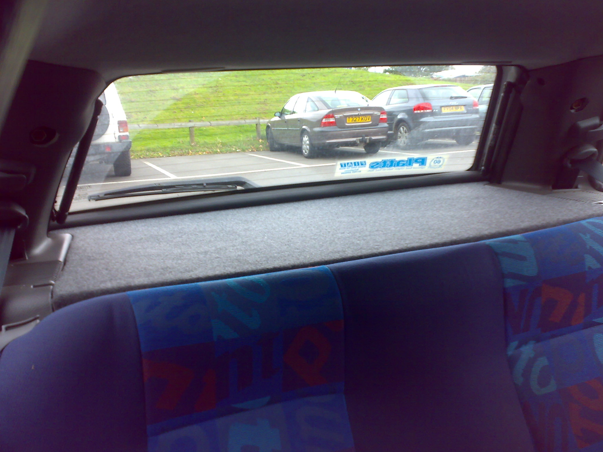

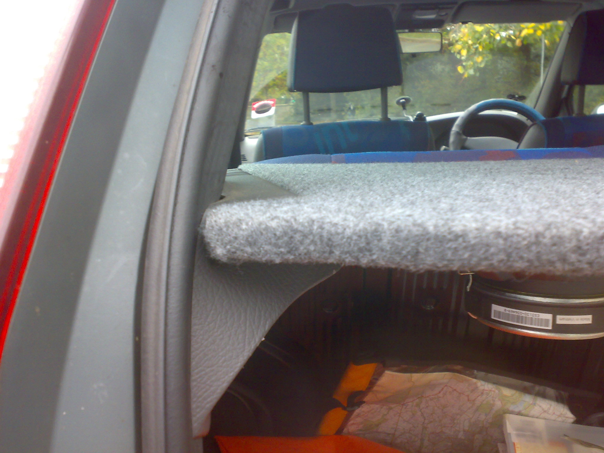

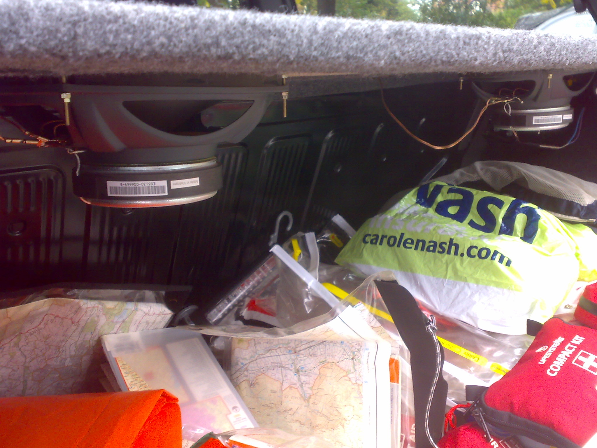

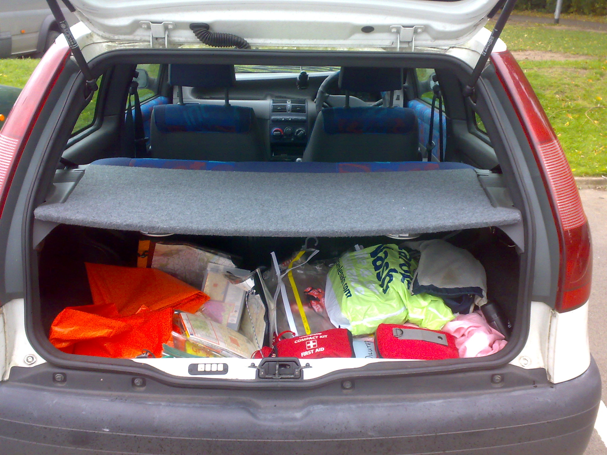

I used 12mm thick MDF (the shelf is 16mm deep so with carpet it is a near perfect fit).
A aren't certain on the other dimensions as I dont have a tape measure to hand, spent some time getting M8 bolts sunk into a chunk of mdf to use as the pivots (I think they were M8 sized anyway, worth checking if you have some bolts about)
what does it look like? a little ugly, but it does the job? or not too shabby? cus of the change in levels on the original shelf.
Sorry to ask so many questions, its just i havnt seen a proper shelf with 6x9s, only my mates, and his shakes badly cus its the original shelf. I appreciate the info (y)
It's too dark to get any decent photo's mate (without charging the flash lamp anyway)
I'l get a picture or so up tomorrow afternoon when I get back from my little outing, I think I've made a nice job of all but the underside (don't see it much tbh) and I havent put any lift strings on yet!
The fabric I used was the thickest speaker cloth I could get off Maplins and it's about 2mm thick so it's an almost perfect fit (the MDF edges all have curves and everything underneath) and the only downside is the bit between the seat and the parcel shelf has a small gap to allow it to move; still havent decided how to go about that bit.

By the way, the shelf was made to the same size as the stencil then planed down to fit with the fabric placed on one side and doubled over to (you can't put it back on after all) so that it made a good fit, the edges were then carefully filed to give a gentle curve. The rear curve to the seats was made too long and then cut down for a similar reason to allow the shelf to pivot, I can measure the gap tonight, and if I aren't too tired I'l take the shelf out and take some pictures of the pivot beam (also add's some strength).
The 6x9 leads have 3.5mm socket to plug adapters so I can swap from those back to the smaller mounts when I can't use the parcel shelf and from maplins that cost about £5 for 4 plugs and 2 sockets.
