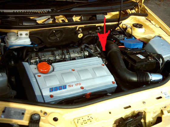

Hi, the gear linkages you want are in the engine bay since the ones under the gear stick cover can only be access from under the car (unless somebody out there is a scuffed knuckle saver and knows of a way to do it) and the exhaust is in the way.
If you look in the engine bay down below the air intake hose and the passenger bulkhead you'll see two cables with rubber bellows fitted onto some levers this is the gear linkage part you need to lubricate, so any bit that moves just squirt some oil on it (I use lithium grease, others use WD40 or PTFE based oil)

PPS just added a picture of your engine bay (nice cam cover detailing) to show where to look down to find the gear linkages etc.
https://www.fiatforum.com/attachment.php?attachmentid=12952&stc=1&d=1143750158
