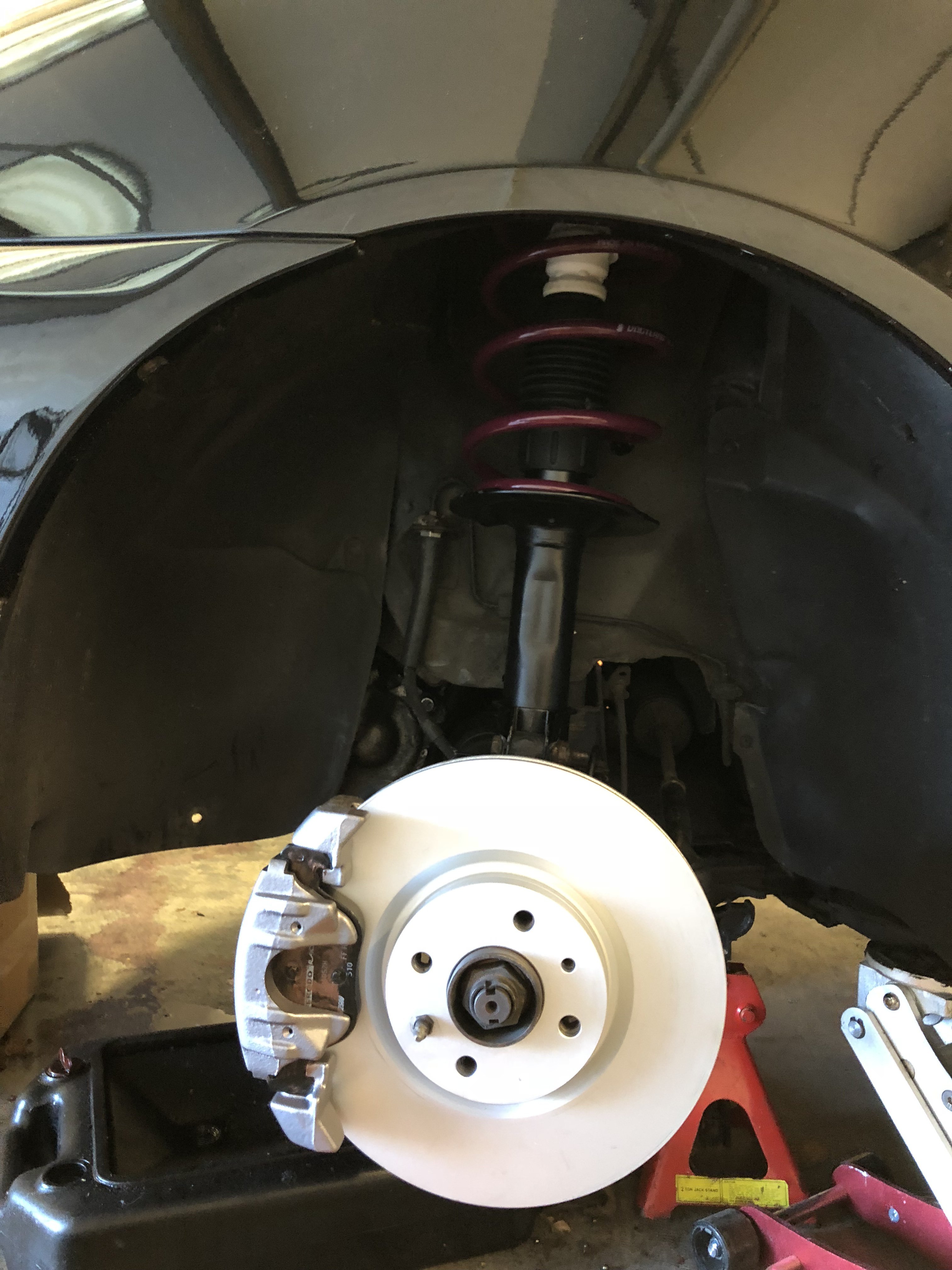

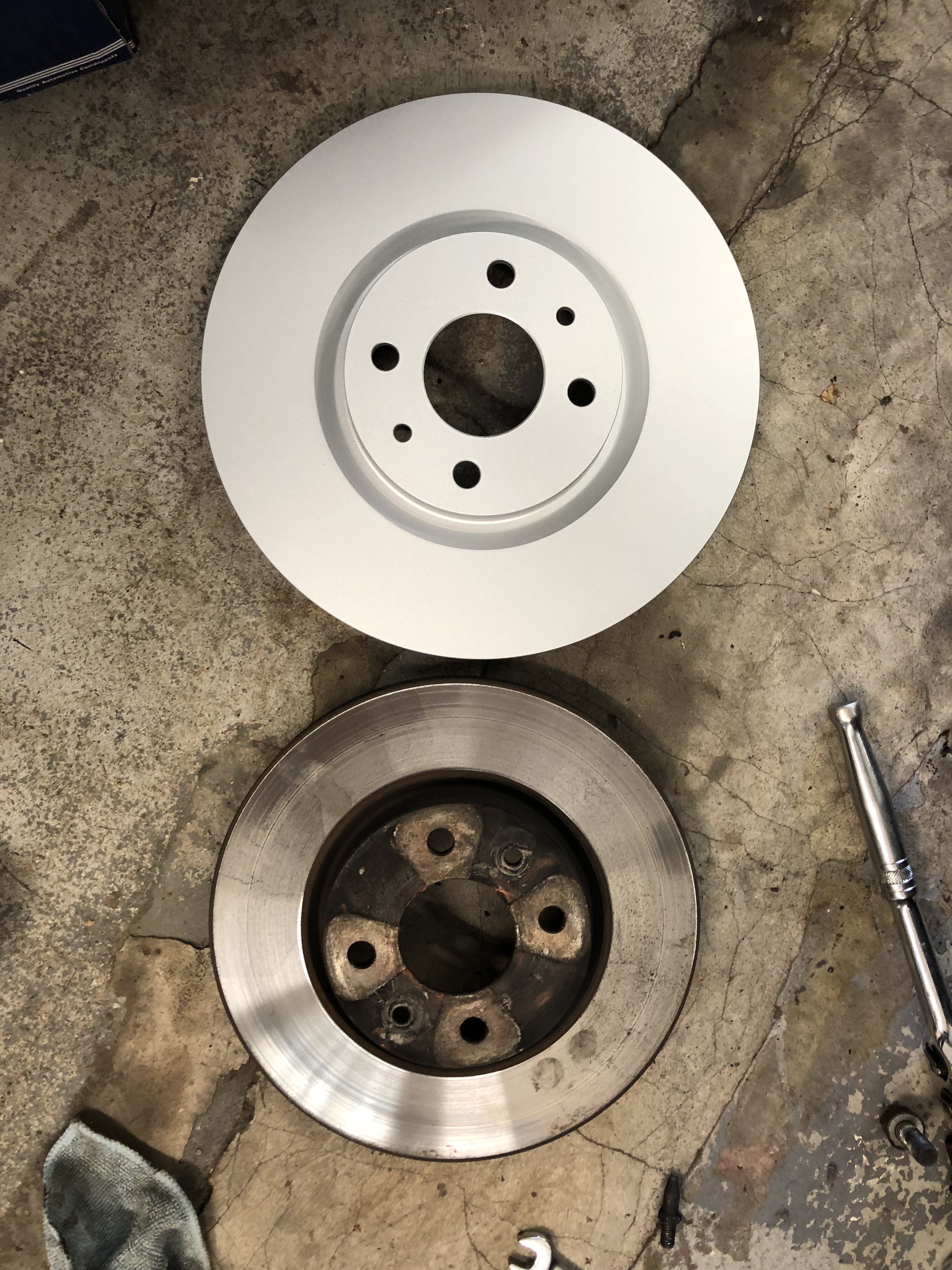

Later HGT's had bigger brakes fitted at the front (257mm to 284mm discs). They bolt straight on with the bigger calipers.

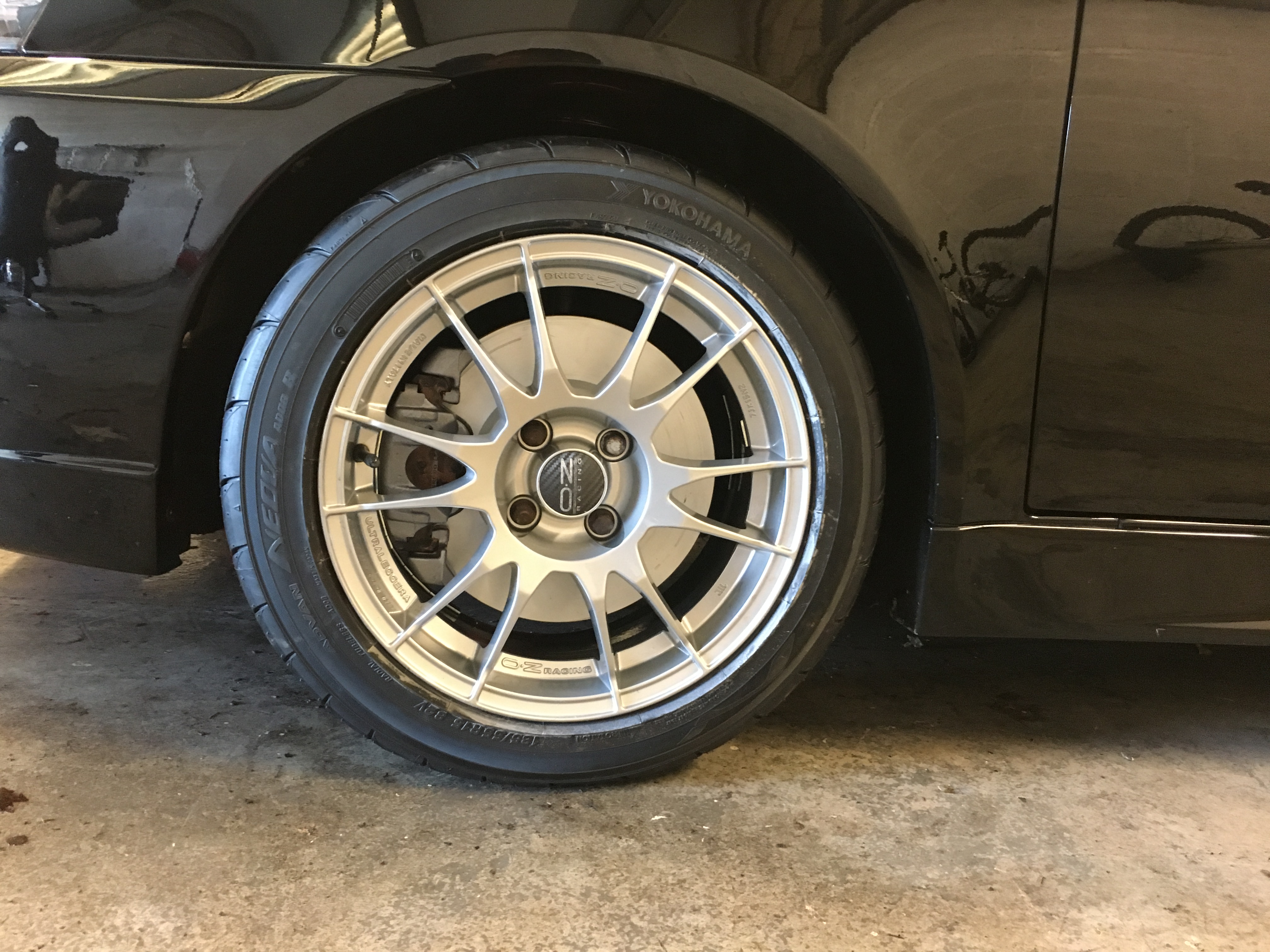

I have the larger 284mm discs and larger calipers on my hgt off the facelift 03-05 hgt with ferodo ds2500 pads and uprated fluid, they are a staight easy fit and an excellant upgrade
