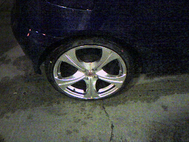

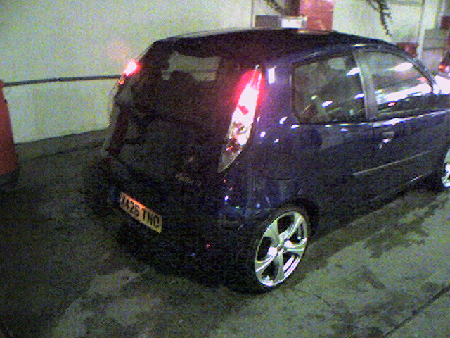

the seller sent me 'special' bolts coz he said something about the 98 or 100 etc, they r 17's n im tryin to upload a pic but bein unsuccessful.

ah did he give you spigot rings? it is of up most importance that the center bore is correct when using wobbly bolts
OP
OP
phazer_punto
phazer_punto
Member
Mar 16, 2006
83
21
romford essex
Re: pulin to the left (not tracking)
yeh, the metal rings dat push into the wheel, so the alloy sits tighter? i dint fit them at first coz dint c them, then wen travellin down the a13 me car shuck like a old reg escort doin 80 in a field. took the wheels off, added them rings and the shaking went, still pulls to the left especially when breaking though.
