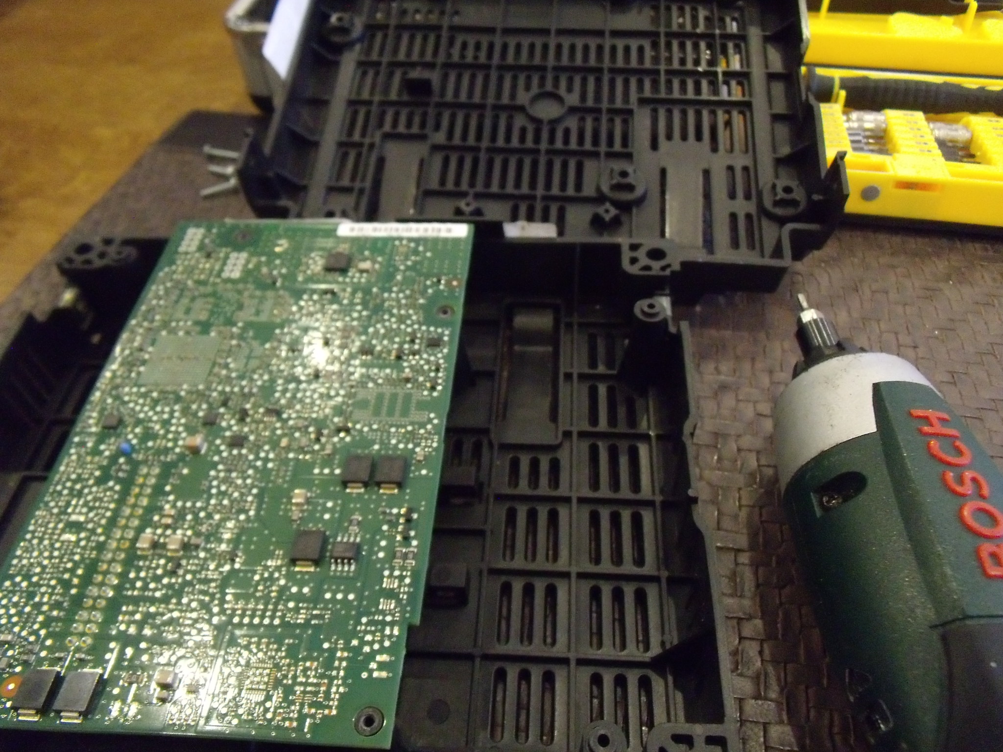

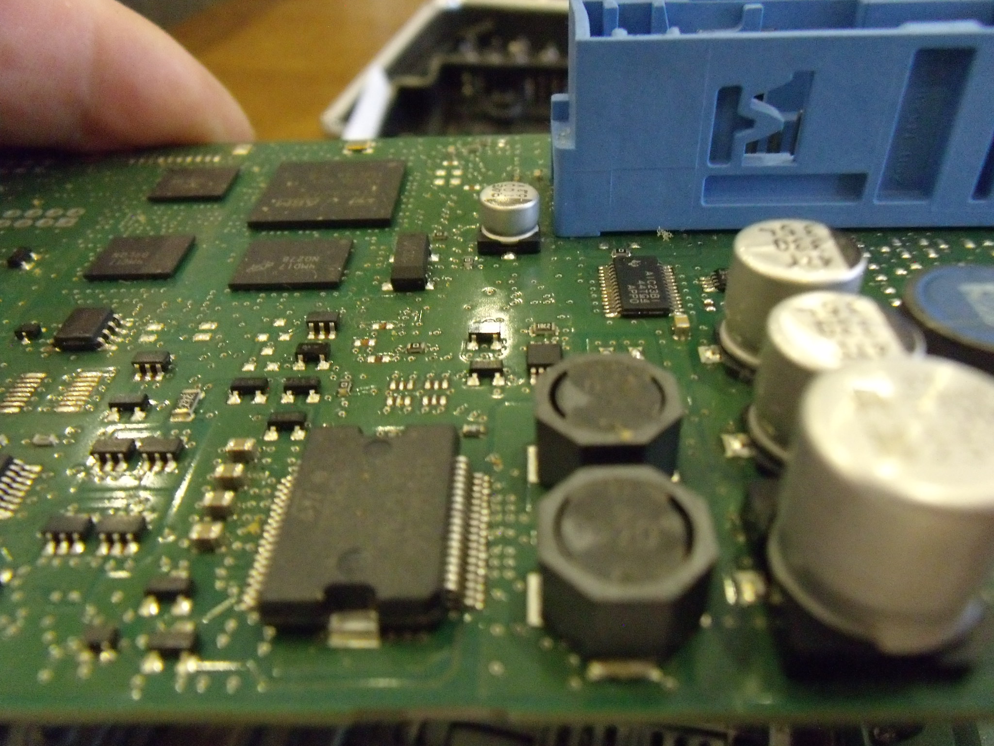

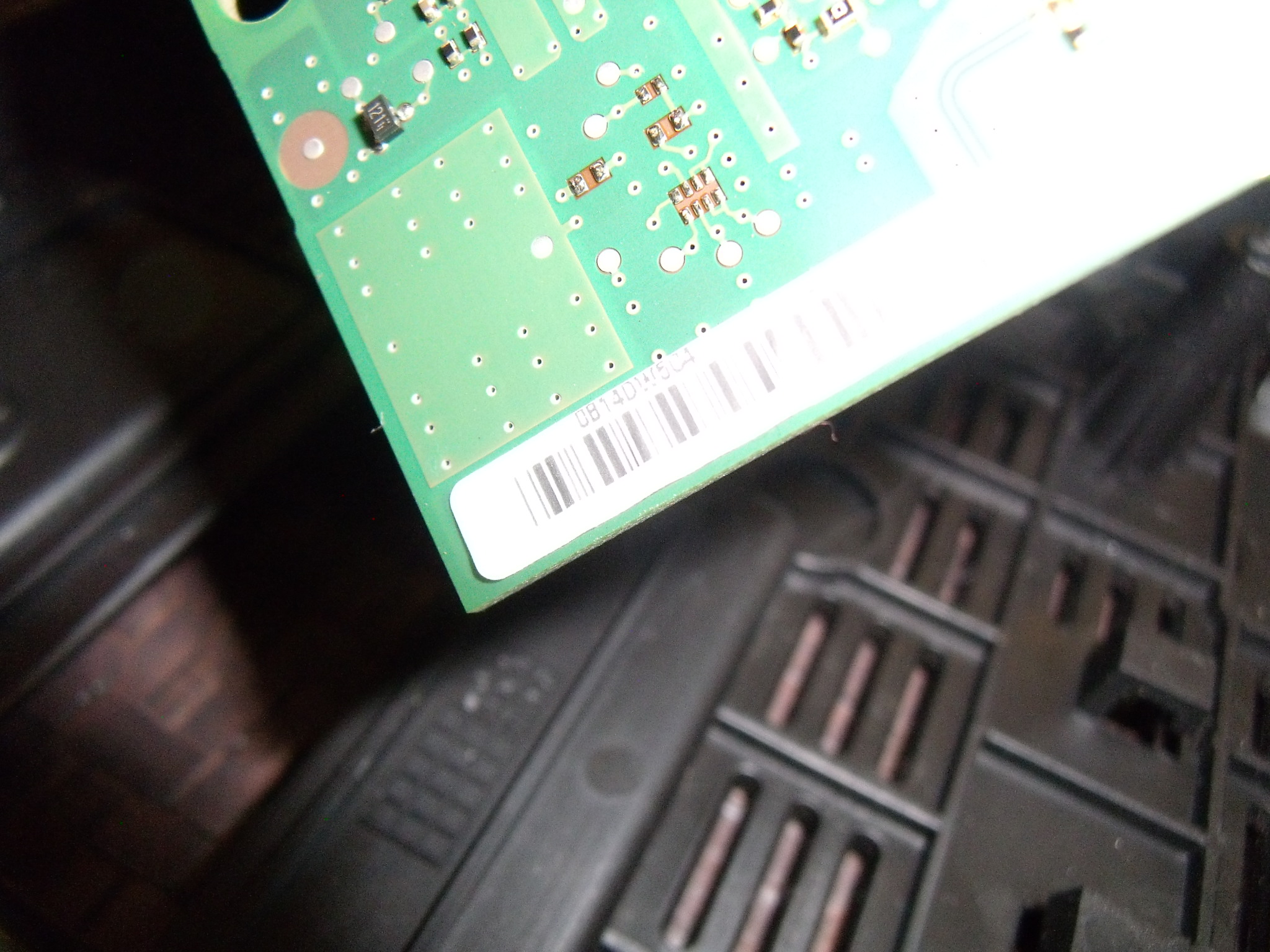

Hi,
Received your 'original' BM module this morning......I put in quotes ORIGINAL as it cannot be the original if your car is a 2013 model as the module was not produced until 2014 according to the dates on the labels.......
So quick question.........has this module ever worked for you in the car or have you purchased the car knowing it had a faulty problem with the Blueandme...........the reasons I ask is clearly the module has previously been opened as the labels have been pulled away to split the casing......
Then when you look at the circuit board it is not exactly the same code as that on the casing and is an earlier number but still carries the later gen2 code..... this label has not been tampered with so I would assume is the original.......
Obviously all this is acceptable if previous problems have occured and modules shipped off for repair it would be quite logical to just install a complete circuit board as very few have the ability or equipment to change the tiny microchips which is definitely a specialist to even identify a faulty microchip and doubtful such a repair economical........
We have checked the pin alignment and all is good non bent damaged or oxydised. The circuit board also shows no sign of dampness which we have found on 500's where they are mounted in the rear wheelarch..
So the module I suspect at some point has been previously looked at inside and tested with no opportunity of a repair due to an electronic failure...........
The unknown is have you also been sold another faulty unit........it needs someone who has a 500 and the MES gear to proxy it and try....that said a 500 module is a pain to access and remove......
USB Port does not appear to be working. Have plugged in Smart phone and connected to this port and does not show charging. Cigarette lighter IS working - so that may rule out a fuse issue, if same for both....Any ideas????

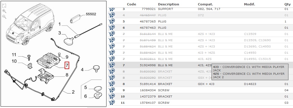

@UpfrontWAV Thanks for the VIN. I'll send a pic of the data by message. Car was built 02/10/2012
From ePER, they list the Blu&Me module as 51924998 Described as Convergence C1, if that is helpful.
It appears that if ordered (over £350), it is likely to be replaced with a 51989250, which also replaces 51943247.
Yours is also listed for 500, Ducato, and Grande Punto. '3247 is listed for 500, Grande Punto, Bravo, Panda 2012-, and some Lancia models. So it seems as @Farrah has said, the virgin module fits lots, but is configured for specific vehicles.
Hopefully this helps. If your 'original' is the correct part number, it may work if 'repaired'. Alternatively, the real original is needed, if possible, or one from a similar Qubo. There must be a few Qubos been scrapped by now, but maybe no-one is thinking of rescuing the B&M modules.
