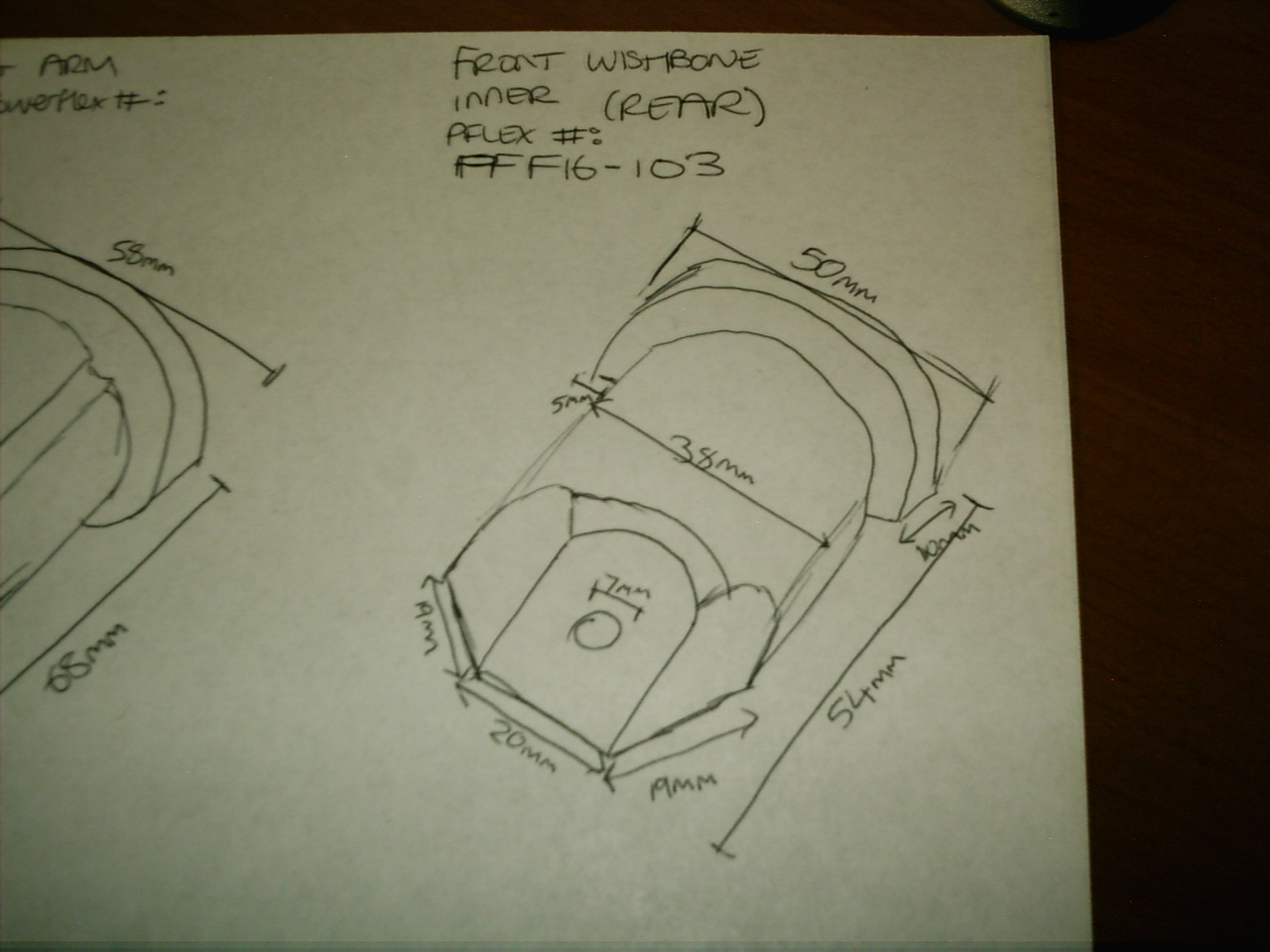

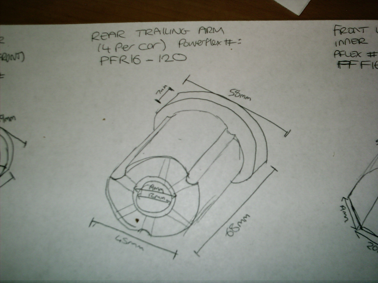

Bit of a strange request but if anyone is about to fit powerflex bushes on there car could they get dimensions of the components. Or if anyone knows the sizes could they post them?
As it so happens im fitting some eventually, and have drawn out rough diagrams with measurements. They are only measured with a ruler, so may be slightly out though.

exactly what im looking for cheers. This material is about £10 a metre to buy and the centre piece is easy enough to make too. Going to make me some in the machine shop i work in.

you can get any shore rating you want from suppliers. The ones you buy are injection moulded i would think id need to turn mine. Also looking at the pick posted there are grooves on side of barrel just relief i think. Going to do a bit of trial and error to see how they feel but certainly if they work ill run a batch on nightshift the CNC will spit them out. The centre pieces may be hardened but could probably buy it in in that diameter of tube and cut them off in the grinder.

Badger i would need some sizes but im going to do a lot of stuff for my own car and if everything is ok certainly can produce some. Im needing some bushes for my 899sx and i just thought i go for the powerflex ones but to be honest its not that im tight but i just cant see 15 quids worth of product in a single bush. I mean from my point of view i really could turn one of these easy and in the powerflex website it says its a special compound but ive used the same material to make bushes that go in helicopters so its freely available. Im quite sure there are even better compounds available too.

the bushes are stepped on one end as per diagram above
the material is called Autothane
Metal tube is parallel, no flanges.
Bushes are not a loose fit in the arm, they need greasing and pushing in quite firmly by hand.
