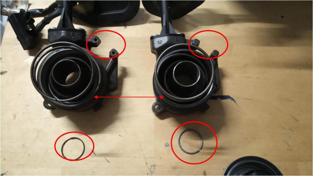

Hello,
In the future I plan on doing the clutch on my abarth, I have a new flywheel took from ebay at 235€ but as some know, the slave cylinder is not buyable anymore.
The valeo 810000 ... but if you take a look, the 810001 is very close (it is the one from the manual version or the diesel JTD 1.9)
I got one for 40€ new on ebay recently, and with the used one I bought here, I decided to dismount them to compare both and ....
You can build a new one !
I took a few picture, the first clip hold everything in place, it is a little bigger in the recent one, but it doesn't matter.
I took the head from the old one, and noticed that the magnet ? platic mount is a clip and can be dismounted, I did the same with the new one and exchanged the sensor part.
The rubber dust protection is different, then I mounted the new bearing head with all the sealing in the old mount and voilà !
Bearing + tightness inside is new
I'm waiting the longest possible to change the clutch, so I will not be able to confirm this until then, but for the cost, if you have no other option, you should try.
