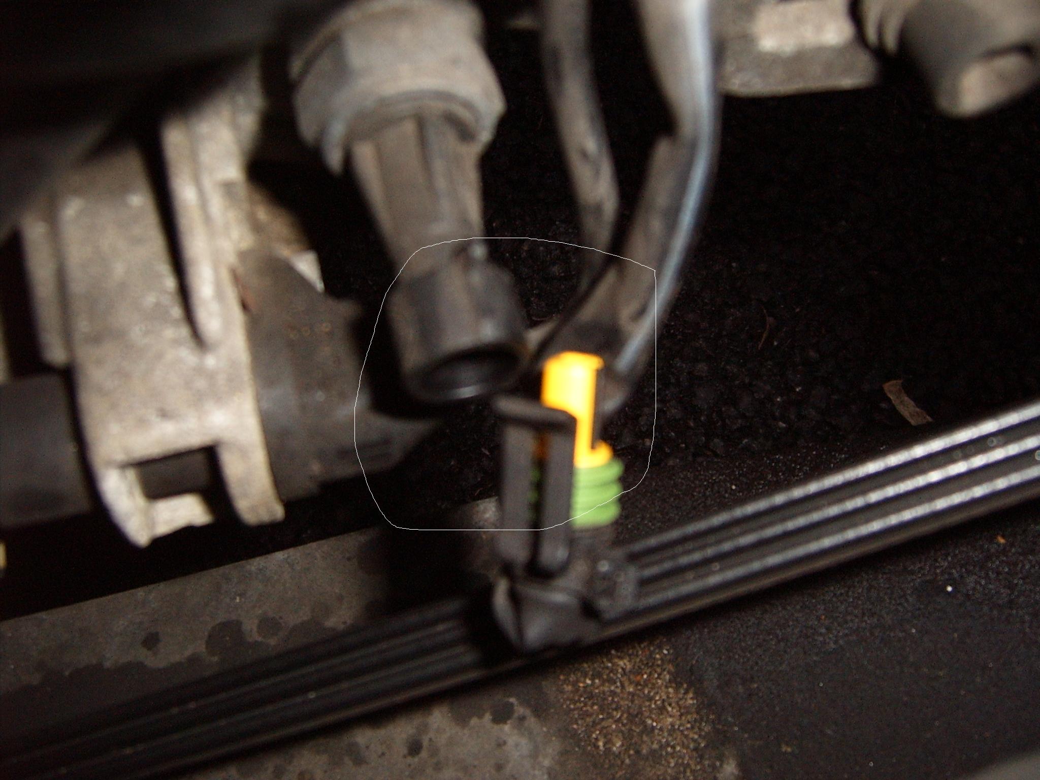

All those problems disappeared after I touched few wires..(Mainly the Crankshaft sensor and another sensor attached to the crank body (photo)near to it (I have no Idea what it is and my Haynes says nothing about it but I am suspecting it could be the oil pressure sensor..)

Now my question is … what could I have done that could have effected the alternator, Engine misfiring, temperature gauge …and the rest of the problems???
Could it be that when I disconnected the battery the ECU reset itself to a good setting ??? but how could the ECU control the output of the Alternator ? Or could it???:bang:

i'd say its time you got a diagnostic done, usually costs about £30 but at least you'll know what the problem is, you seem to have one of those electrical faults that can take years to find by messing around with wires, and you may break something else while you're tinkering. if it worked fine for a 3 hour drive you can be confident that nothing mechanical is broken or faulty, its most likely a dodgy sensor, loose wire, bad earth, etc...
as for the alternator issue, if your battery still starts the car you can assume the alternator is charging it ok, because it would be flat by now if it wasn't getting any charge at all. how did you test the alternator exactly?

sorry didnt realise this was a continuation of the other post, from that post i assume you're using the old bulb method instead of a multimeter, that doesn't help, but if you have been suffering a quickly dying battery and you are sure the battery is good, then its possible the alternator is at fault, but it could just as easily be a dodgy connection on a wire either at the alternator, or earth on chassis, or battery connections, the number of times i've seen people change their alternator when all they had was a rusty connection on the earth strap makes me laugh, but its hard to say without a multimeter reading. its important to get an accurate reading of the alternator output in volts, the resistance from the battery negative terminal to the alternator negative post in ohms, and the normal drain from battery in amps. its cheaper to do a correct diagnosis the first time rather than buying bits willy nilly hoping to get lucky, a multimeter is about 7.99 in wilkinsons, well worth it
jug
blessed are the apostates
Nov 28, 2005
27,935
3,762
Durham
ecu has nothing to do with alternator, so resetting the ecu could not affect alternator performance, so disconnecting your battery should have no affect if the alternator is at fault,

Problem solved :) :) ... At last... You were absolutely right the alternator was fine and you mentioned an earthing problem and again you were spot on !!
This afternoon I decided too look for those earth spots and Bingo !! I found the earth strap that connects the clutch/transmission housing to the car's body and to my surprise it was sitting under the ctutch slave cylinder which incidently was leaking so it was extremely corroded, so I removed it, cleaned it and placed it away from that spot.
when I restarted the car I could tell everything was good, the starter motor was fast, the car sounded better and all the gauges/warning lights were functioning perfectly.
I took it for a drive and there was no problems at all :)
I think I will now have to change that clutch slave cylinder and put in a new earth strap .. maybe even 2 .. just to make sure :)
