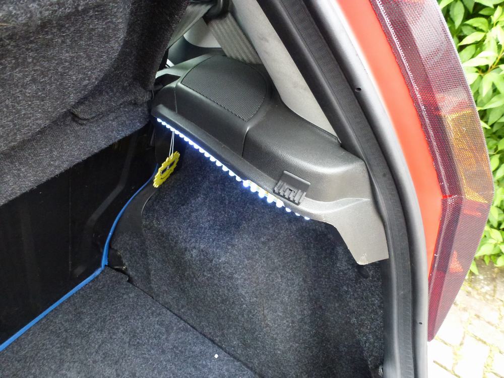

UPDATE: New boot light LEDs and Flyeye tints
The new boot lights were more for convenience than anything else - if I'm getting something out of the boot quite late/very early in the day, the single bulb in there just isn't enough to light it properly. 48 white LEDs ought to do the trick :slayer:. They don't look too impressive in the photos below as they're taken in broad daylight - I'll put up one taken at night when it gets dark enough out.

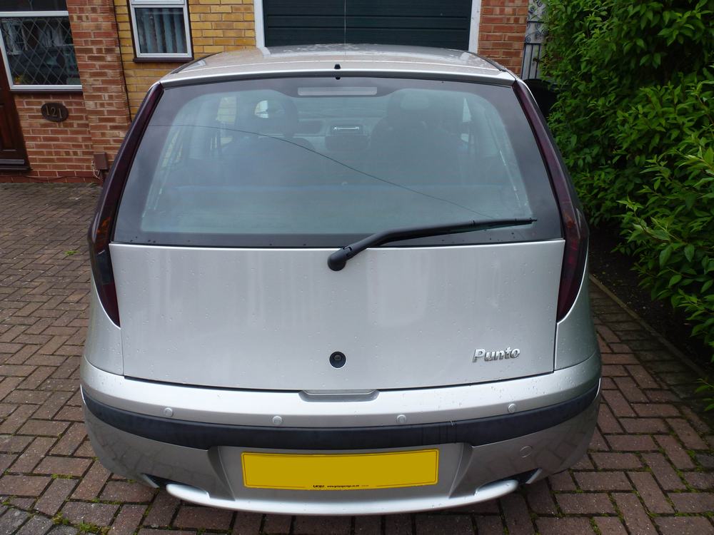

The Flyeye tints could be slightly neater, but they look damn good if you're not up too close :D
UPDATE: New boot lights, in the dark
A little info for anyone interested: these are just 2 of the LED strips sold for cars (I got 2 on eBay for less than £3, just search "12v LED strip"), stuck under the speaker covers with some double sided foam pads and wired directly into the 12V that used to power the single bulb in there.

Fiatpuntomk2b is right - they go into the wiring from the old boot light, so they only come on when the boot is open. Took all of 5 minutes to install and cheap as well (less than £3!) so well worth doing!

Mine are very bright - the photo doesn't really do it justice; they light up the whole boot to near-daylight.

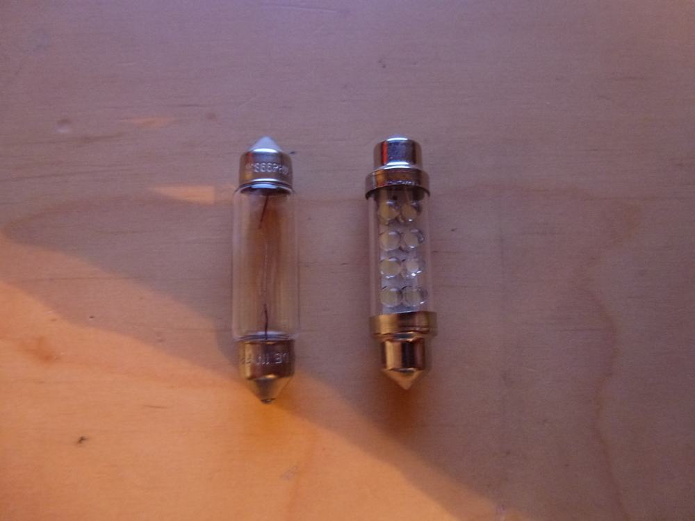

Back at home now and the new interior bulb and second set of LED lights have arrived, so I'll be fitting them tomorrow and putting a pic online. Until then, old bulb vs. new bulb:

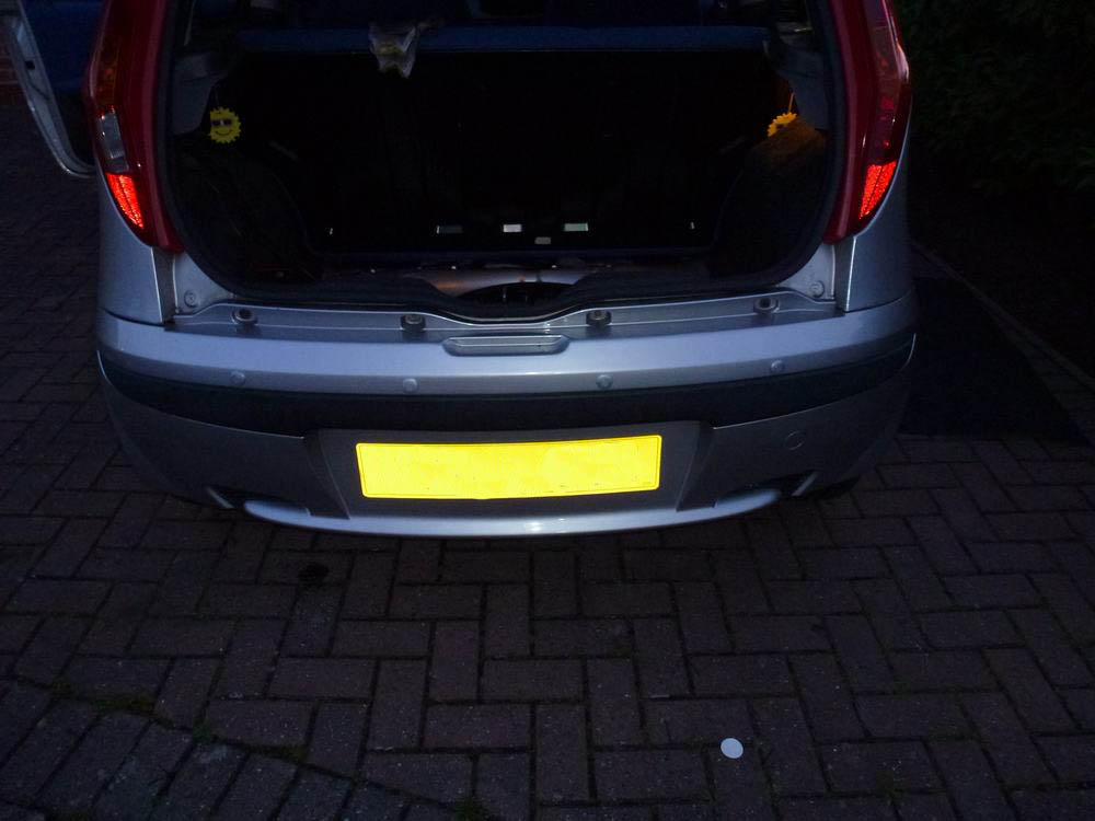

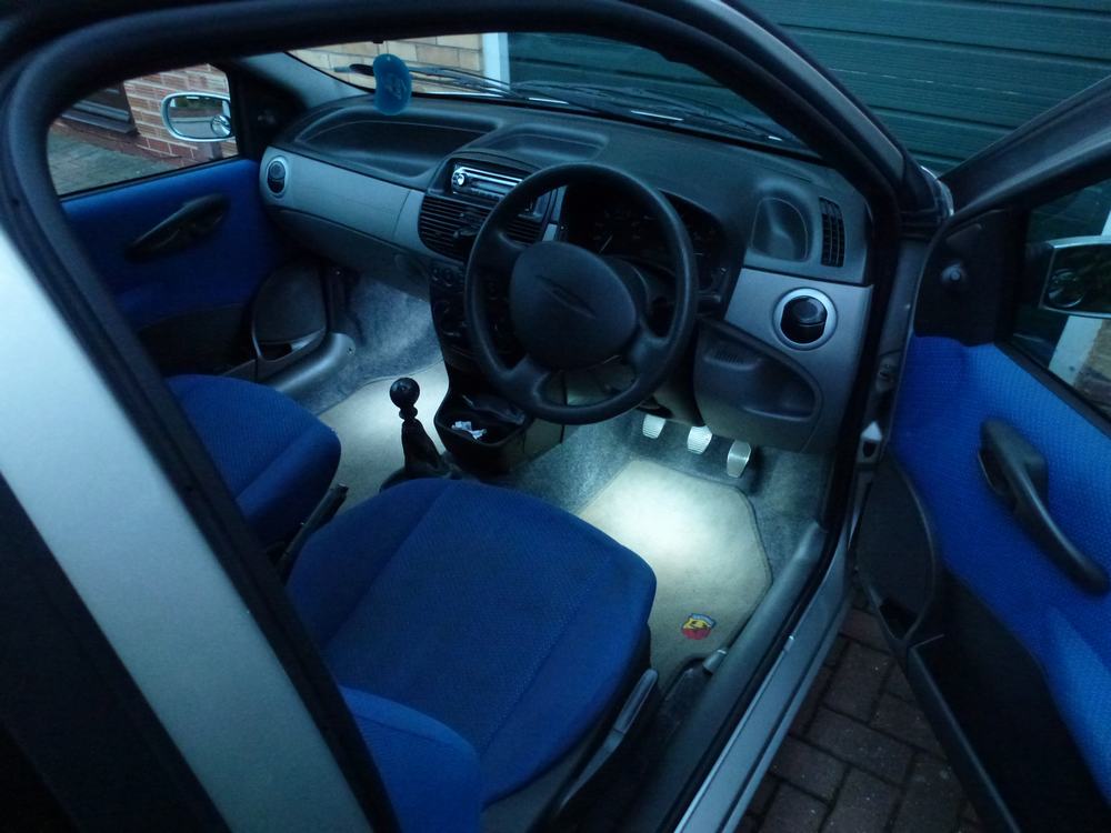

UPDATE: Boot lights have already been reinstalled - ended up replacing the sticky pads with hot glue after the passenger side fell down and I decided I didn't want that happening around the pedals!
It's also dark now, so I can get some decent photos...
Around dusk kinda time:
And then later in actual darkness:
Edit: in the second photo the footwell lights overpower the interior light - it's not really that dark in the rest of the car!
