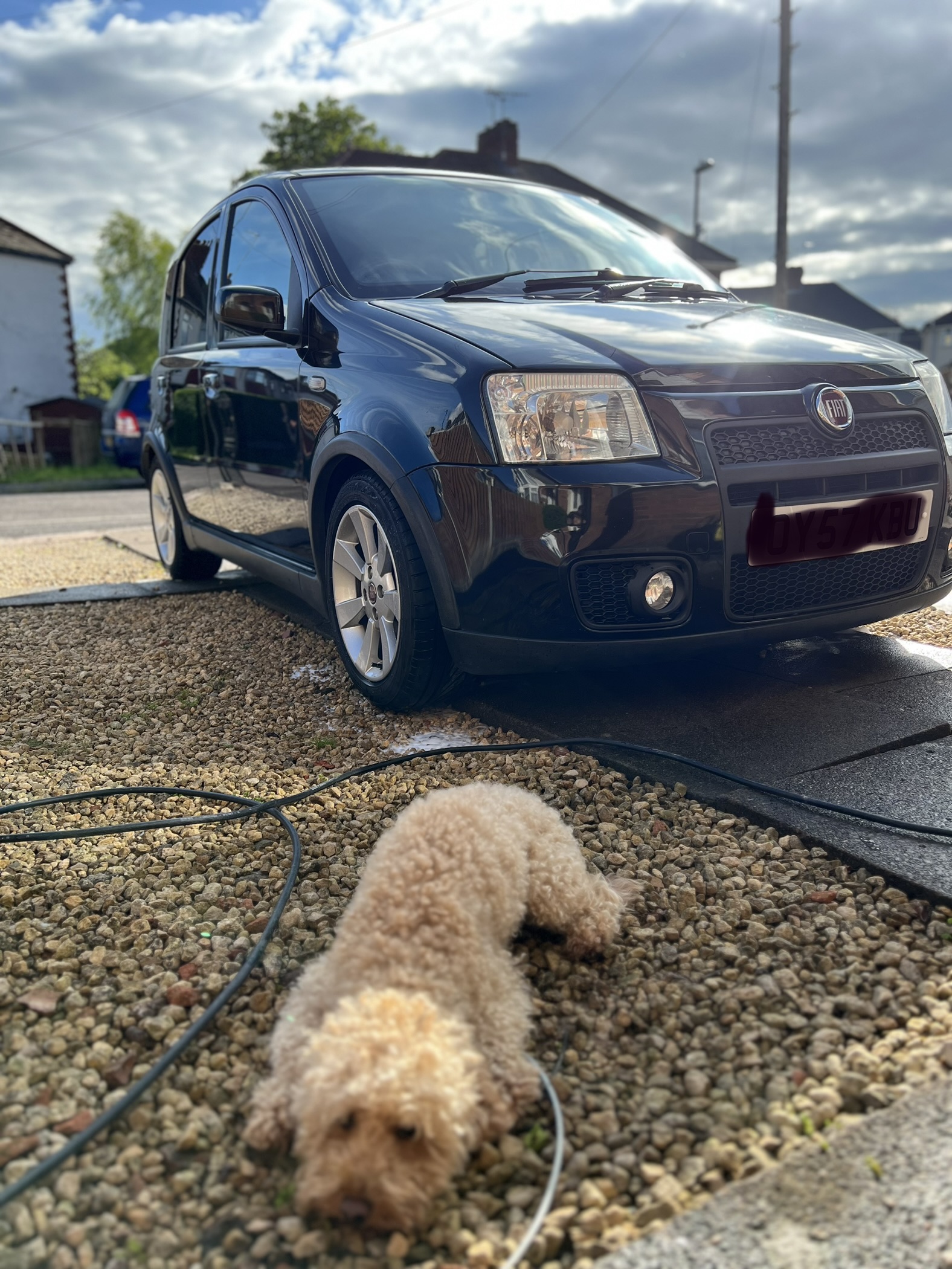

Put a standard Panda front bumper on your car and wrap your 100HP bumper in cotton wool. The 100HP bumper is really fragile nd the main moulding costs at least £600 plus the black trims - probably £800 all in. Paint costs on top.
The standard bumper black rubber bump strips pop out and you can get the divots filled by plastic welding. When done, a matt back band down the middle is close enough to 100HP for most folks to not see the difference. Total cost around £200. The spotlight housings are the same on both bumper types.
