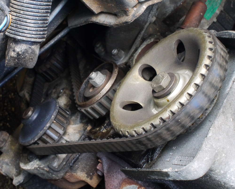

Got some stuff done today. Replaced this sorry bunch...
...with these happy campers.
The old belt (looks to be original?) was mega loose - I imagine it had stretched. The car definitely feels a bit quicker with the new, correctly tensioned belt :)

On topic, I was thinking of cutting the stock springs if I do cut stuff - to me the springs on mine always felt a bit weak at the back, whereas the front was about right. A message to Andrew is in order I think :)
Dragon Man - Good call on the multi-V belt. I haven't got an impact gun, so that'll be a lot easier than removing the current pulley off the old alternator, too!
Not sure why I couldn't get it out - I knew it must be possible, but I just couldn't do it... Didn't seem like something Fiat would do, build a car where you had to remove the engine or disconnect the exhaust to get the alternator out lol
