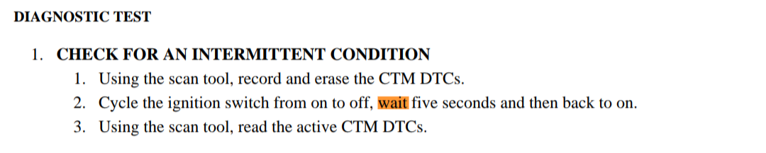

Pending or active error codes
Pending codes will not show until two consecutive errors, no engine check light
When clearing codes you read and erase the codes
Switch the ignition off and wait several seconds for the changes to be written, re read the error codes to make sure they have really been cleared, here's from Chryslers Worksop manual
Active code will effect the running, active code will put the engine check light on, normally the injector is switched off
There's several different P0202 codes short to ground, open and so on, but it looks like you scanner only reading the first part
Check the MAP and check the plugs are actually firing would be my first checks
You can over think thing, it's much easier to physically check, we had a problem here but haven't actually checked if it's properly fixed before assuming it's another fault
