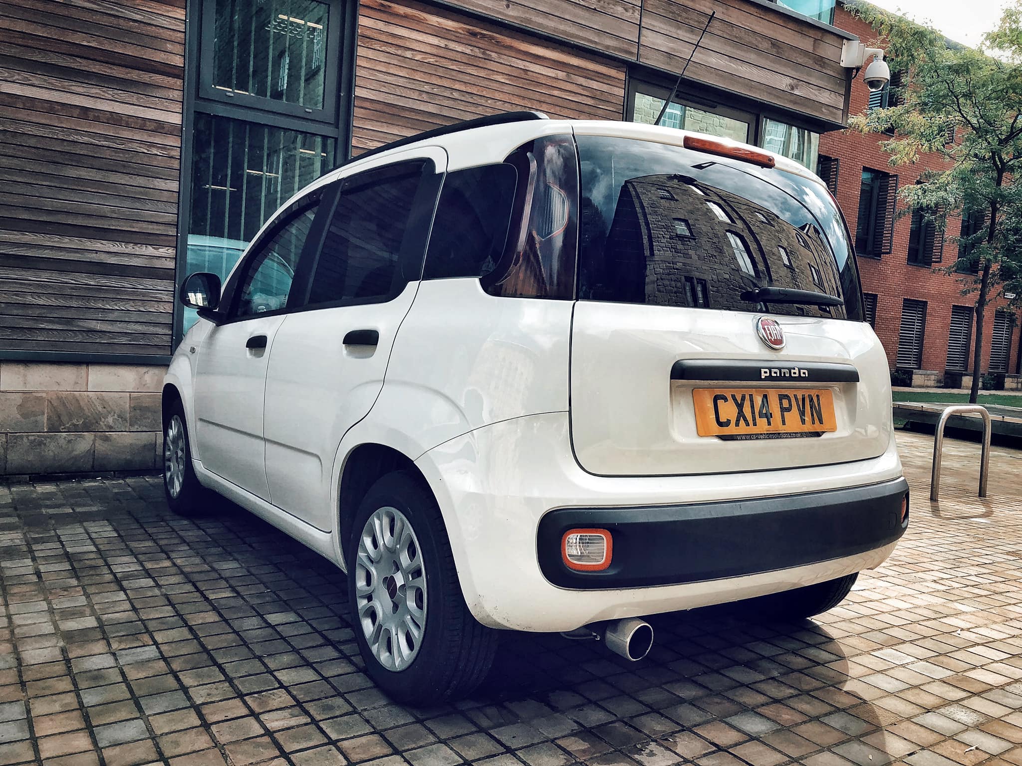

So far I,ve put a K&N panel air filter in. Got some team heko wind deflectors, tinted the windows and lights (20%).
Added a exhaust tip from halfords until I get a ulter sports backbox.
I'm about to plasti dip the hubcaps black until I get some alloys and I've just been looking at the short aerial upgrade.
Hello MyKeyDB. This is an old thread - but who cares!
Nice shine you have on that car - white and silver are notably difficult to make look shiny. I use Colinite 845 wax.
Looks like you're missing some 'FIAT Forum' window stickers too :D

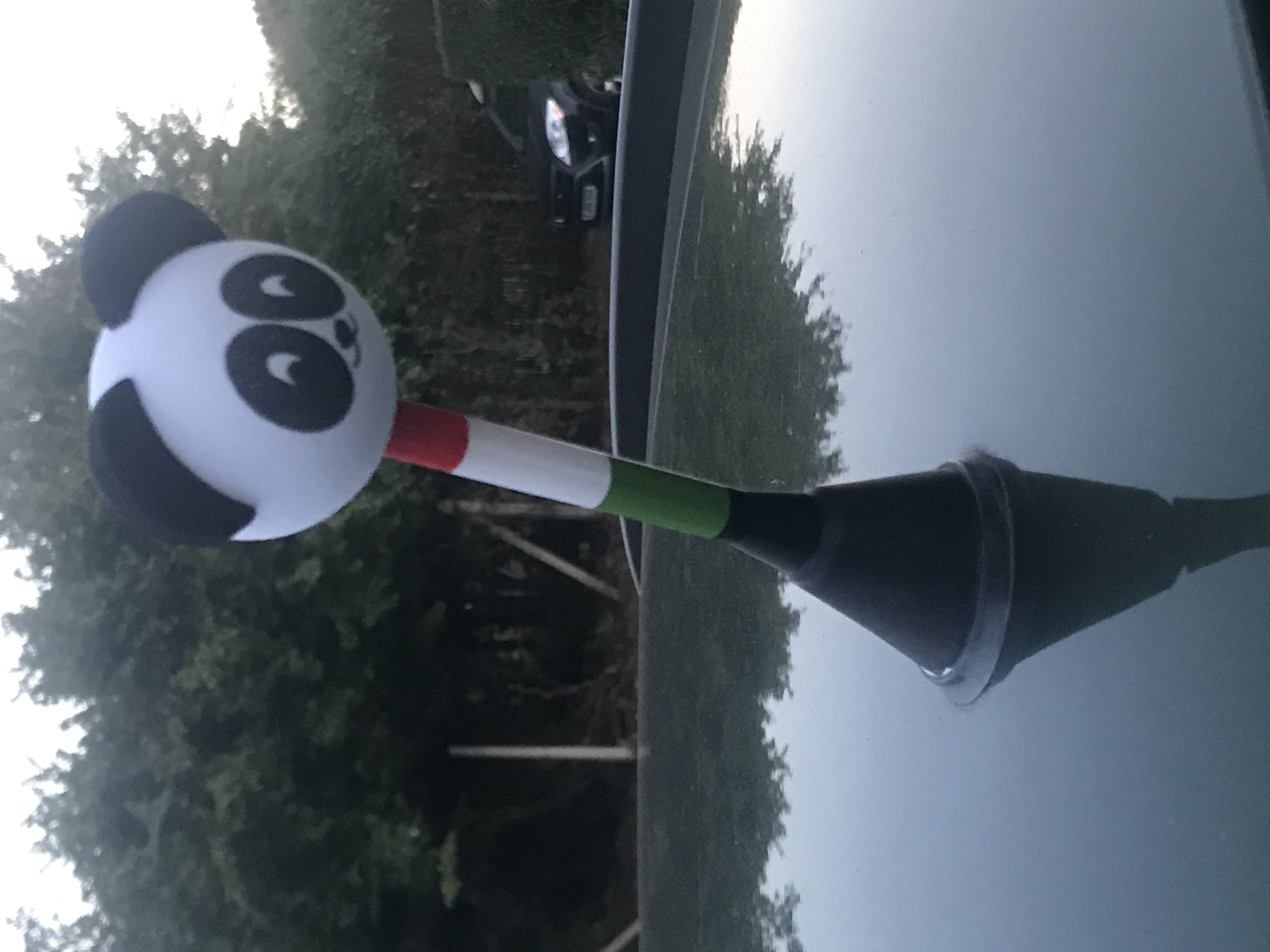

Not a great photo, but this was my aerial upgrade...
Love the panda aerial!

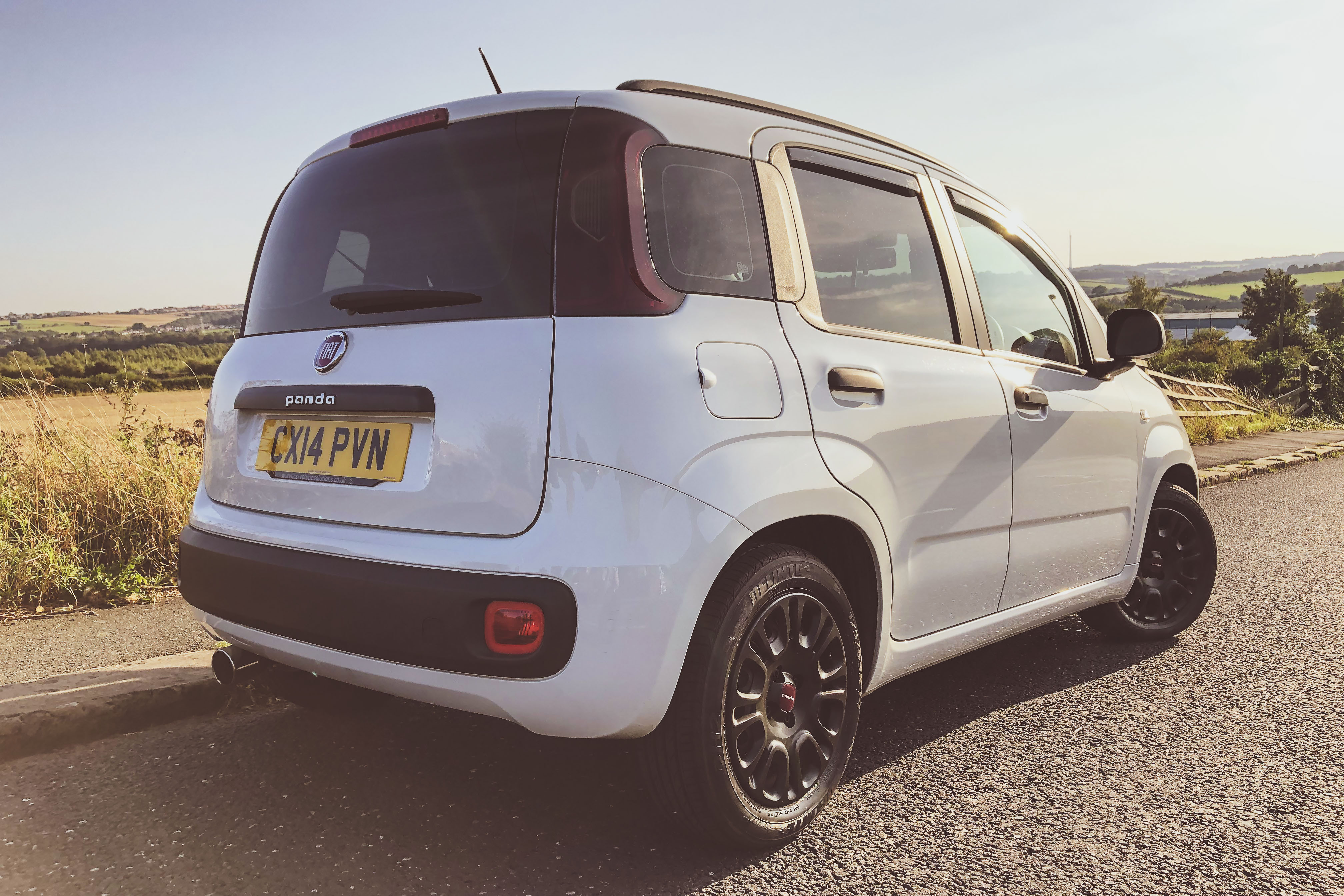

Just managed to plasti dip the hub caps and get the shorter aerial.
Where do I get the stickers from? :)
Just a point on the short aerial - it looks great but doesn't perform nearly as well as a standard one.

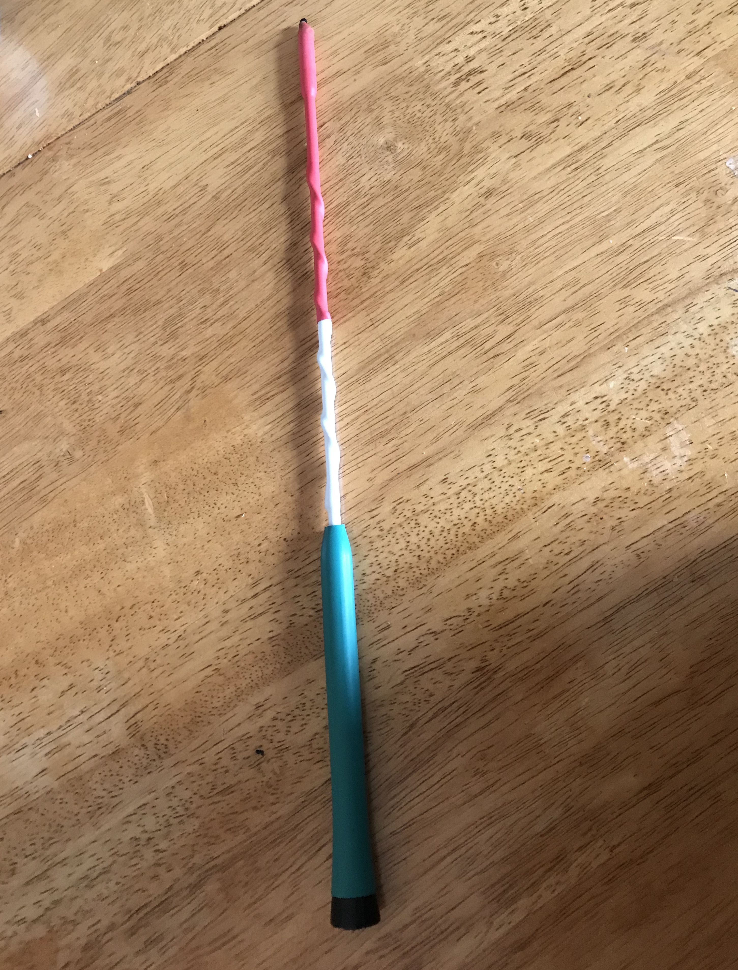

I recently returned mine to original spec, but influenced by the Italian flag on the stumpy aerial I modified an original to be similar using heatshirink :)

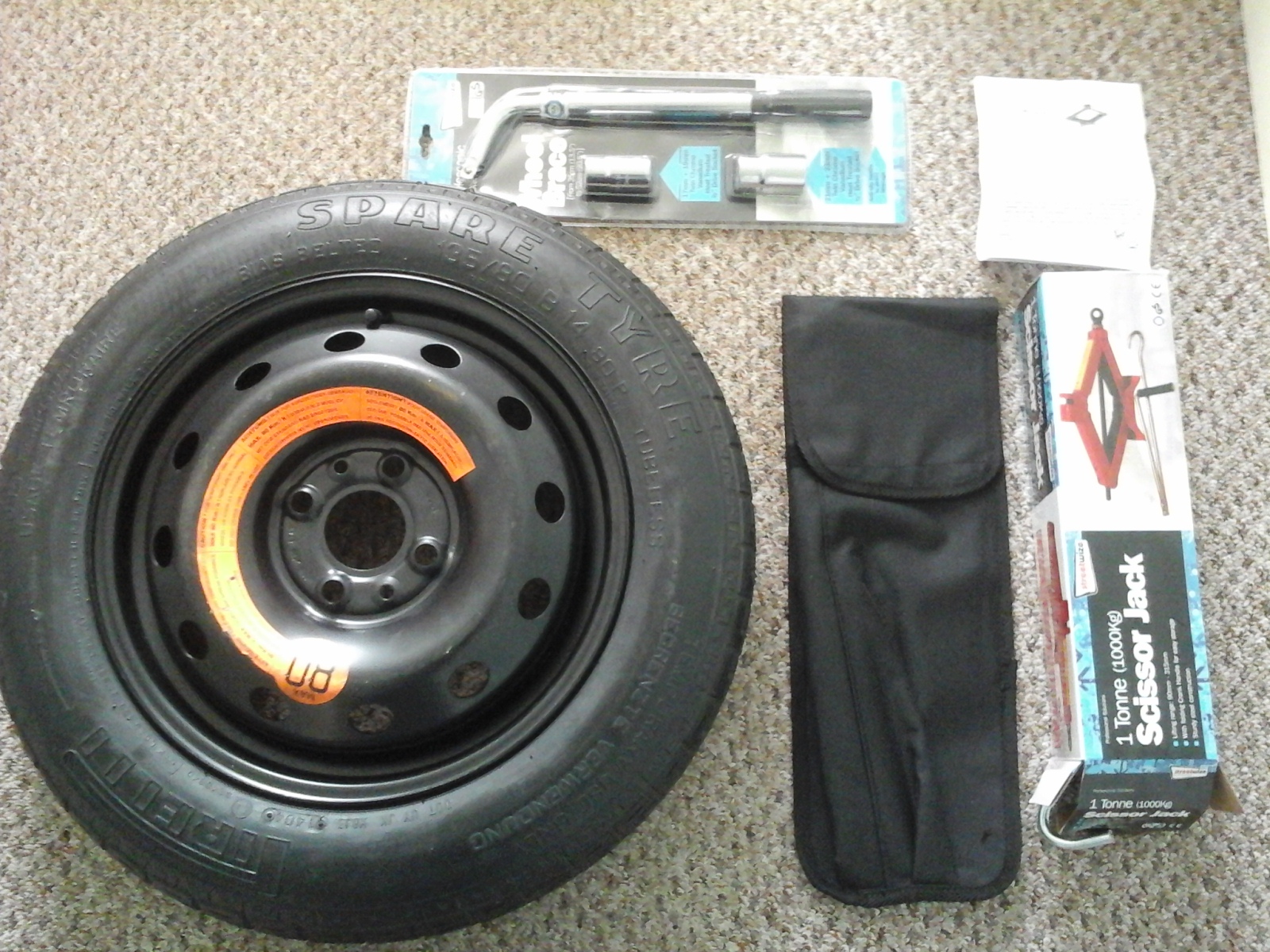

Did you get a spacesaver wheel or full size. And is your Panda a 4x4?
I have a 4x4, the dealer says the spacesaver wheel is not available for this model but the handbook quotes "Spacesaver 125/80 R15 95M."
I recall there has been a lot of comment on this site about 4X4 and spacesavers but was any definite conclusion reached about their suitability or otherwise.?
4x4 *can* use a spacesaver, but it is different to the non 4x4 Pandas. As your handbook says, it is a 15" wheel - the 2WD Pandas use a 14" space saver. Note also the jack is different (because the car sits higher off the ground) - so the standard Panda jack will not work. The correct jack is marked 'Panda 4x4 and Qubo' (or Doblo) - and will not fit inside the spare wheel in the boot. Mine came with one from new (it was an option at the time of ordering), but it seems to be tricky to buy from Fiat as a spare part. The electronics of the 4x4 system can (apparently) tell when a space saver is being used, and reduces the amount of 4 wheel drive available while it is fitted. This used to be described in earlier version if the handbook, but seems to be missing from the latest edit.
At least one of the earlier threads on this subject is here: https://www.fiatforum.com/panda-iii/329490-panda-4x4-toolkit-5.html?p=4199685
Phils panda's eBay wheel and jack will not fit a 4x4 car - owing to the larger front disc size on the 4x4.
Thanks HH. I have ordered a 125/80 R15 spacesaver wheel with tyre from The Wheel Co at £69,free delivery should be tomorrow I already have a jack which fits the jacking point of the 4x4 and lifts it far enough. Have had it years and no idea what it came from now. I also already have a long bar with a sliding 1/2 in square drive and simply add a 17mm socket. In addition I have stuck in the boot a tubeless tyre repair kit which was with a previous bike so I should be ready for anything without having to resort to the "pump and gunge" which came with the car.
Incidentally the wheel supplier made no mention of "M95", so as soon as it arrives I shall be jacking up the car, and fitting the wheel to see if everything is OK, clearing the disc etc etc
In any event thanks for your input and watch this space
The ‘95M’ refers to the load and speed rating of the tyre, not the wheel size. (And is why the spare is only safe to 50mph/80km/h)
The crucial thing is the wheel nut spacing. This is measured by the diameter of a circle that passes through the bolt hole centres (the PCD). For the Panda this is an uncommon size of 98mm (most 4 stud wheels are 100mm PCD, which doesn’t fit properly)
