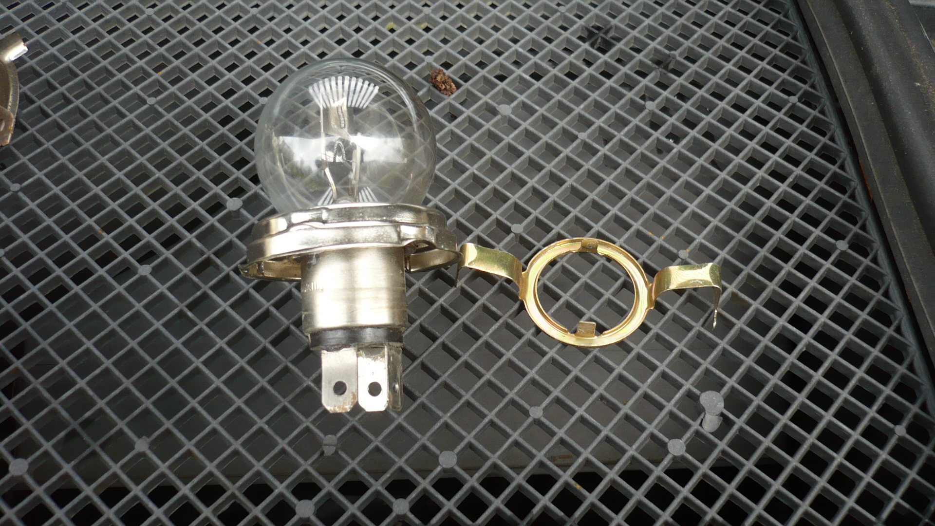

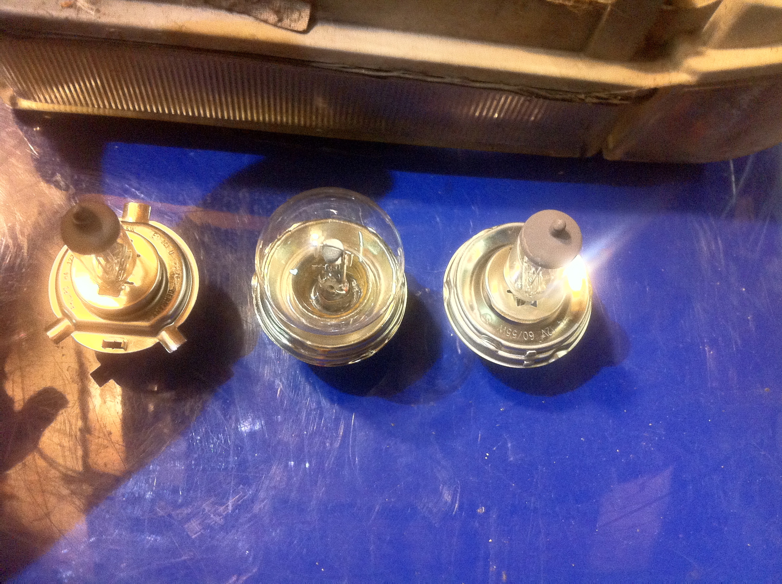

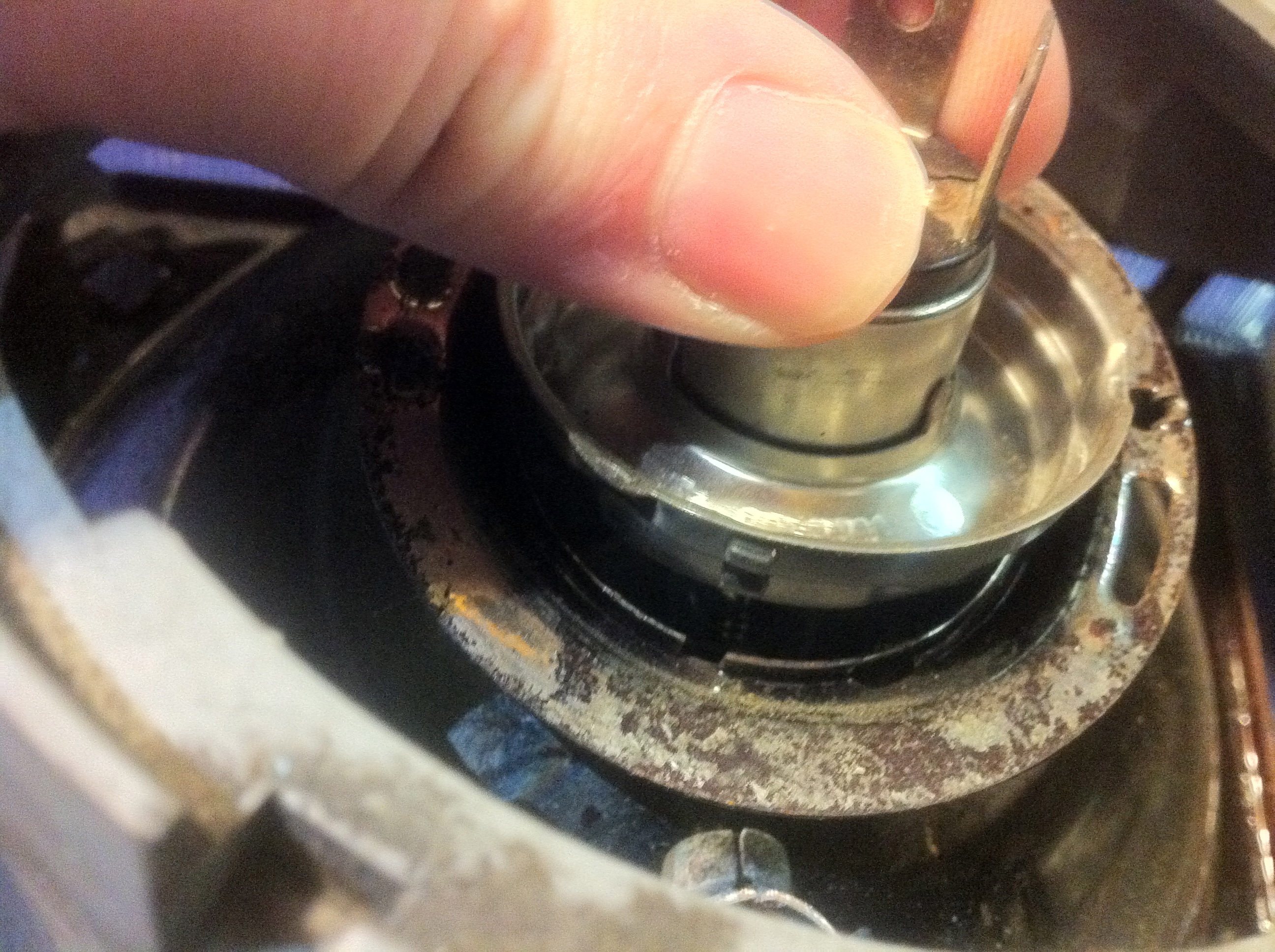

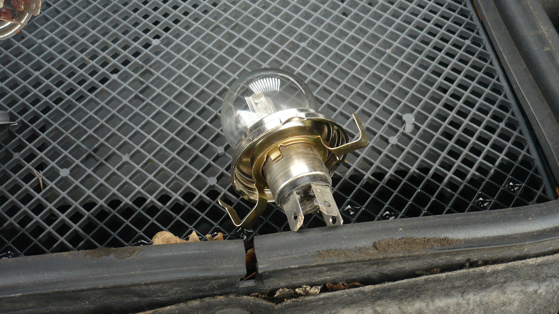

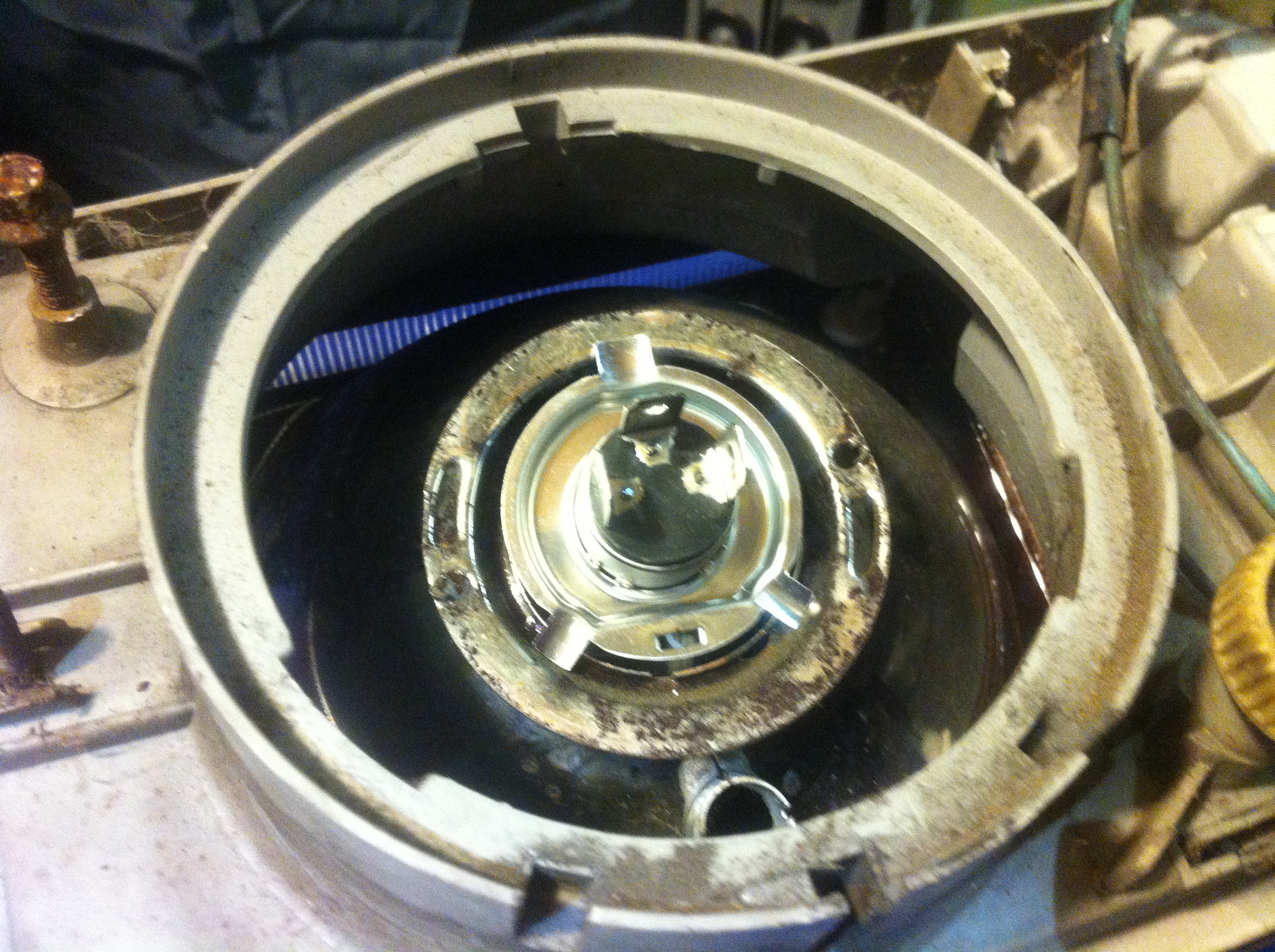

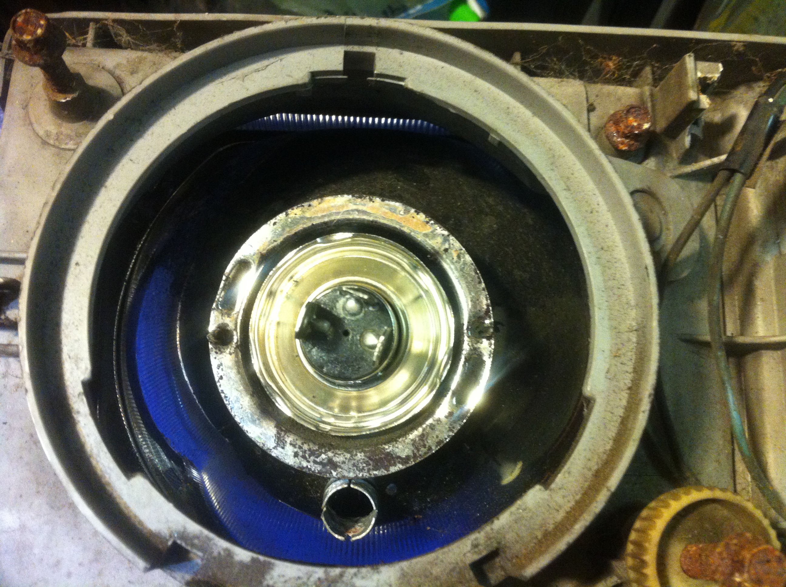

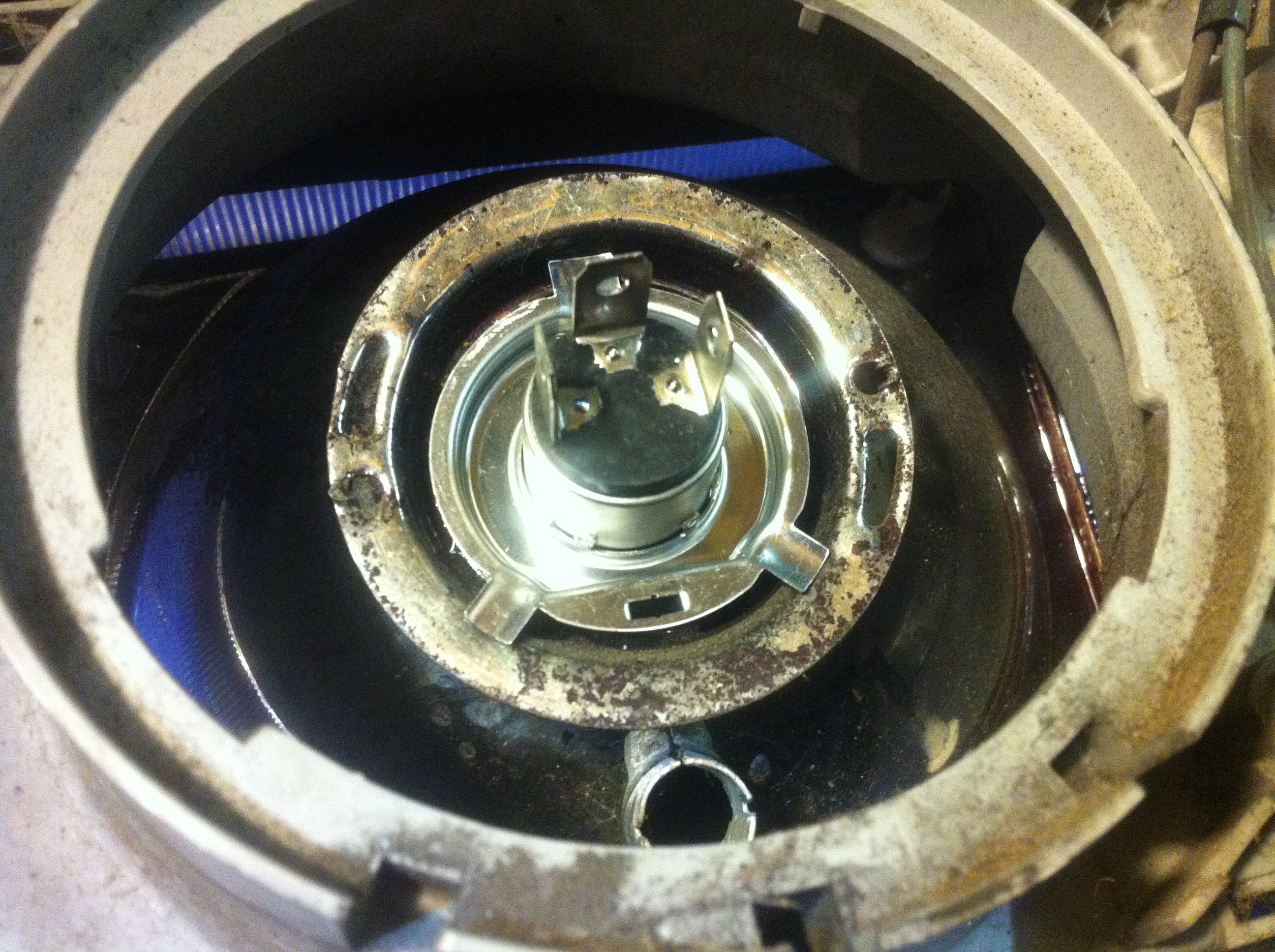

Hi all was fiddling about today with Pippa and thought I would just have a look at the headlight bulbs, because the light is so poor.
Picture 1 shows a std old-style bulb with it's adaptor
Picture 2 shows std bulb with adaptor removed
Picture 3 shows std H4 pattern bulb with adaptor fitted.
I also took a pic of the difference between headlight strength and the H4 one shone out much better. Unfortunately didn't show in the pic as it's too bright here today.
This leads me to believe that it would be possible to replace the existing bulbs with for example Xenon gas ones easily available on Ebay and make a big improvement.
I also wonder whether removing the anti-dazzle cup within the headlight would help also. I've done this on other cars and it didn't muck up the beam pattern but DID give more light.
In view of the colour of the light I still believe that a wiring modification will brighten things up as well - a direct earth perhaps???
Cheers
Dave
Just thinking about this a little more and it seems to me like this:
The old style bulb didn't have much of a shield to guide the dipped beam, whereas it's much more obvious on an H4 bulb,so removing the anti-dazzle cup within the headlight might well be a goer. Following this line of thinking, and bearing in that the H4's 3 locating tags won't engage in the Panda headlight, this might be a way to swap from a RHD dipped beam pattern to a LHD one, merely by rotating the bulb about 30° in it's adaptor?

Sorry but NO NO NO on so many levels!
Firstly you cannot use standard H4 bulbs, they're the wrong base, you must use P45T based bulbs. I don't see what adapter you're using, you mention it but don't include it within the pics. Adapters are available, but are scarce and expensive so I wouldn't bother with this route IMO.
You cannot remove the cap over the bulb, the Pandas headlight units are refractor units, not reflector. Doing this will adversely affect the beam pattern.
Get 55/60watt P45T bulbs and you'll be legal and won't blind every on coming motorist with a badly setup beam pattern (y) Relaying the wiring and refreshing it will also probably see a notable increase in light performance :)
:yeahthat:...only less shouty:p
Think the 'adaptor' referred to was just the spring clip to secure the bulb.
But yes, relaying will increase the output and it's perfectly possible to get uprated bulb options with the correct base on without knocking the beam pattern off(y)

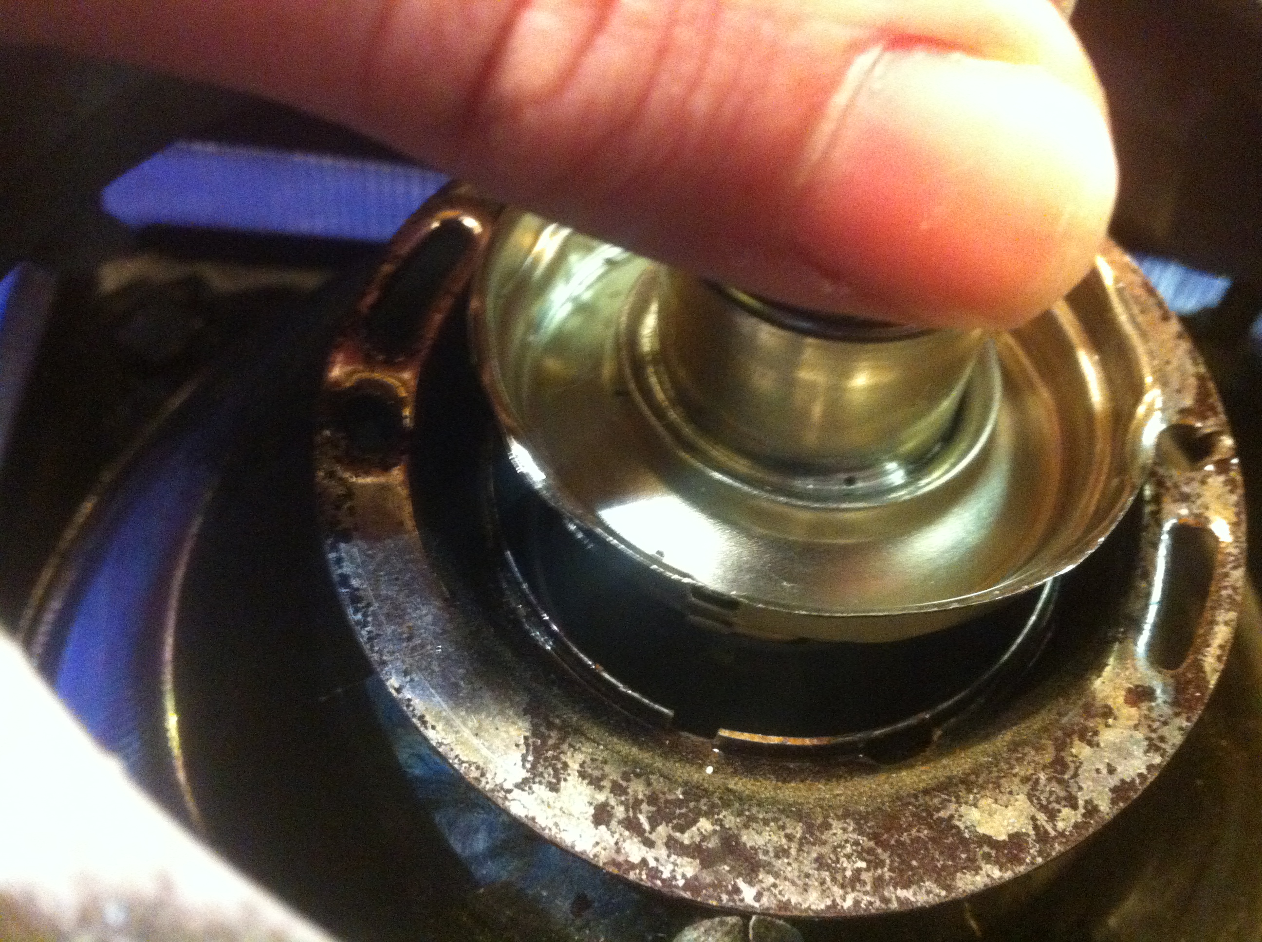

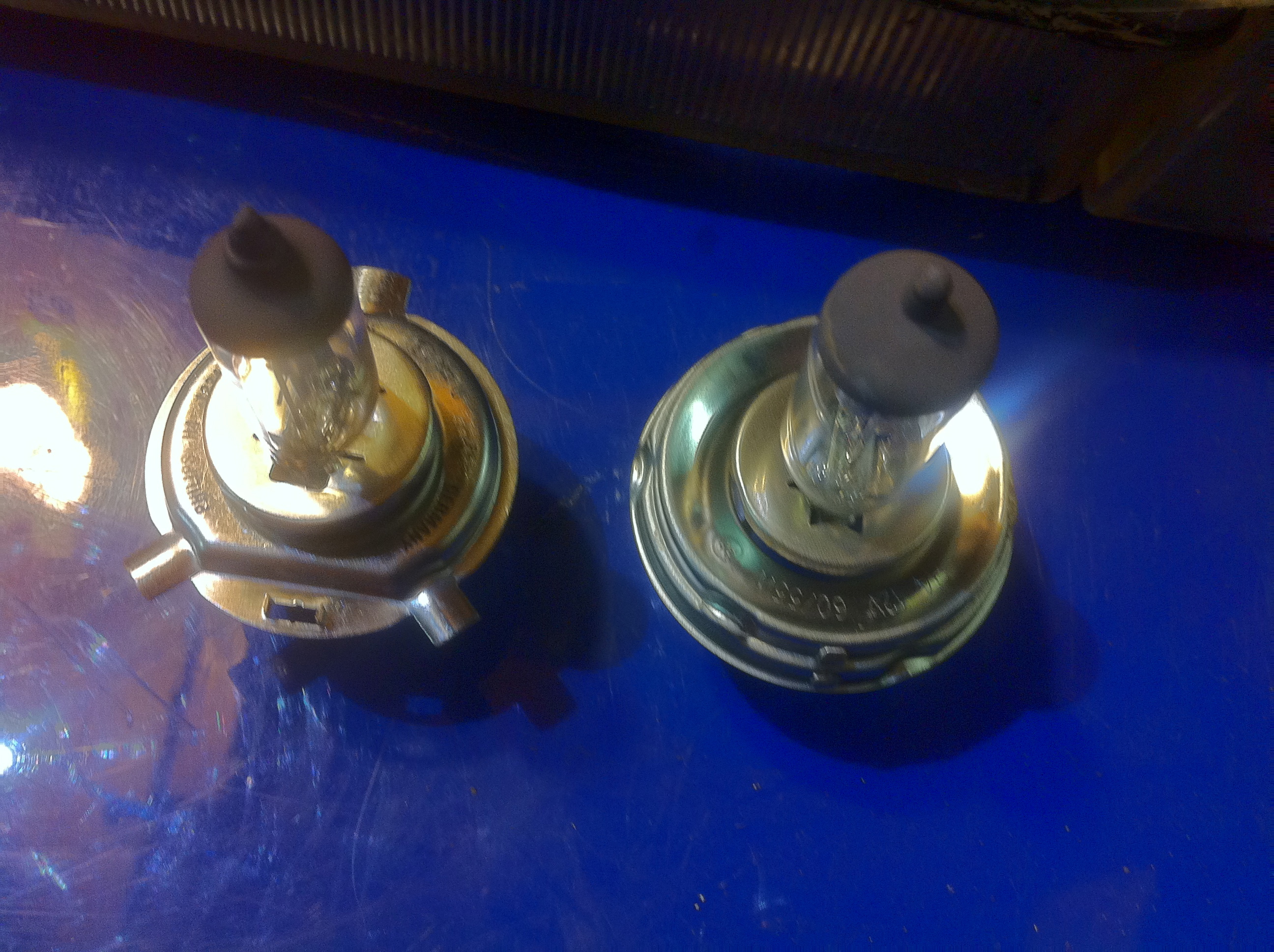

Std 55/60w H4's go straight in, using the spring clip retainer as per the pictures.
The beauty of using std H4's is that they are available in such a wide range of functionality, that's why I wanted to see if they fit - which they do.
The headlight unit is not designed for a H4 bulb, you said in your original post that the locating tabs on a H4 bulb do not fit into the headlight, to me that makes it obvious that the bulbs will be no good as they cannot be fitted as intended using the tabs to locate them in correct place.
No they do not, or perhaps they do, as much as the square pieces go through the triangle holes :bang:
If they fit so well then why has it taken 2 decades of everyone using P45T bulbs correctly instead of H4's??
Lets take it back to basics.
This is a H4 bulb and this is an original Panda P45T bulb and they both have very different bases.
This is the rear of a P45T headlight unit, as fitted to the Mk2 Panda's - no room for 3 prongs / legs.
This is the positioning hole on the P45T headlight unit, and the tab on the bulb which fits within it aligning the beam pattern correctly.
This is a P45T based bulb sitting correctly in a P45T housing.
This is a H4 bulb, sitting in various different positions in a P45T housing - see how they are not compatible and no matter what you do it WILL NOT FIT ;)
Get a 55/60watt P45T based bulb like I've originally advised (the one on the far right) (y)
