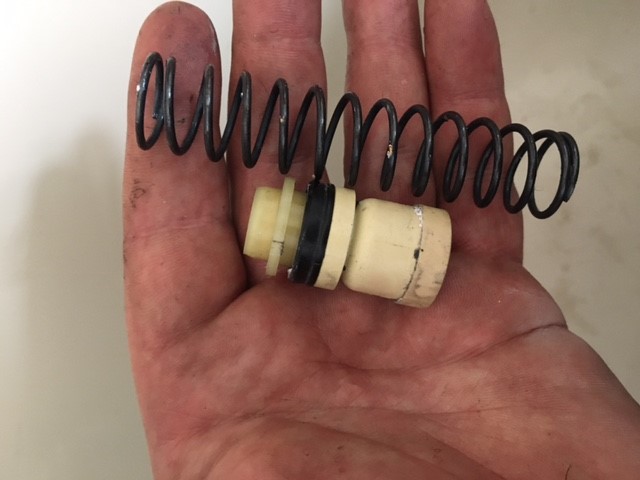

Here's a piston on a slave that I have changed on a 500, this is jamming, it does cause the pedal to intermitantly stick down, it does work fine if you regrease it. I did decide to replace it

I have opened four (not a huge sample) of slave cylinders. One had a rusty spring and looked crap. However a clean up job did not leak fluid so it went back in. The pedal sticking down quickly returned. The solution is not guesswork. Bleed the system and see how it goes. If the problem returns it is the master cylinder.
