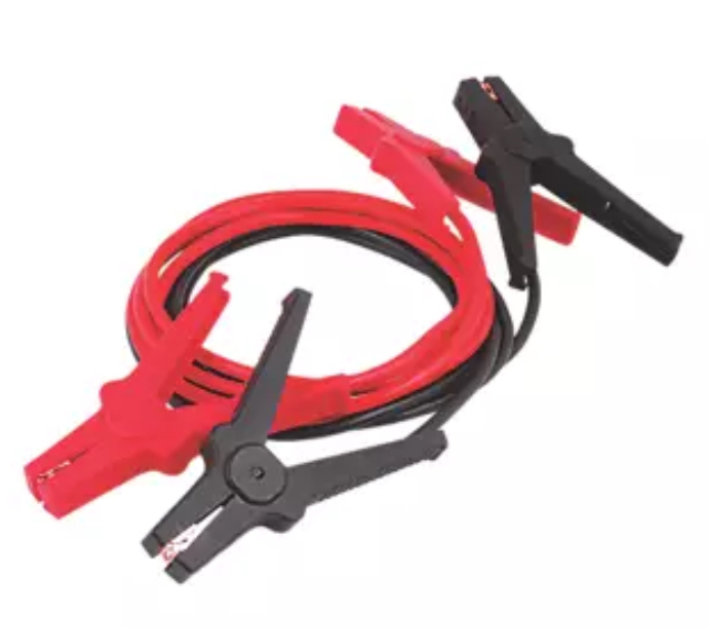

Jump leads from working car
Positive to positive
Negative to gear cable bracket
Would eliminate the gearbox ground

Voltage drop test
Google should find a good explication
However you have jump lead
On the fault car instead of putting the negative lead in the battery put it directly on the gearbox cable bracket
There’s an earth under the clutch slave cylinder that’s not visible
