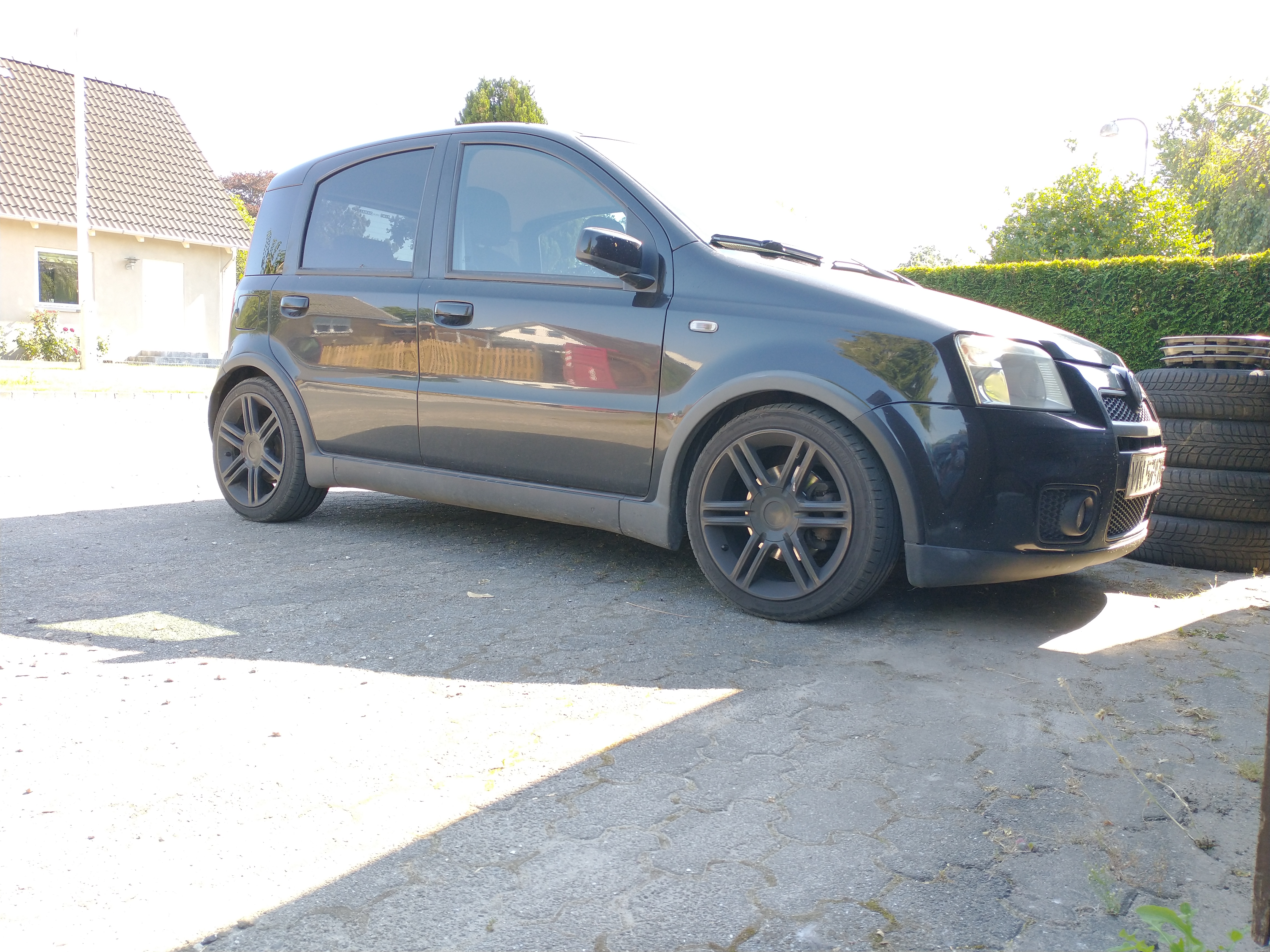

My 100HP sits on some 7x16 Stilo wheels; they need 10mm spacers in the rear (from offset 41 til 31) to not scrub on the inside and anywhere between 5-10mm up front to look good.

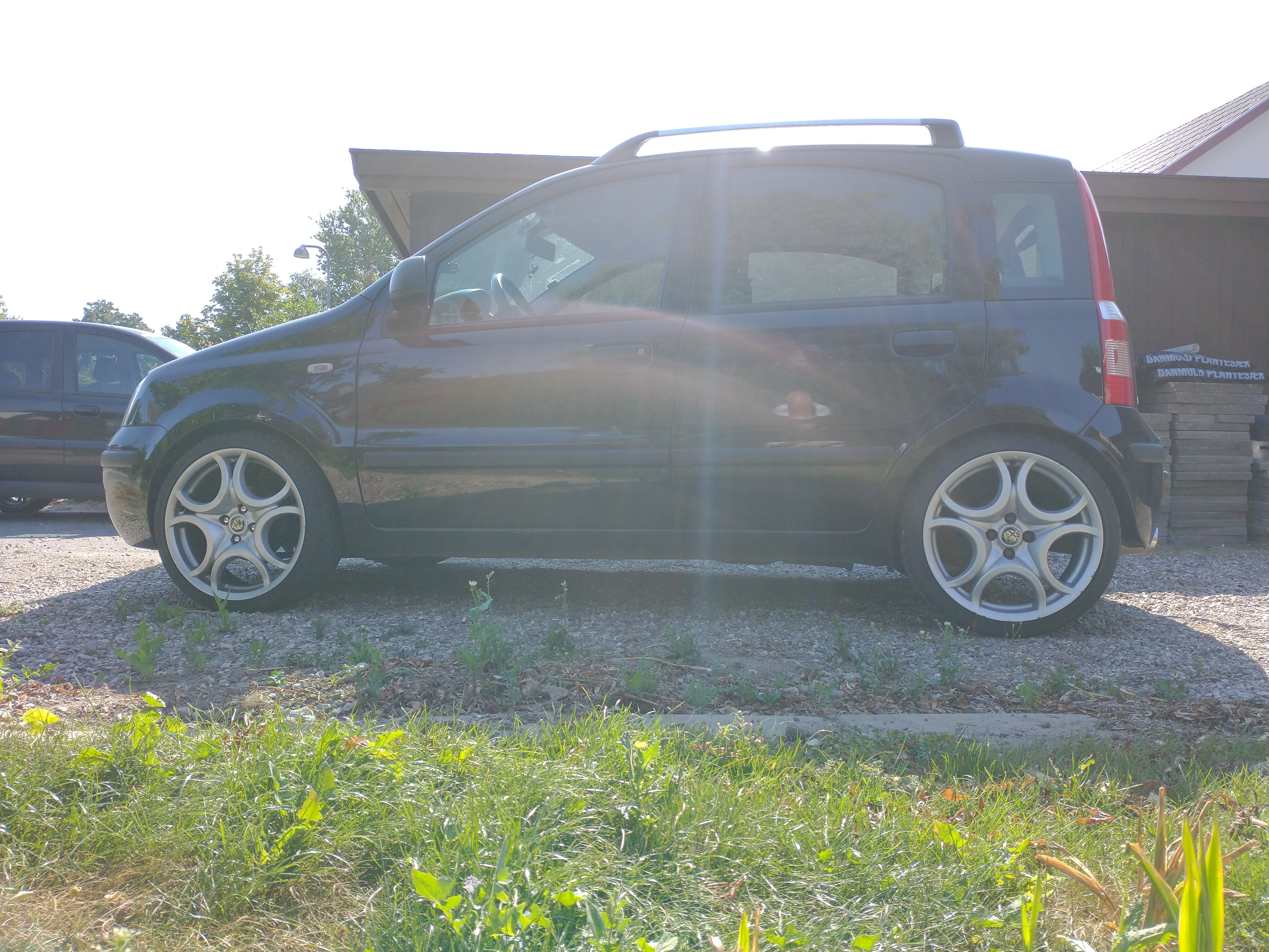

My other Panda (69HP/2011) has 7x17 Mito wheels with 5mm spacers in the rear (only showing them off because you mentioned Alfa wheels and I'm a fan of most of their wheel designs, tbh)
Something tells me you lot have worse roads than we Danes, though.
Steelies do look good to, I'll admit.
