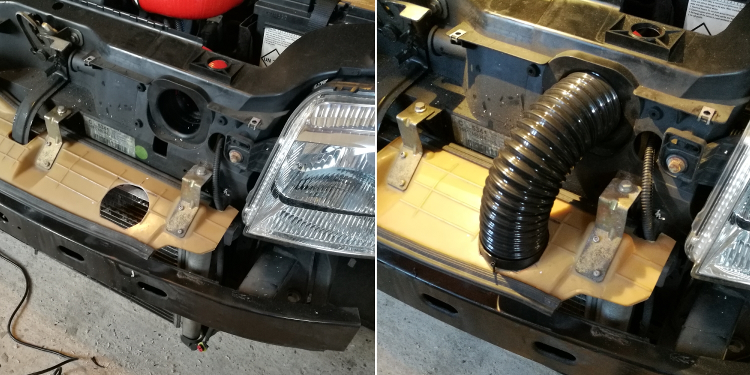

Today's job though was trawling eBay for an air intake. Seems the previous owner removed the initial air feed for whatever reason. eBay not being much help though. Can anyone point me in the right direction / give me some advice on what I need to be searching for? (searching for panda air ducts / air feeds / air intake - not showing the exact one I'm looking for)
Red rectangle : feed missing on my car.
Red square : there has been a botch job at one point where the small pipe has disconnected and the previous owner has pasted it together. Which must've become brittle over time and has now come loose.
Cheers for any help in advance
ebay is probably your best bet. email a breaker, you may have to buy the whole airbox though, unless you find a local one were you can get the bits yourself.
alternatively, you can make up an intake duct yourself. this gives you a slightly throughtier sound and keeps the cold air intake advantages:
https://www.fiatforum.com/panda/319449-100hp-induction-mod-under-30-a.html
same goes for the bodged up pipe. you can either buy from a breaker, or make something up. unfortunately, not many second hand bits about and what is about doesnt tend to be cheap :(
I'd go for what is called "the Cooperman induction mod" on this forum. I did and (although I'm a granddad) love it .

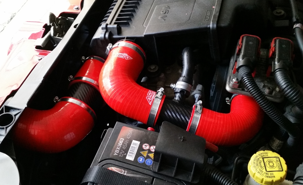

Go for it, the Cooperman induction mode is the way to go, I'm half way through mine, sourcing parts for ebay & ASH (even done the Carbon wrap on the alloy joiners, looks amazeballs).
If you need hoses size etc, I think most of us with 100hp's have done this mode and them if needed.
Or you could go the hog, but proceed with caution. This is an arduous task, not the mod itself but getting the front trim off is really fiddly....
Have I noticed a difference with a more direct airflow, not really :)

1st stage, front grill to Airbox
Straight Silicon 70/75mm Length 80mm Diameter
Elbow Reducer 80-70mm Diameters
Alumimin Join 100mm, Length 80mm Diameter
2nd stage, Airbox to Manifold
90deg Elbow Reducer 63-51mm Diameters (ASH)
90deg Elbow 51mm Diameter (ASH)
Alloy T (body 102mm) 19mm spiget, 51mm Diameter (creationsmotorsport: Ebay)
