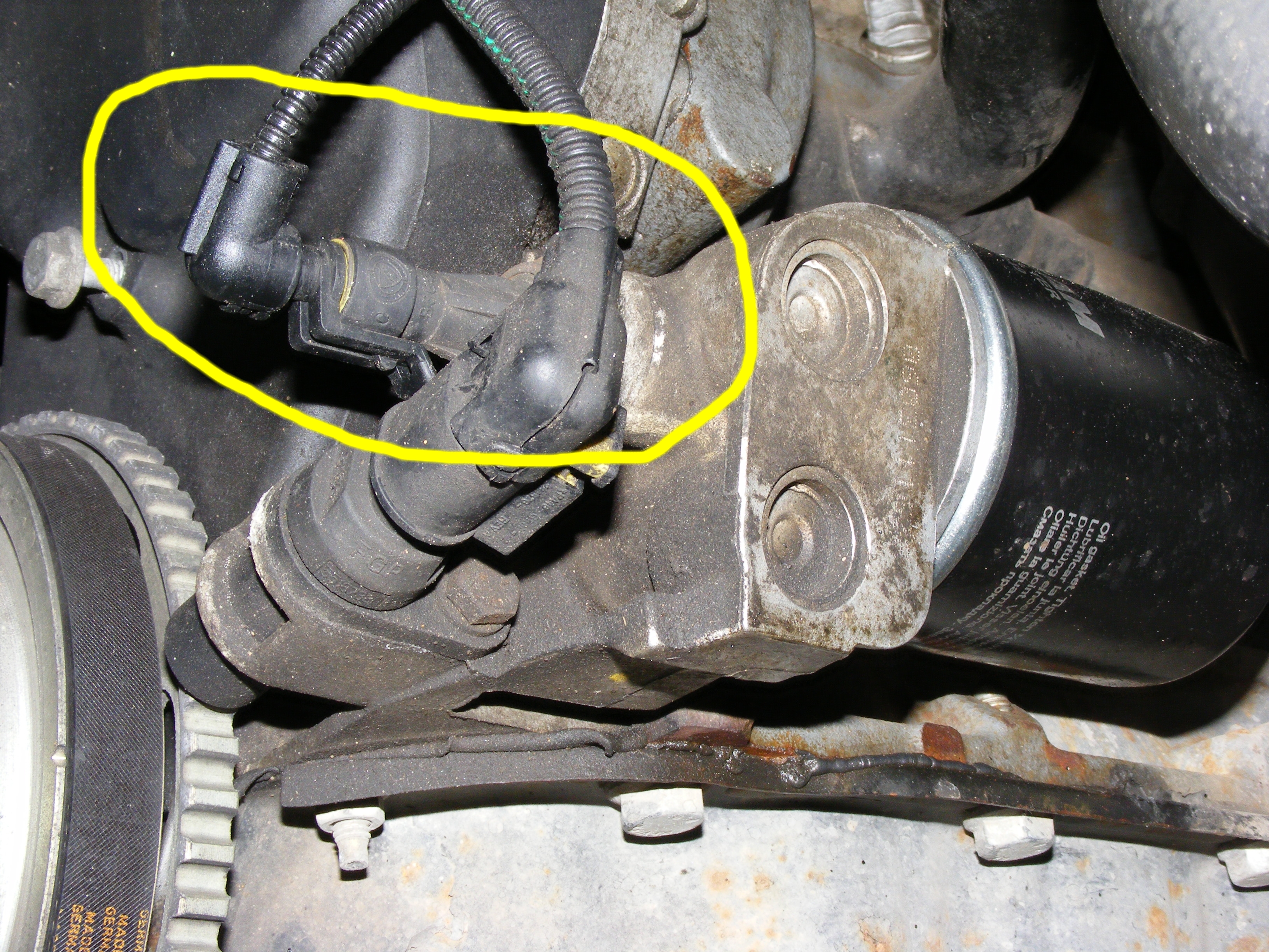

i would think the oil pressure switch will be on the lower front of the engine next to the Oil filter
this pic is from my 1.2 8v Grande punto but i think the engine is the same.....
the other sensor next to it is the crank position sensor just so you know
