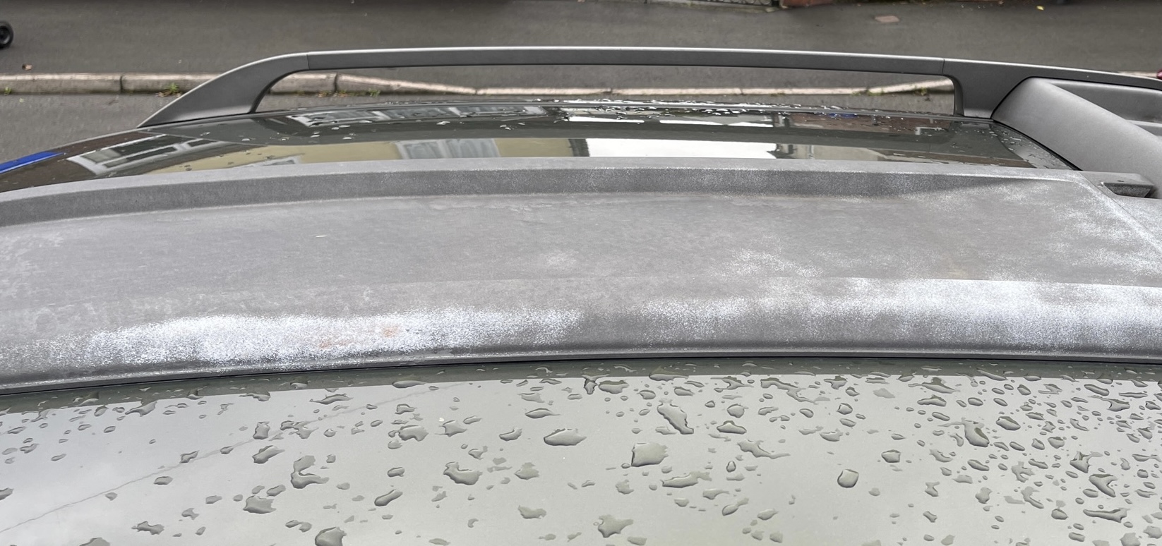

Thanks Koalar, there’s a bit of the leading edge chipped on mine and its not grey, but almost the same as the door trims. I found these:As far as I know the grey all the way through and not painted
The white should t-cut off, but I don’t have the cross so can’t test for myself so don’t quote me
You can buy generic grey plastic paint. How close they are I don’t know
Part numbers are here I hope
I’m sure you are more on the mark than I amEvery part painted has the colour code on them
If you look at the bottom edge of the any door with a mirror you will see a label with its paint code
I don’t believe the trim is painted. It just deteriorated under the suns UV.

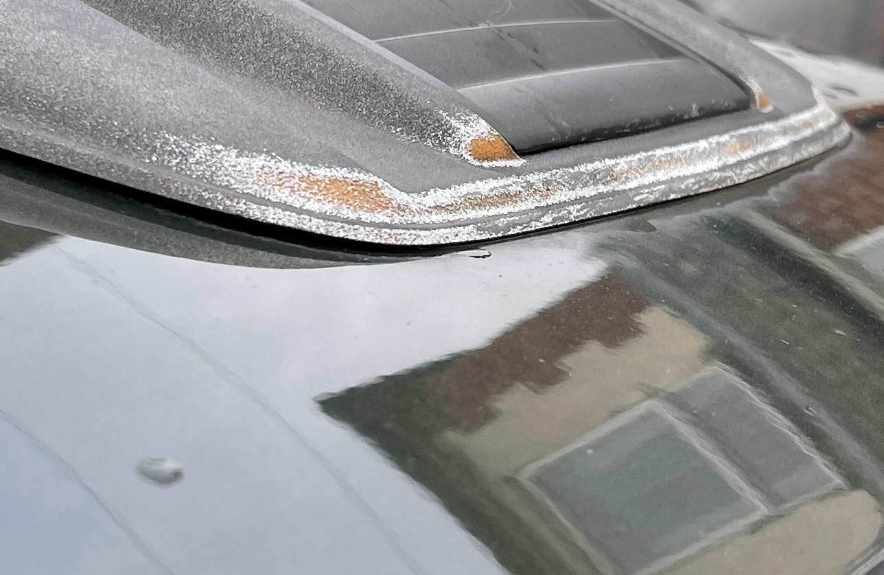

Chips will deteriorate quicker as the UV blocker will have been lost from the surface
Painting plastic isn’t straight forward
Cleaned
Roughed up
Remove dust
Special primer
Painted
Sealed from UV
Of course I could be way off the mark
Dam that’s not going to polish out
Can only see one for sale @ £150 silly money for what it is
Bumpers are different as they are colour coded
Worth putting in the effort of doing it yourself
