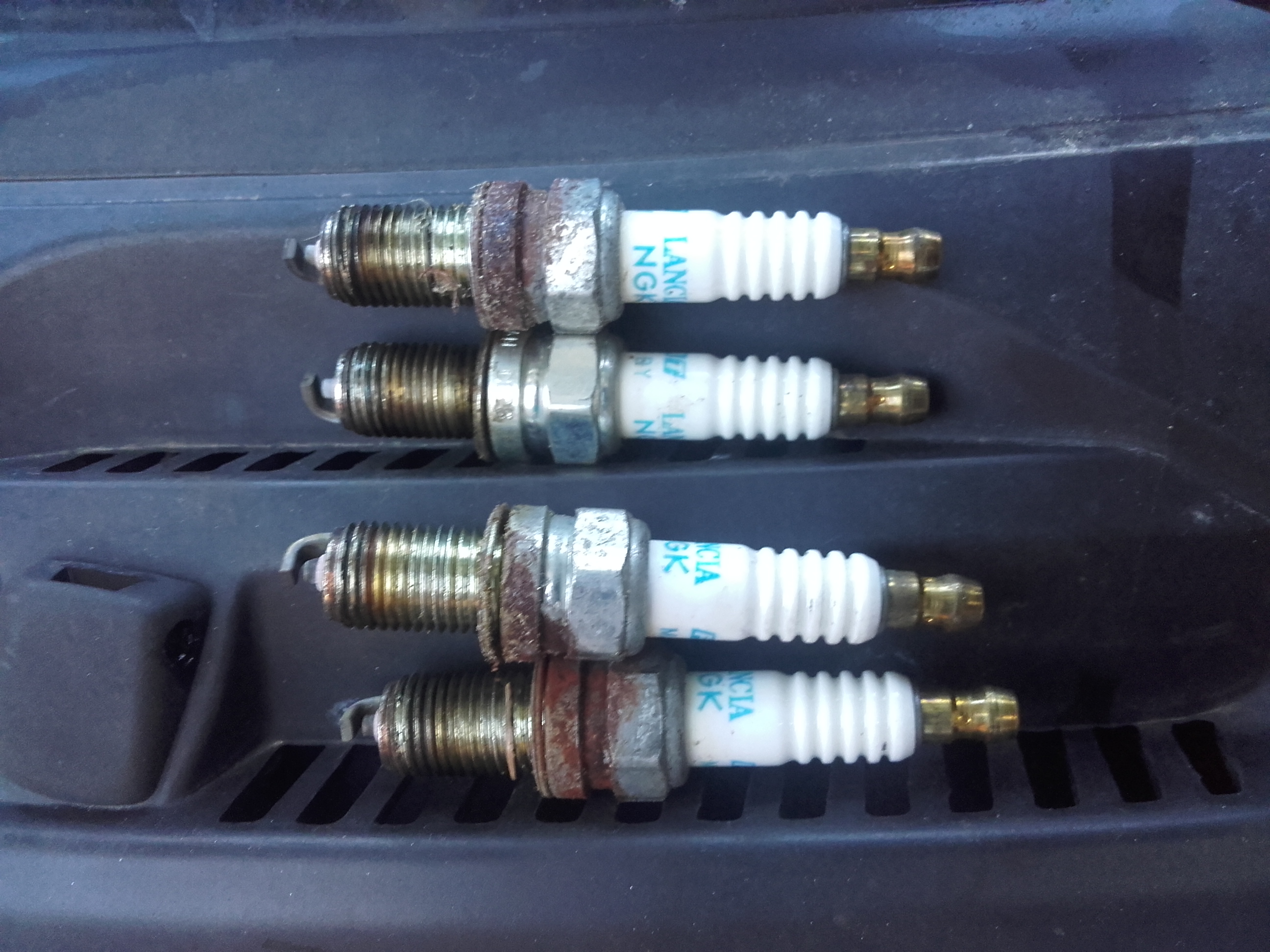

So swapped cables and plugs and after 20?km no codes, and smoother sounding... attatched are the plugs, pulled in the order they are lying in from left to right. Thanks for the help in maybe not having to get a new catalytic converter just yet

Plugs look a good colour. But changing them helped. Suspect the coil pack is breaking down at higher revs
