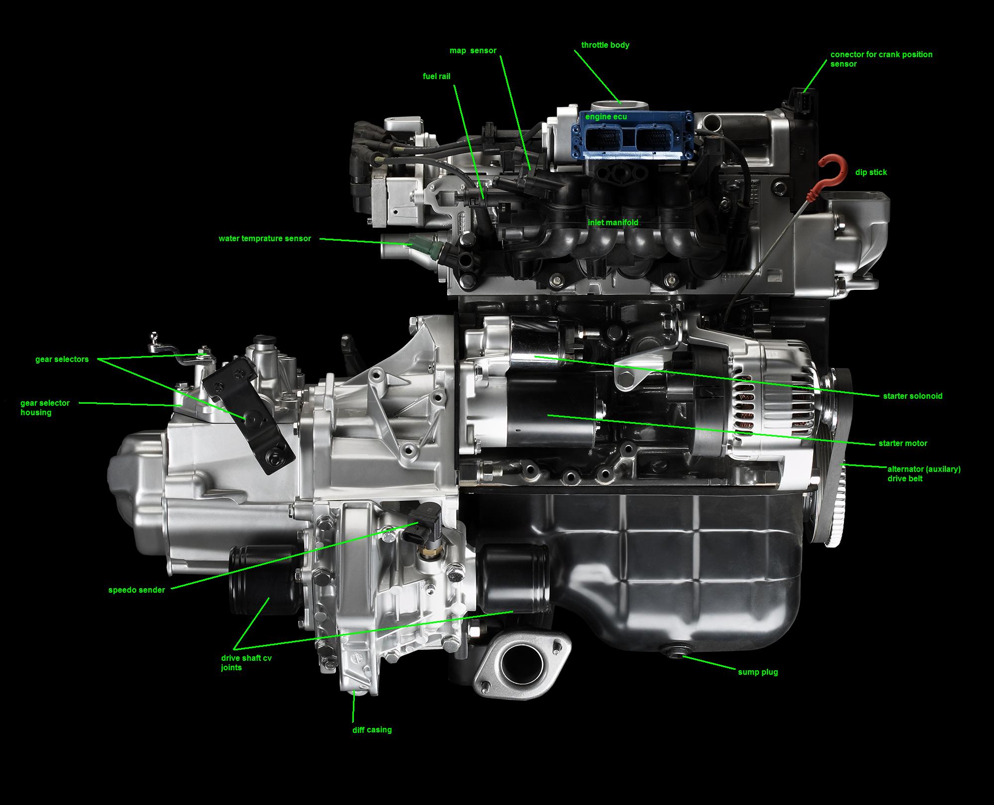

wow that seems like an easier way to test it! where abouts is the coolant temperature sensor?
so if im reading what you wrote correctly, you turn the ignition on, then disconnect the sensor, and the fan should then kick in within about 10 seconds? no need to start the engine?
Yup - yup and yup
This big picture from the guides section is pretty much spot on :)
Guide Here
Big picture Here
attachment.php
failing not been able to find it
Follow the heater cables from the firewall of the engine bay
1 will go to it
Most are a green connector
Ziggy
