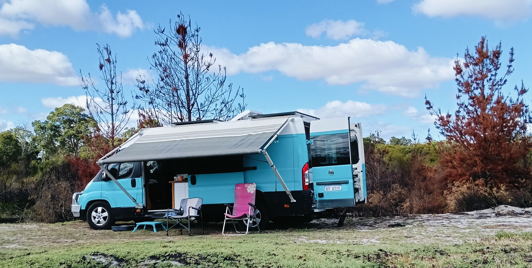

Ducato Our Self Contained Ducato Campervan
2008 Ducato 3l 160? multijet engine.
"Eddie" the van has a LWB, High Roof with 360K + kilometers. Set up for extended off grid camping. Our means of heading "bush" and hanging out in nature for chunks of time. We're based in Mandurah, about an hour south of Perth and there's plenty of places not far from here where we can hang out on the bush for free or nearly free.
Hi Asda, the colours are very er "beachsidey". It works for us and we've inherited a bunch of blue spray cans from the previous owner. With regards to being off grid, there's more that could be done but we're pretty good so far. Down the track will be an air conditioner and that will require quite an upgrade .. second 300Ah Lithium battery, a suitable 24volt inverter and wiring to step down 24 volts to 12 volts for the gear that uses 12 volts (USB chargers, water pump, lights) In the nearer future I want to add ammeters to display solar input and amps out at any one point in time. That doesn't really affect our off-gridness but it's useful to be able to monitor power in and out (and it's pretty cool ... had a setup like that in a 4x4 motorhome based on a Mitsi Canter light truck :) )

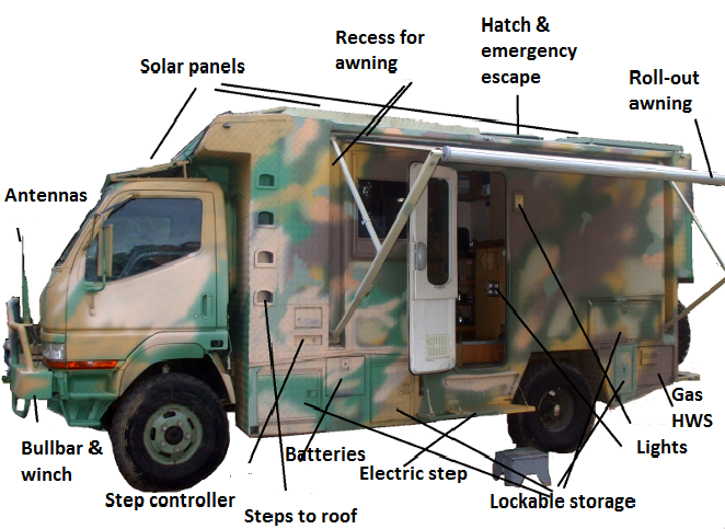

Here's a photo of the 4x4 Canter. (I liked to hide in the bush hence the camo paint job!)
