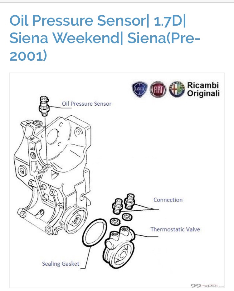

My car is in excellent running condition, except for the oil light flashing now-and-then.
Sometimes when it idles or at low speed. It never stays on, but just occasionally flashes.
I have noticed oil leaking/sweating out at the bottom where the oil filter is mounted.
The other day I wiped it clean. I let the car idle and noticed oil seeping out of the seal of the housing next to the fitting where the oil filter goes in (see attached diagram - "sealing gasket") IMG_4147.JPG
My question is as follows... if this seal is leaking and has become so deteriorated over time, would that be the cause of the oil pressure dropping?
Any advise would be greatly appreciated.
Regards
Hugo (South Africa)
That seal sweating a little oil is not cause of oil light.
Low oil pressure.
Faulty sensor.
Incorrect grade of oil.
Faulty wire.

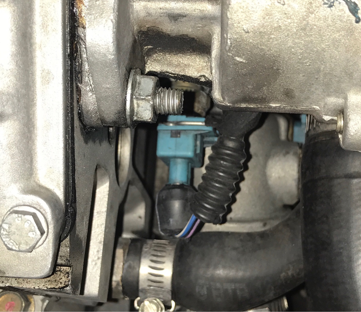

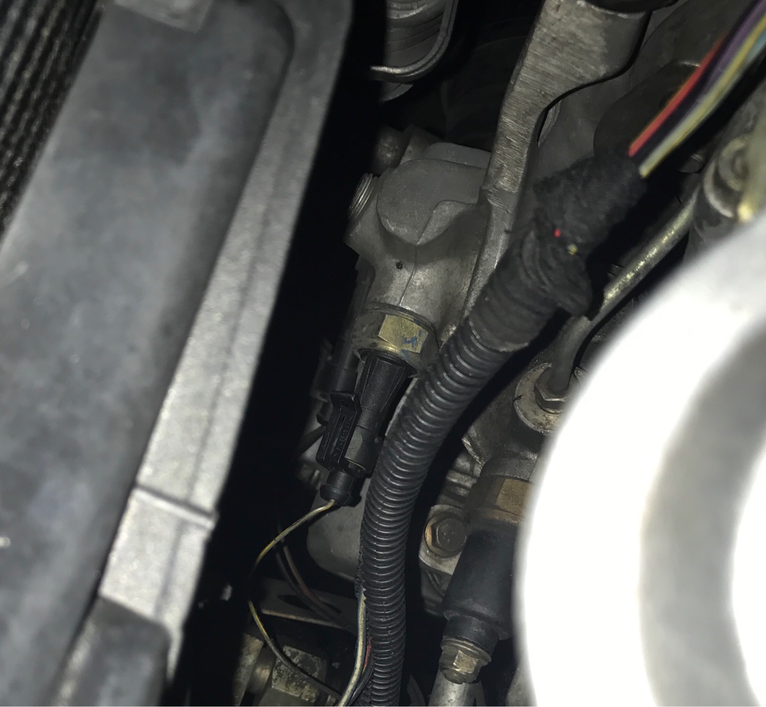

I managed to check the wires in the oil pressure switch. That's fine. The same wire is connected to another switch that bolts into the thermostat (photo with blue switch).
That was oily and I cleaned it.
Since yesterday I have been driving urban and freeway... no lights coming on and everything seems ok
