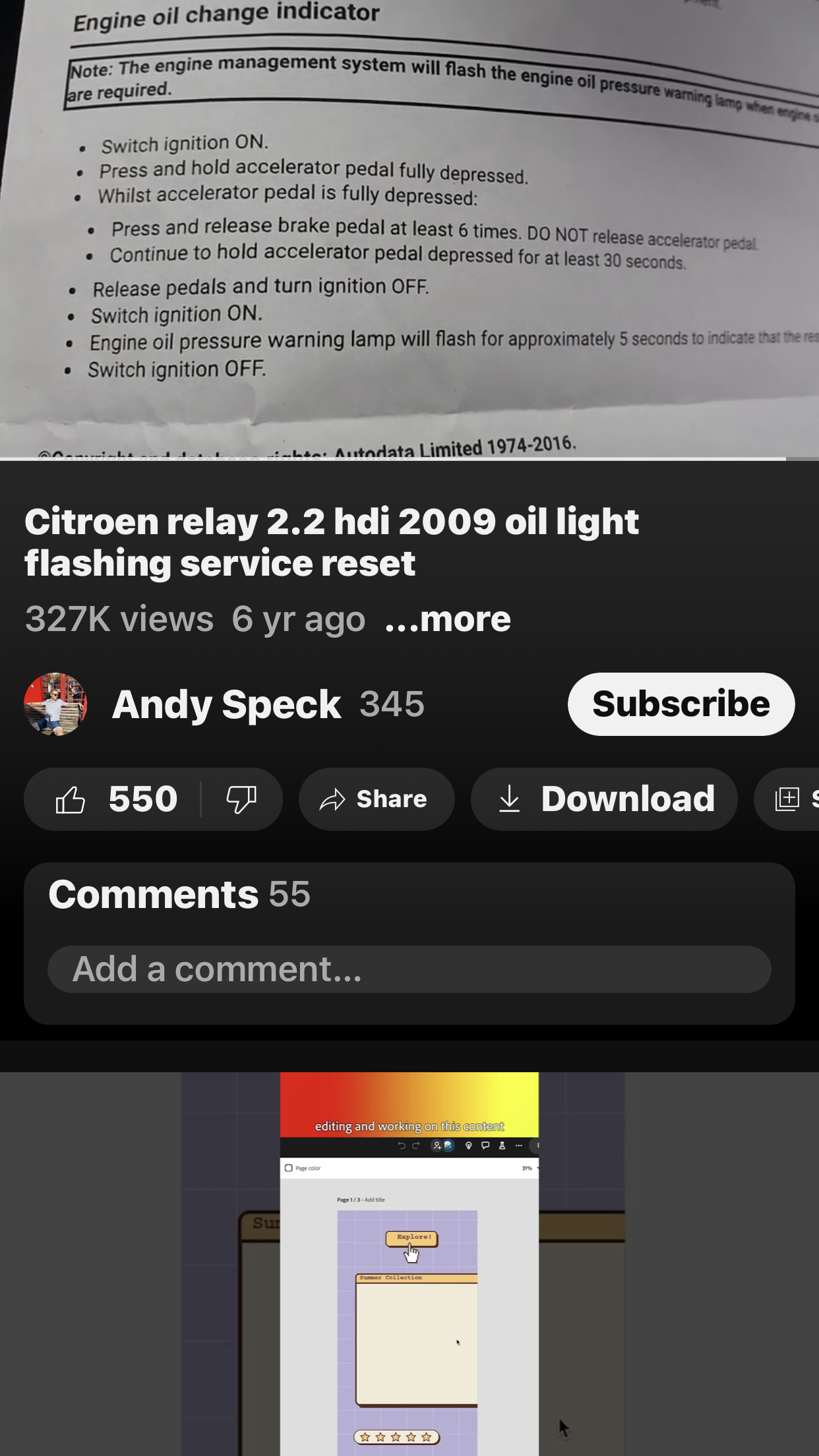

Hi, it seems lots of people are stuck with this one as I was .
How to turn flashing oil light off.
Found this on YouTube it’s quite simple really.
This seems to apply to most multi jet engines from 2007 to 2018. Maybe many others.
Turn Ignition on press accelerator Keep pressed in then press footbrake seven times keep Accelerator pedal pressed in for a further 30 seconds release accelerator pedal switch Ignition off start Engine.
This should Reset the oil, warning light.
