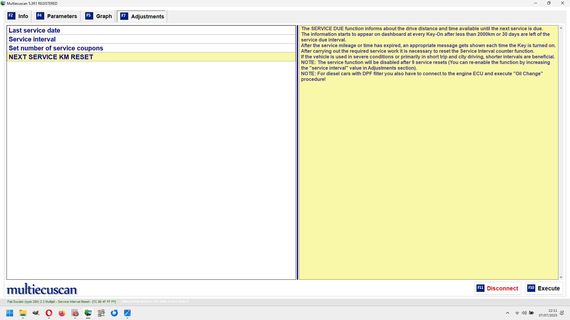

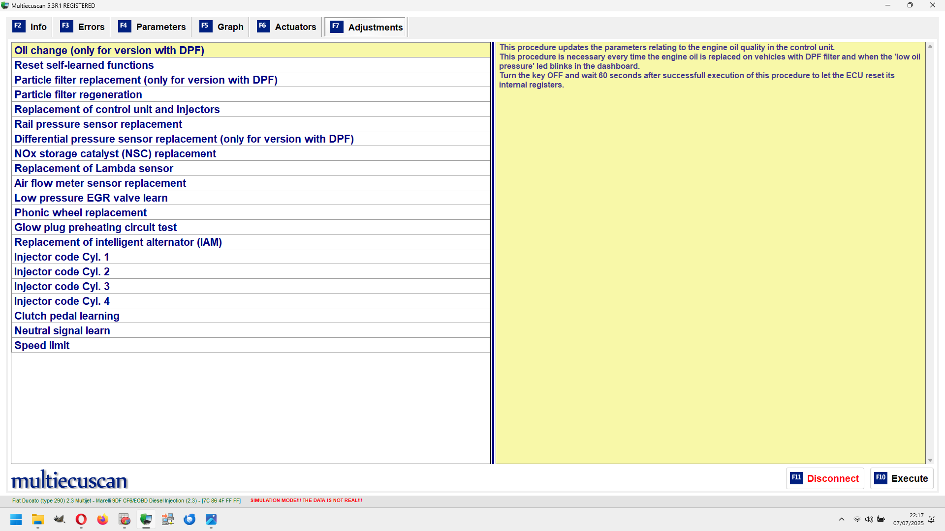

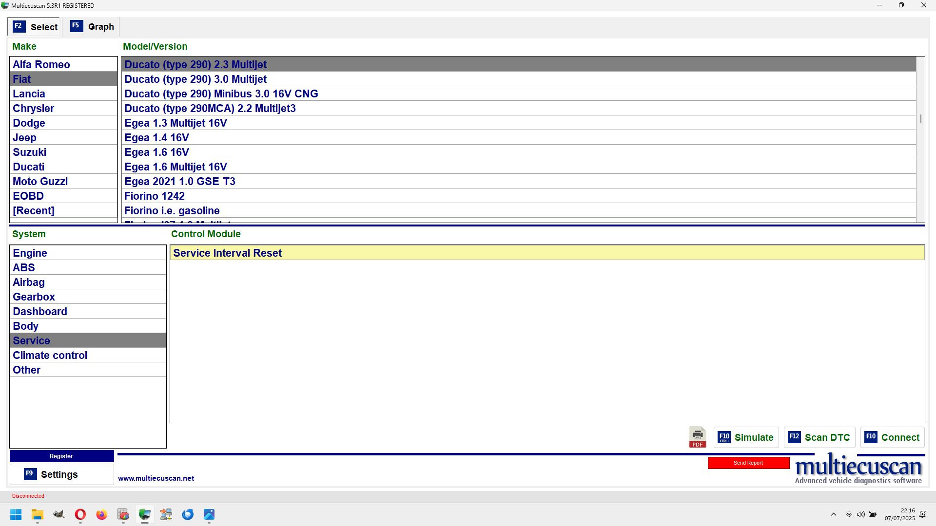

on a euro6 there are 2 service resets to complete. One connect to the engine ecm and the other to the service module (requires yellow adaptor). If the engine reset is not done the ecm will eventualy go into limp mode.
