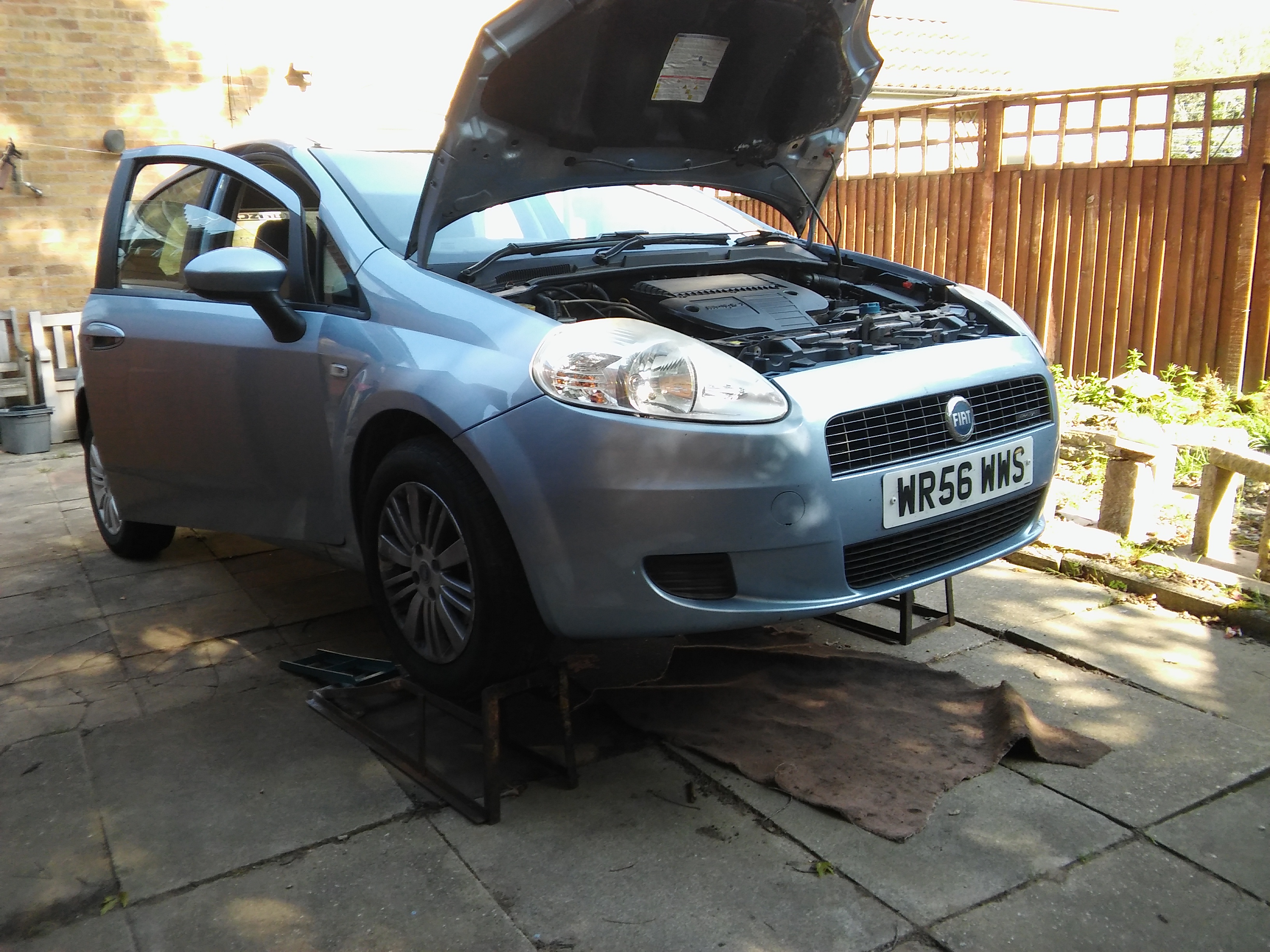

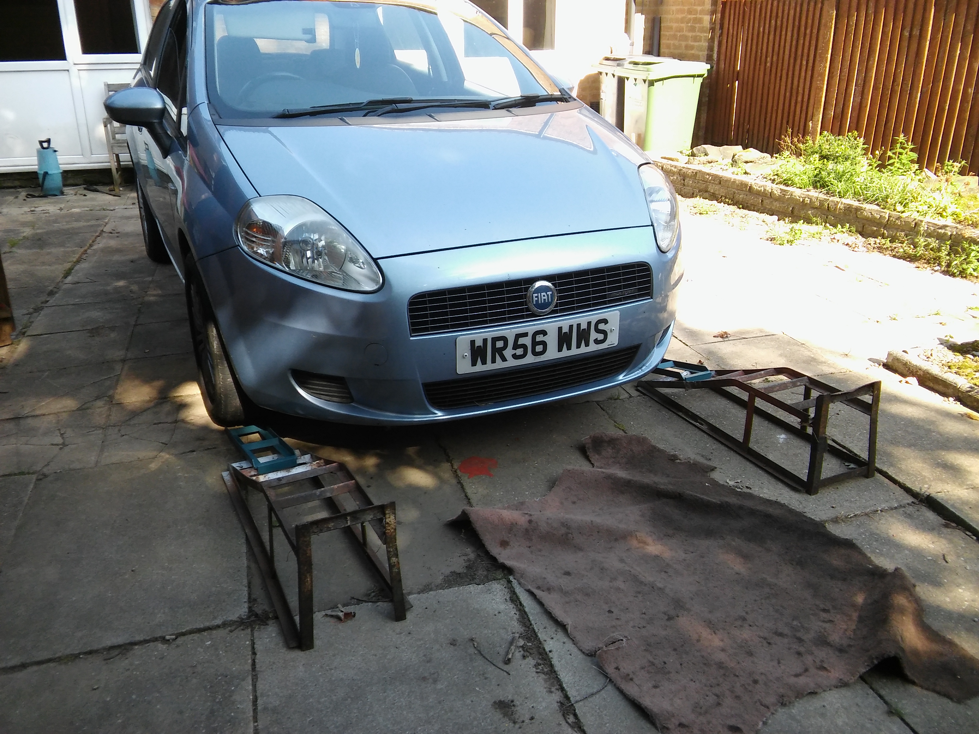

Start by clearing the area you are working in of pets etc, and prepare to get the car onto the ramps
When its on the ramps, chok the rear wheels [sorry, didnt take a pic of this, I used a block of wood]

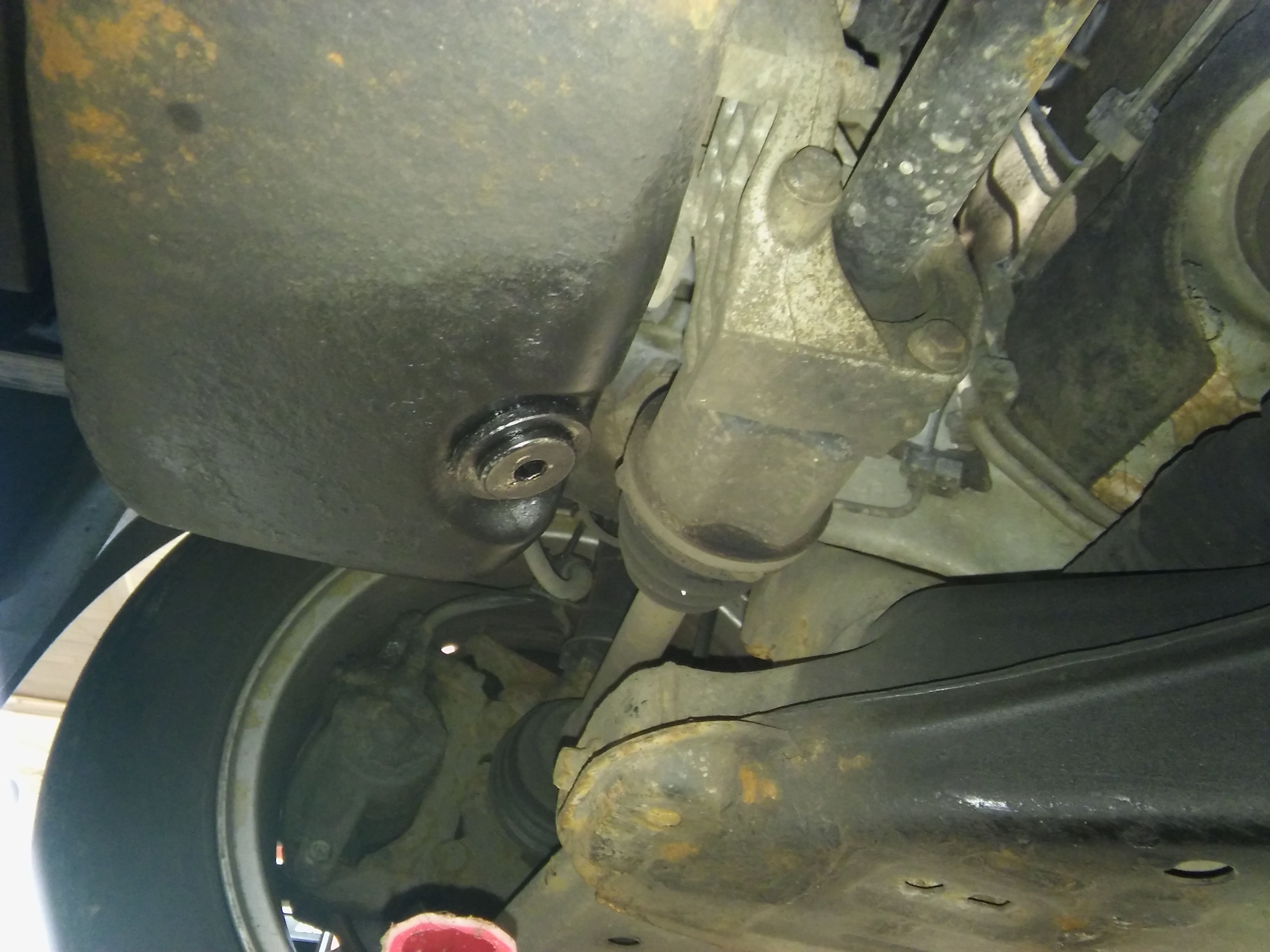

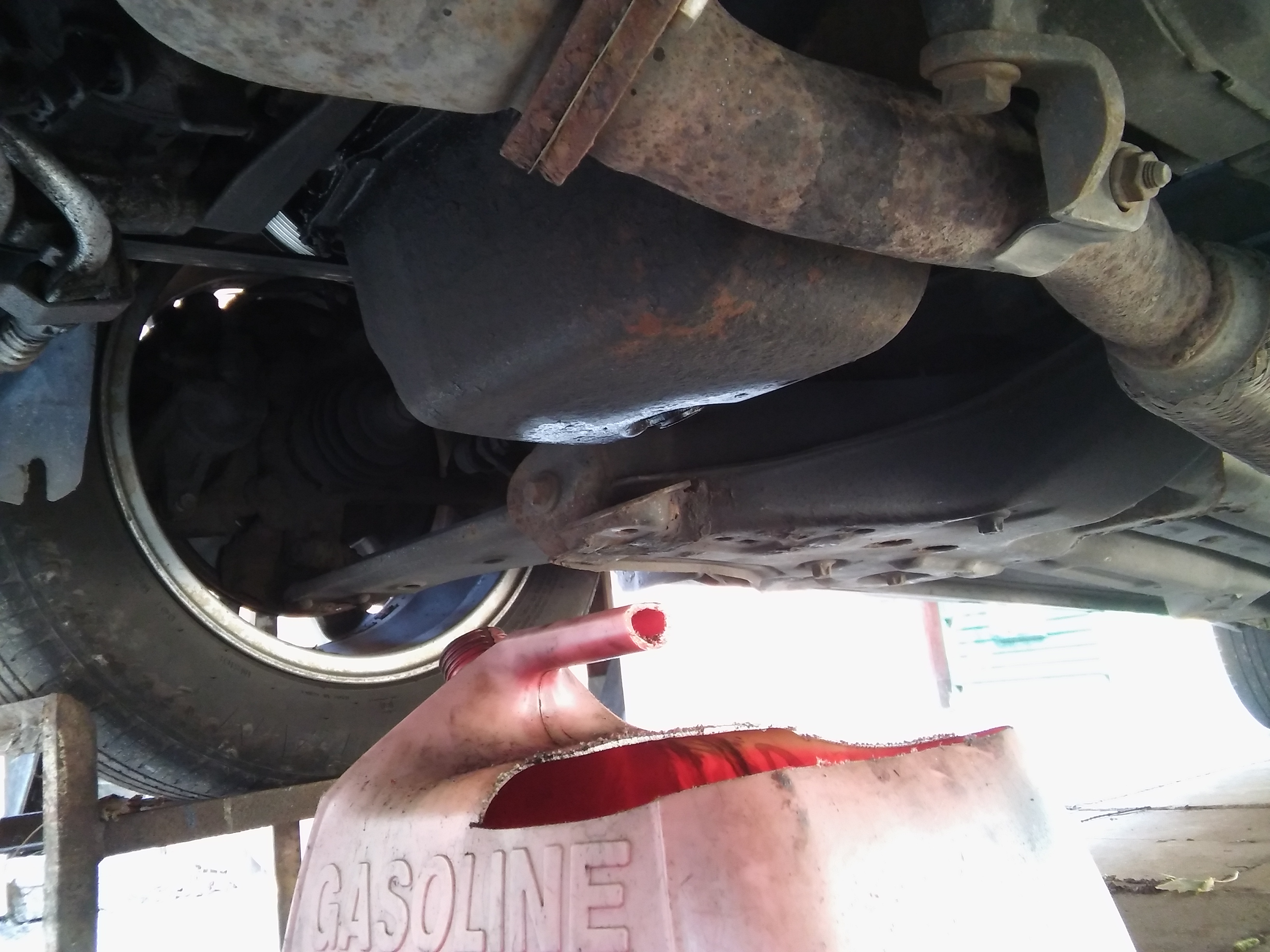

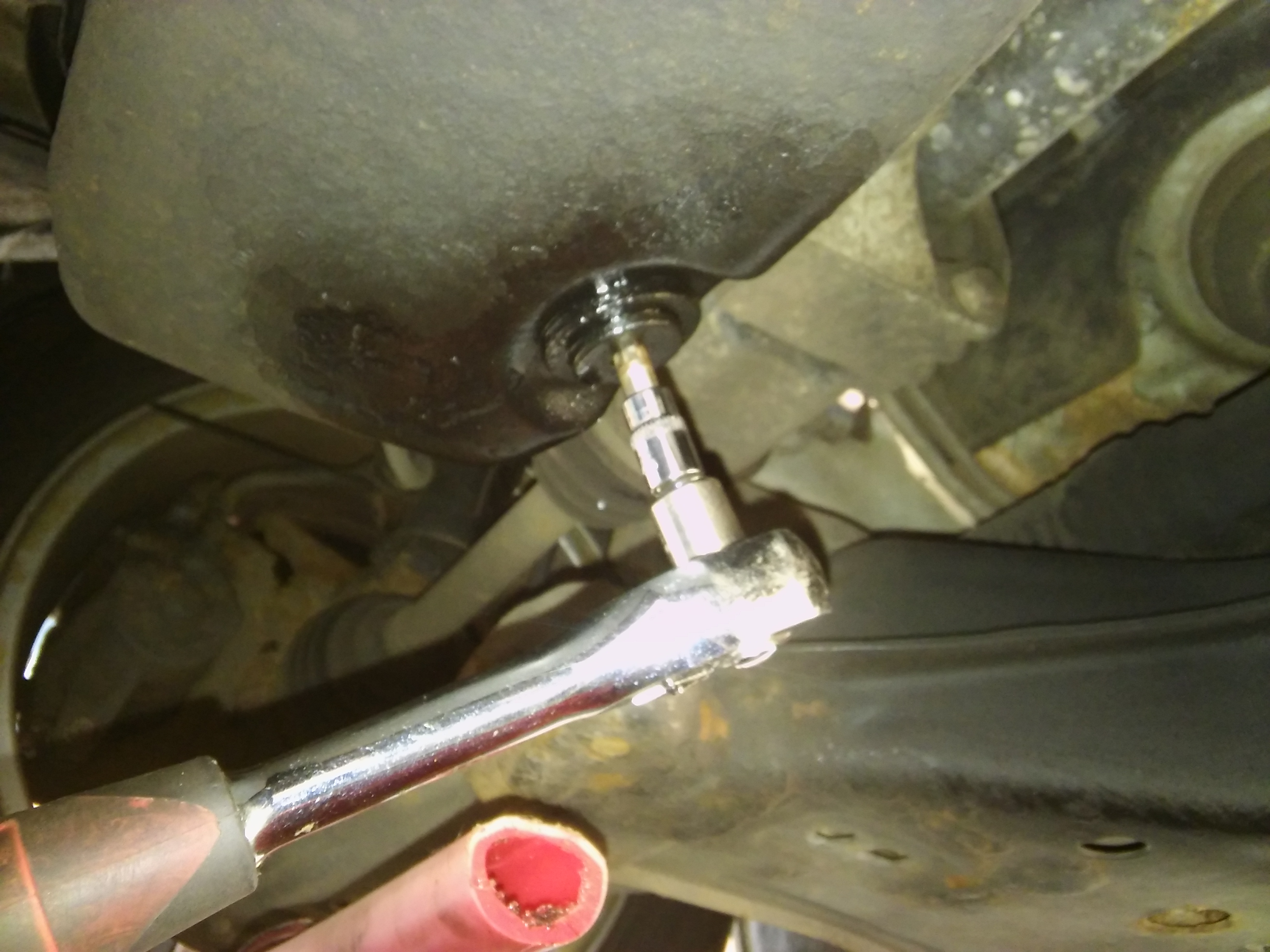

Under the car, locate the sump plug

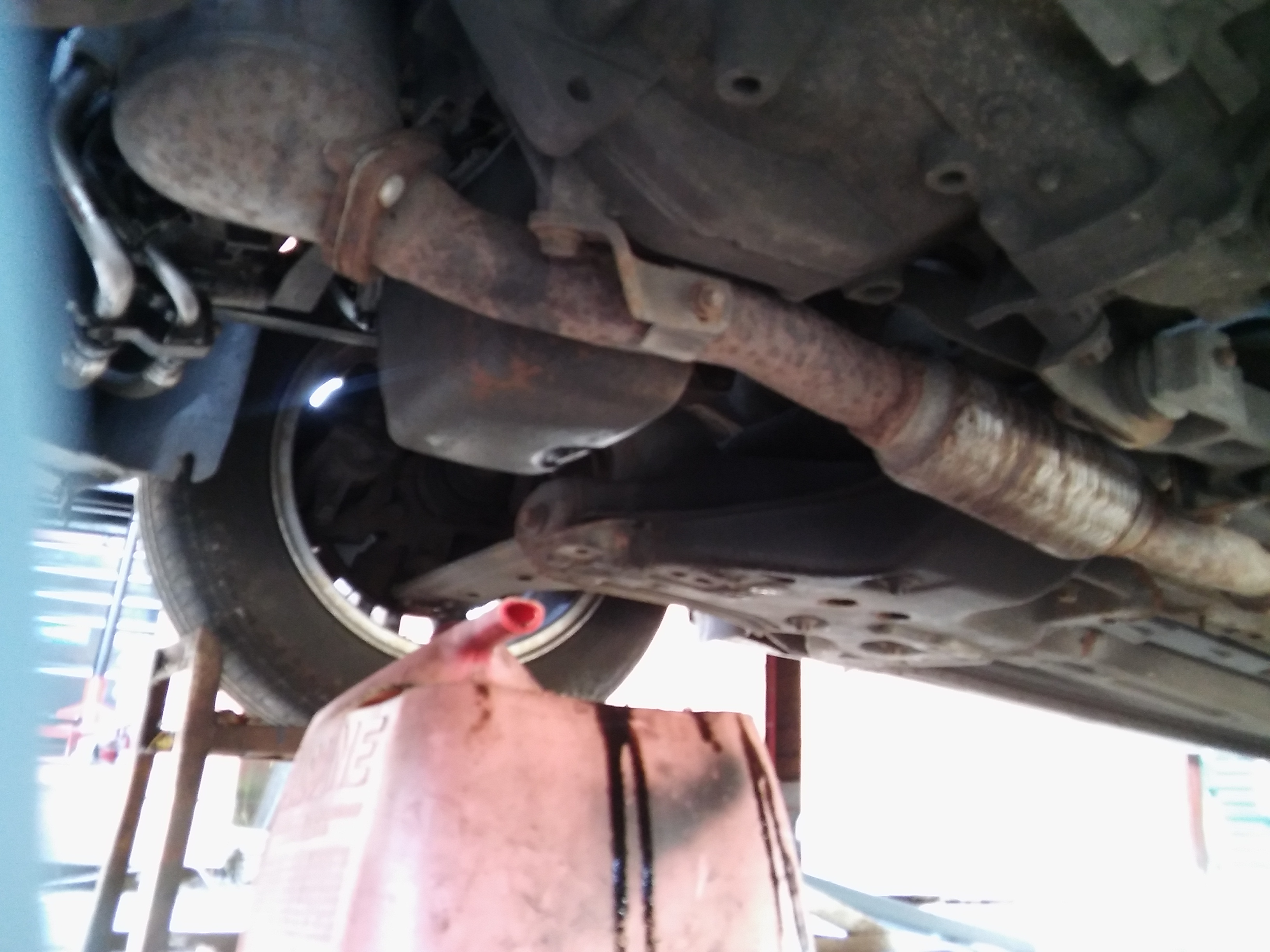

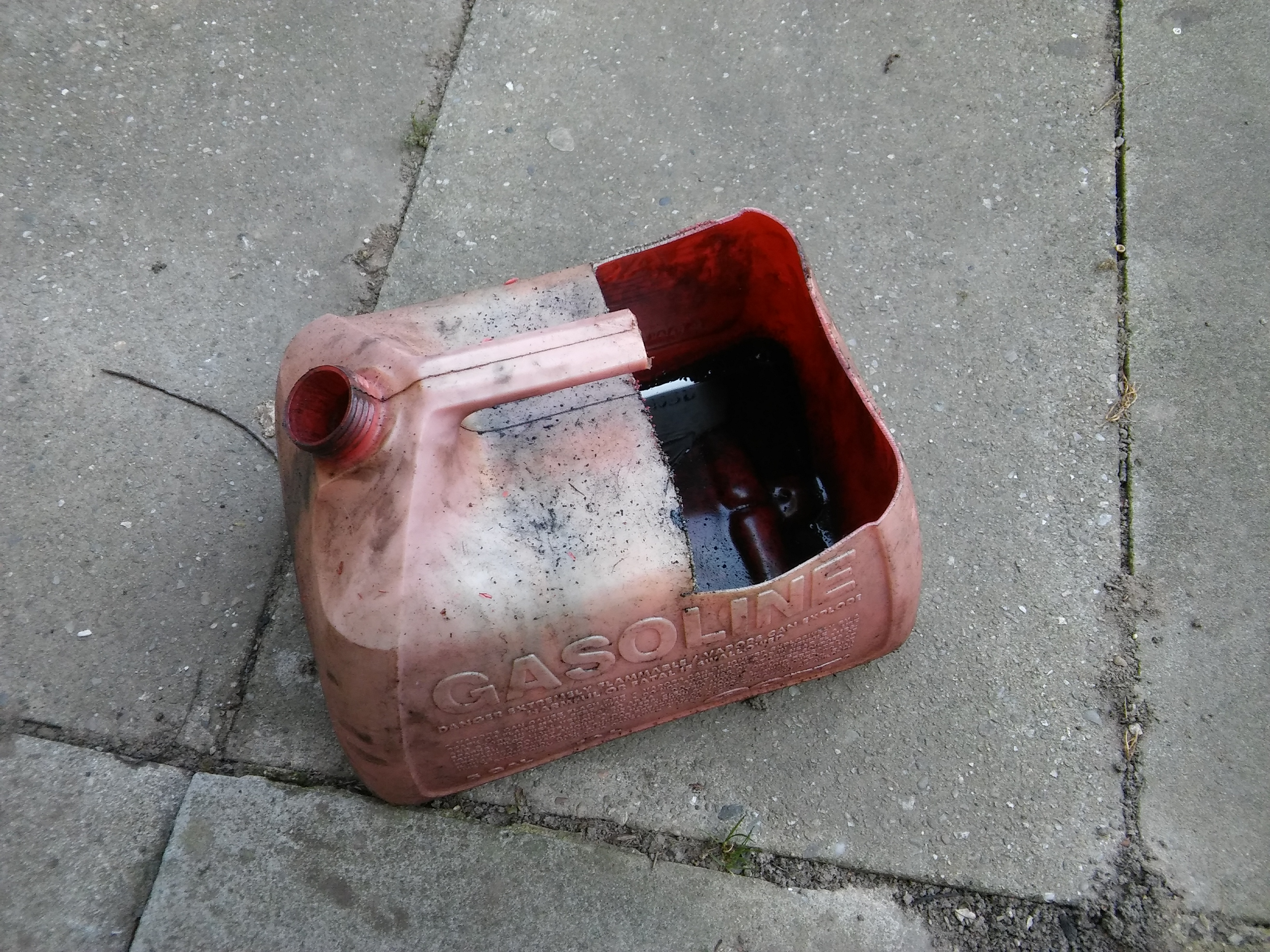

Get your catch can in place

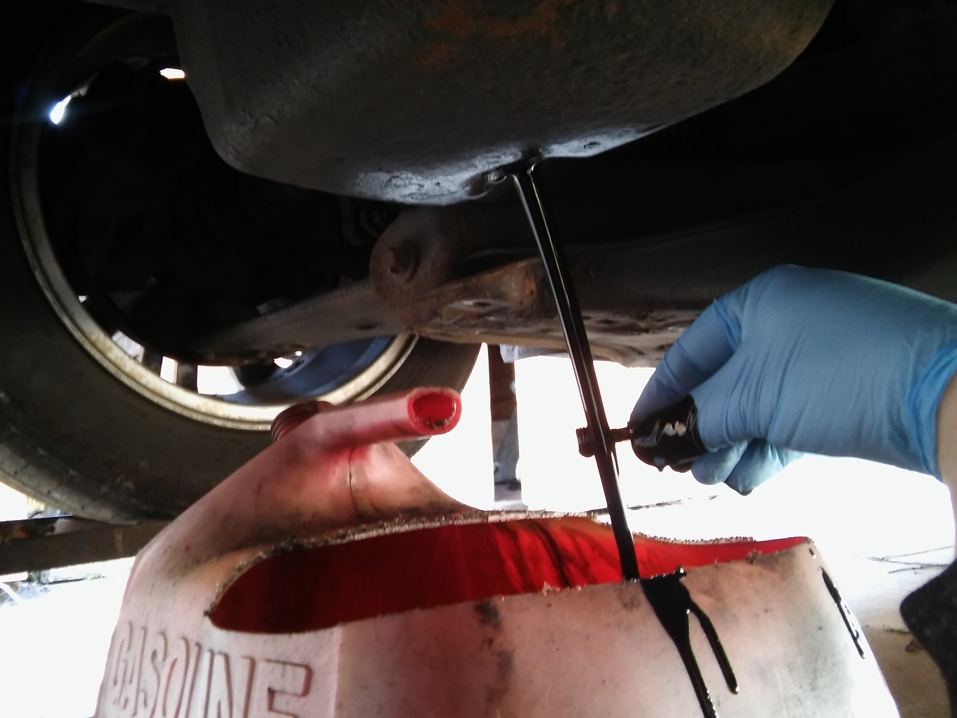

Undo the sump plug, for the last few threads you sort of need to do so in such a way that the oil doesnt pour down your arm when its free of the sump.
Let the oil drain

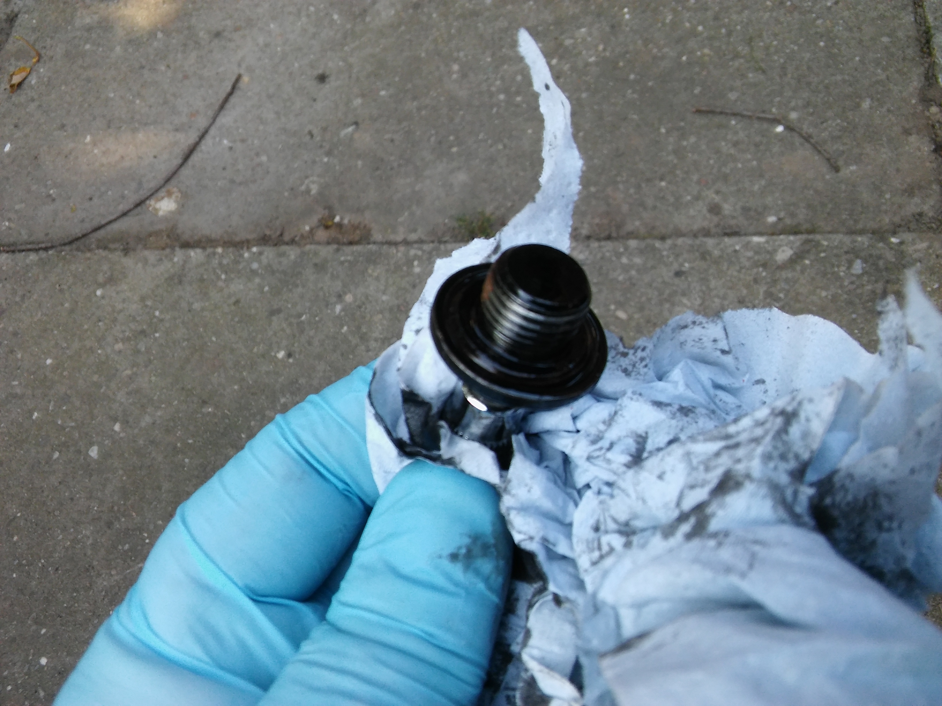

Its worth looking at the sump plug, to see if theres any metal particles stuck to it, mine was good.

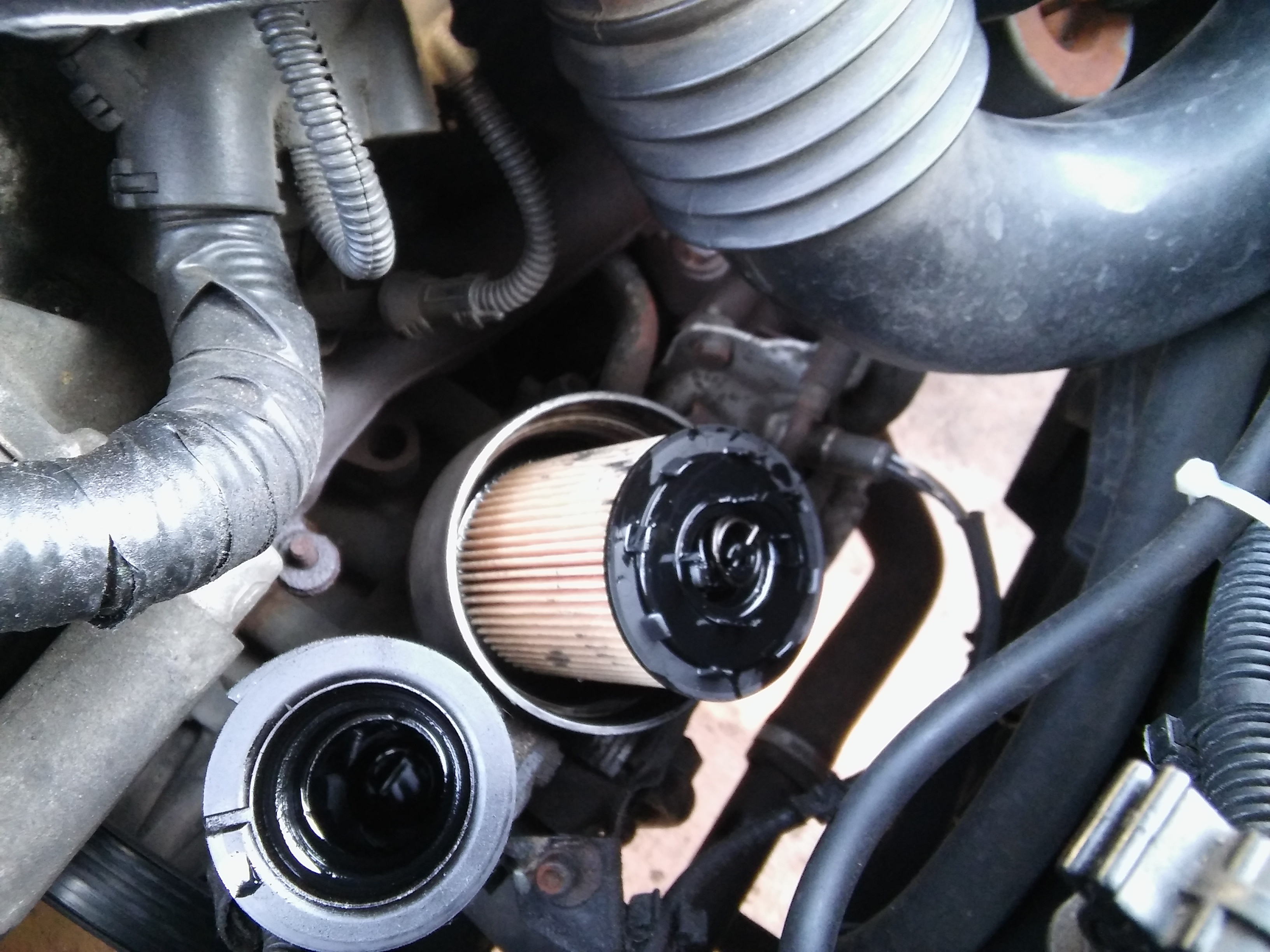

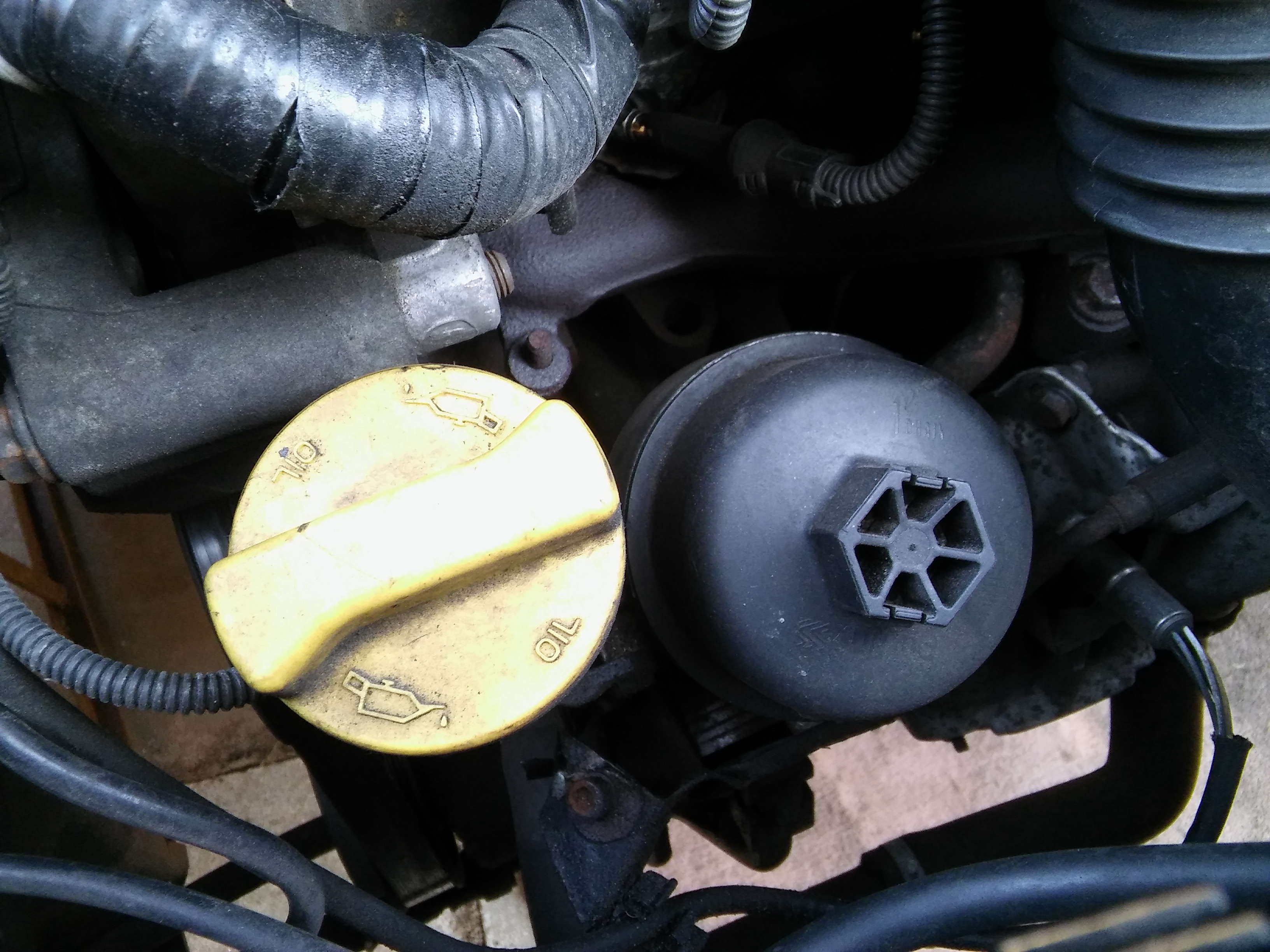

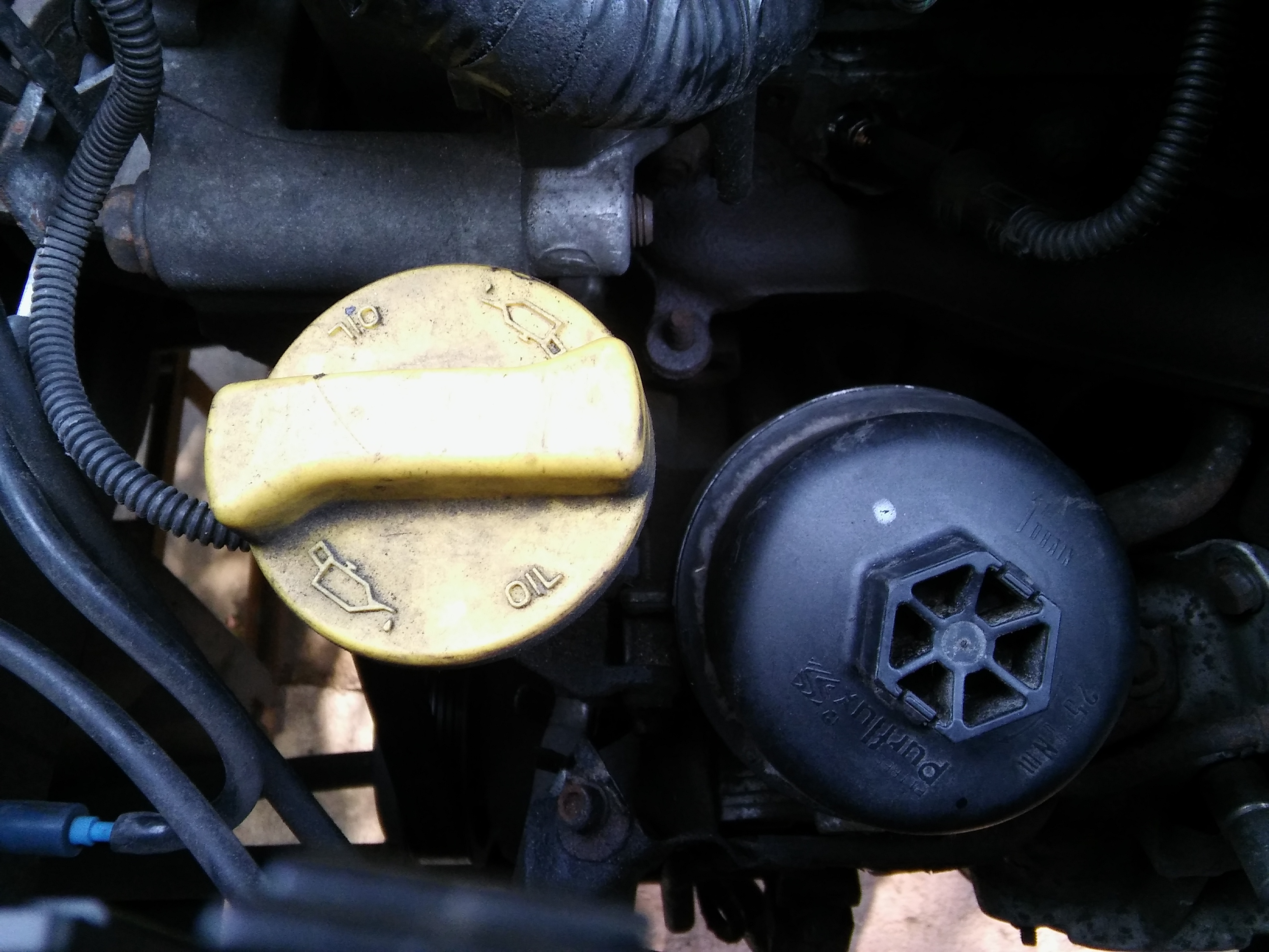

Now, back to the top of the engine, locate the oil filler, and to the right of it [looking into the engine bay] the filter housing.
Remove the filler cap

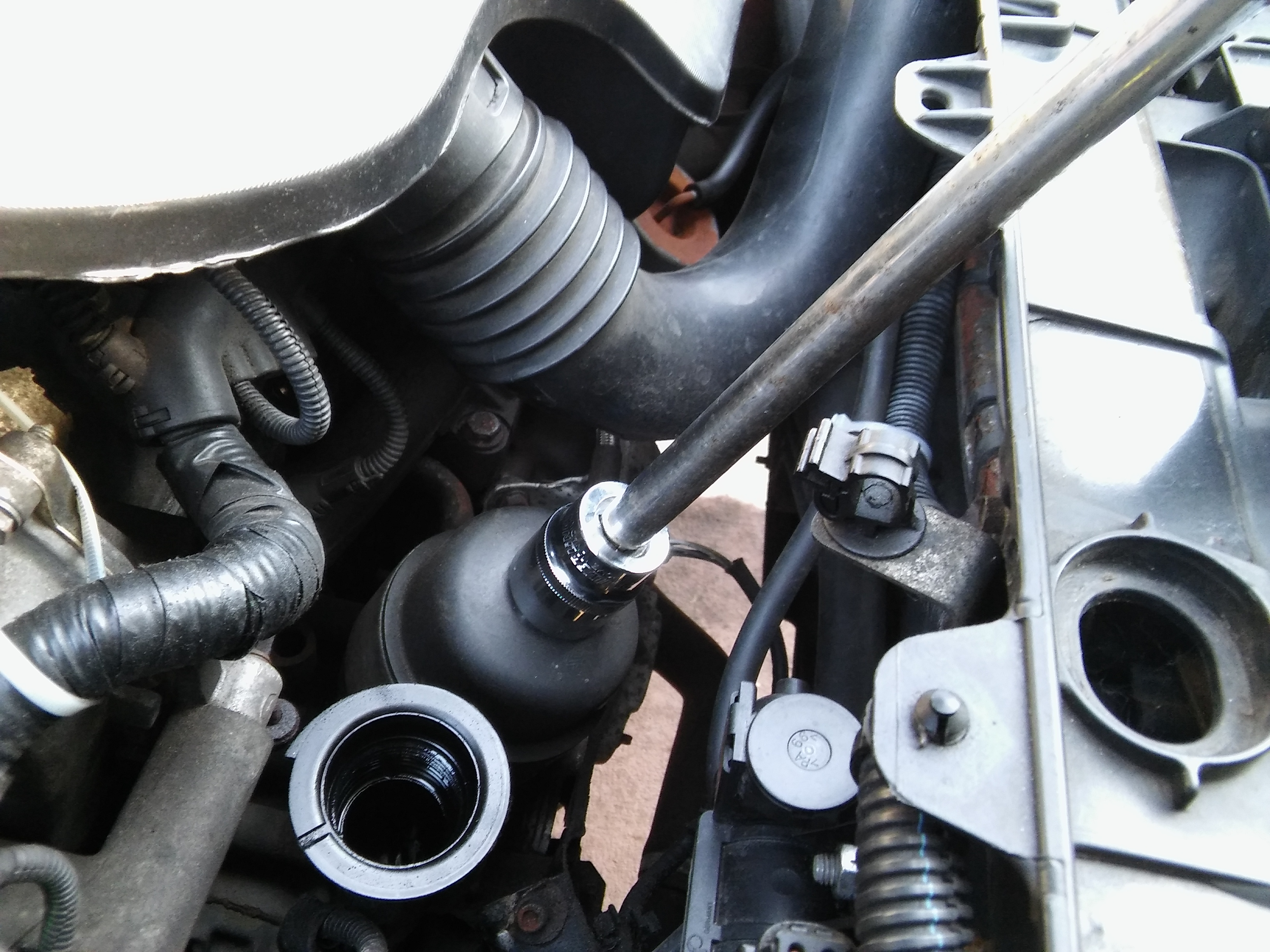

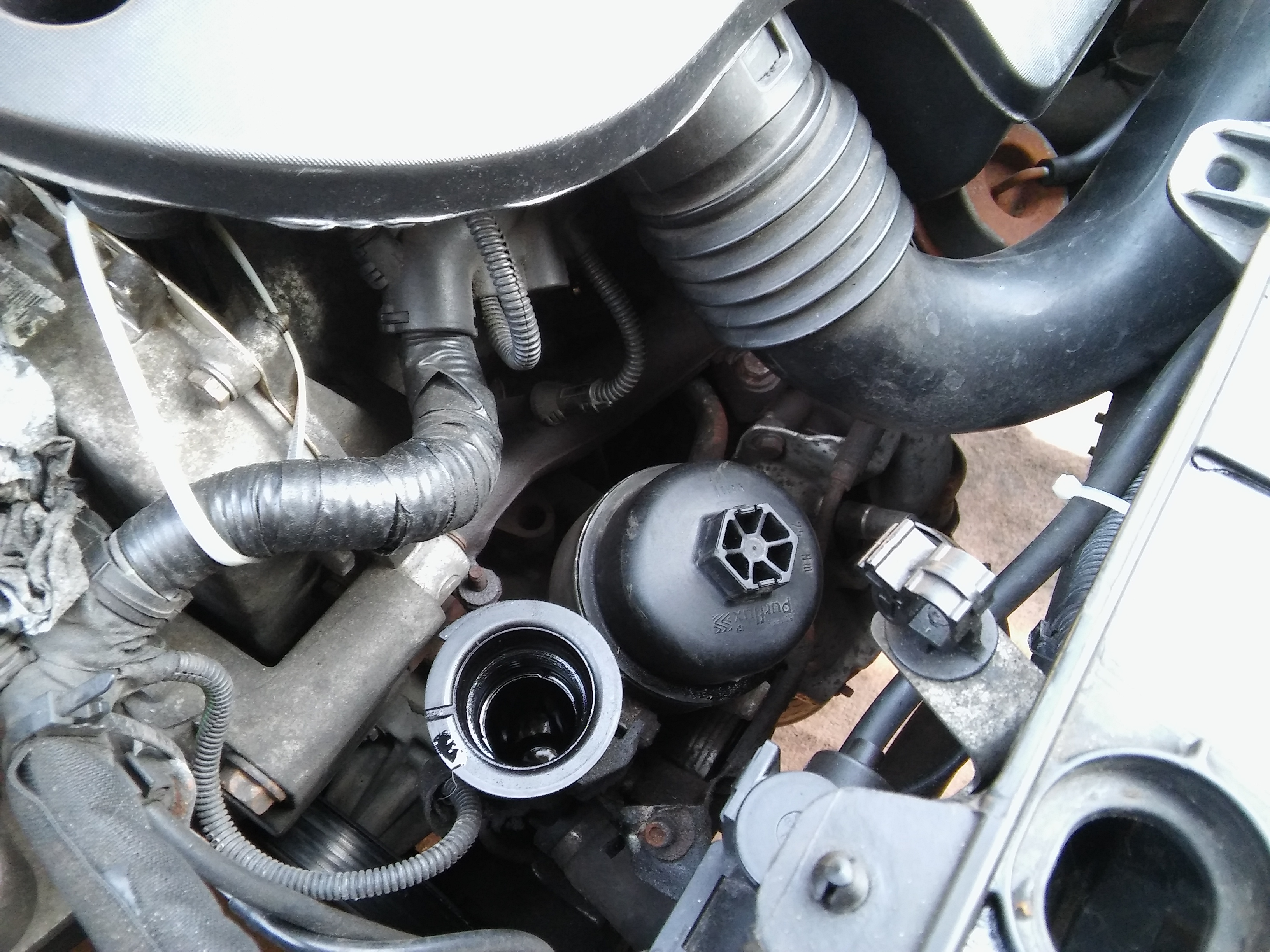

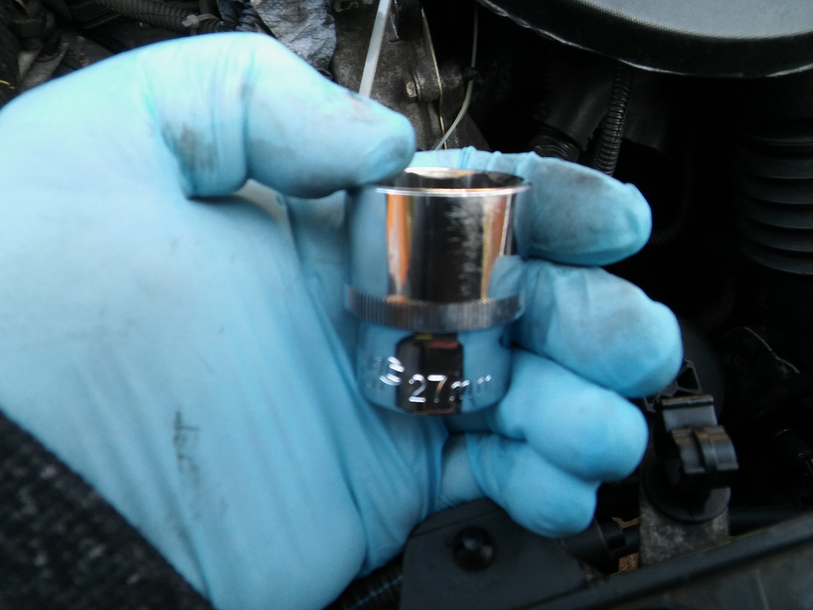

Remove the filter housing, it will be quite firm, beware that its made of plastic so a 6point socket is the best fit, a 12pt will just round the edges of the fitting off.

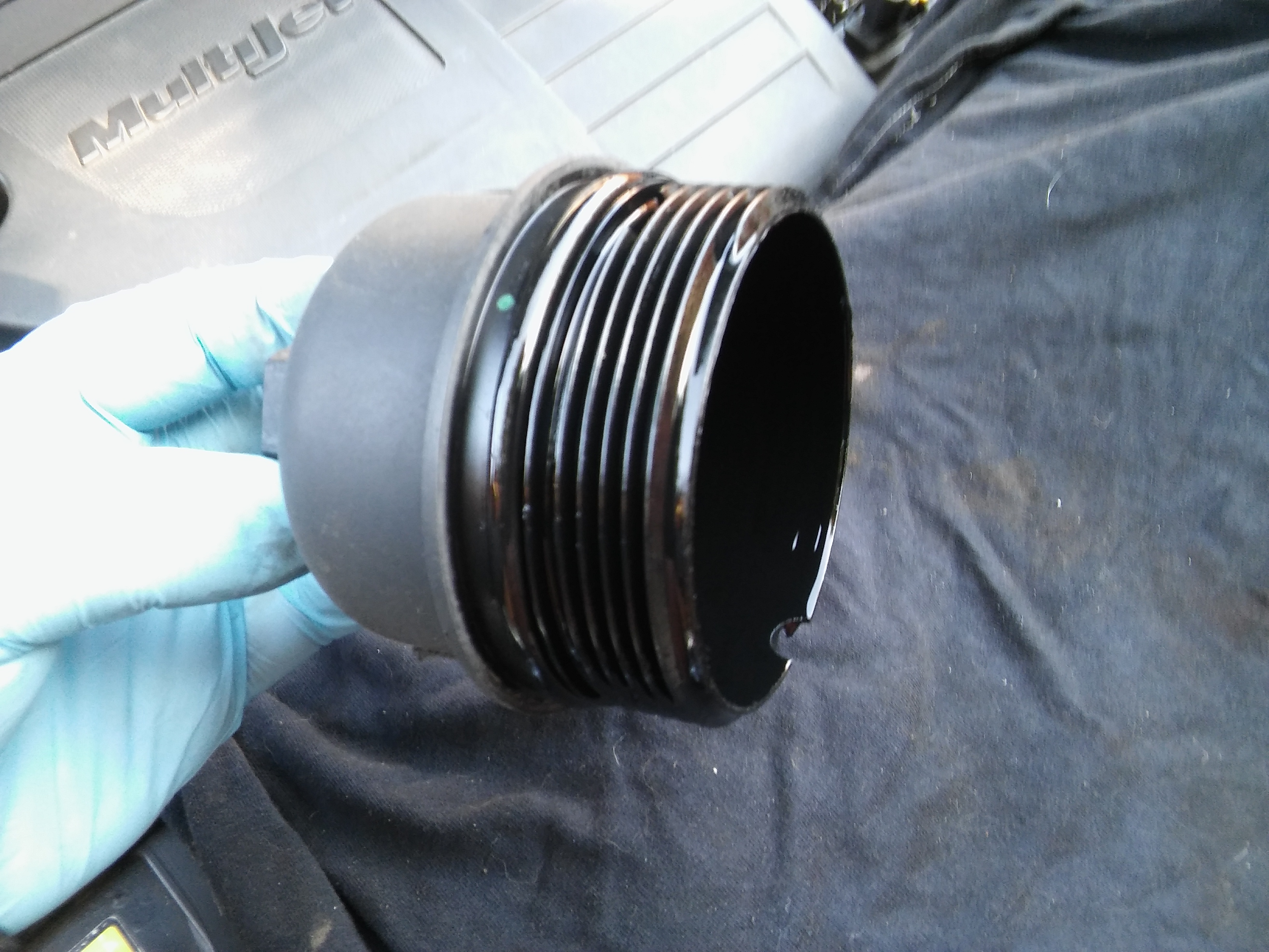

With this undone, more oil will pour out below, retrieve the plastic cap and remove the filter and set it to the side for now.

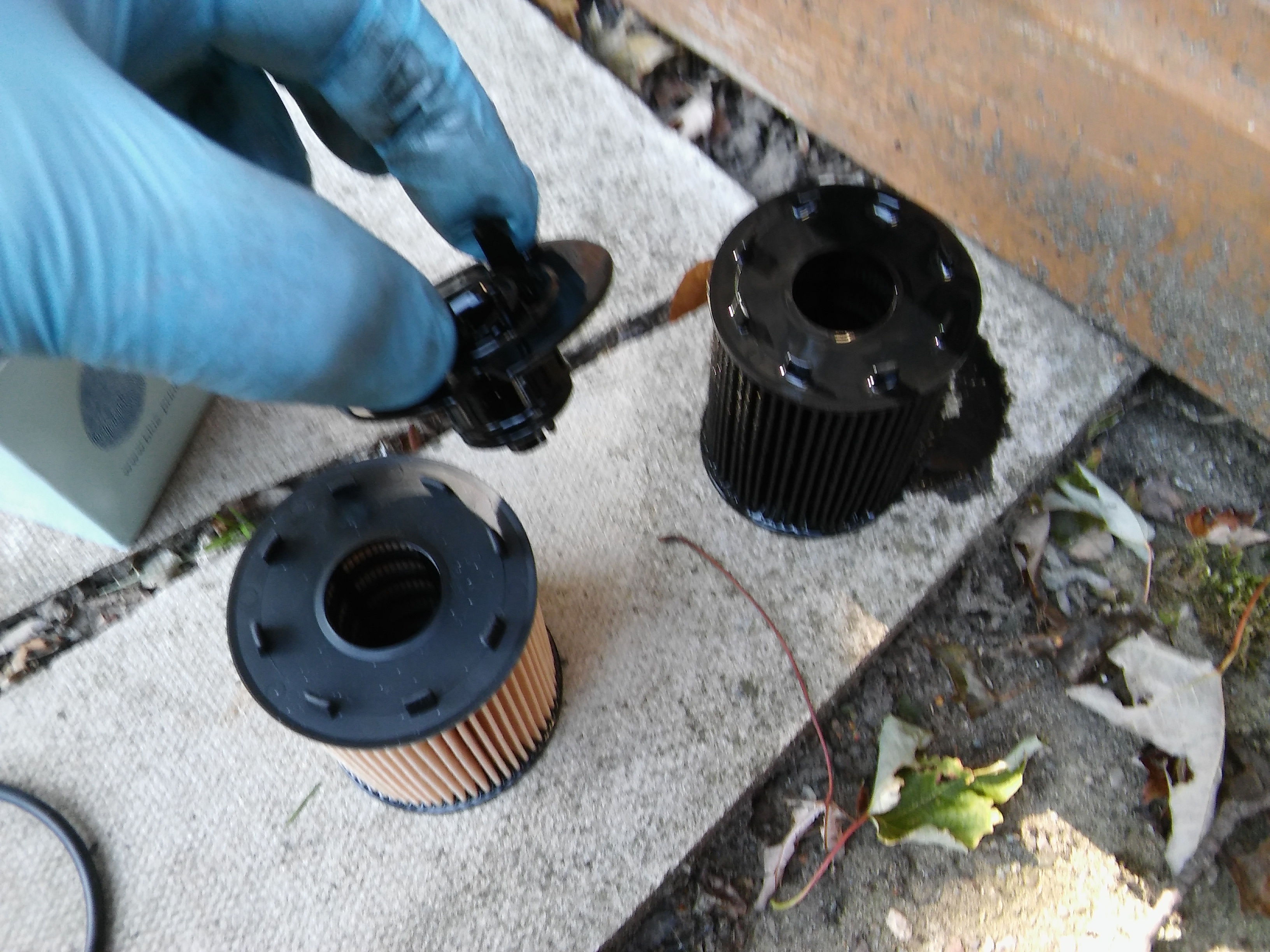

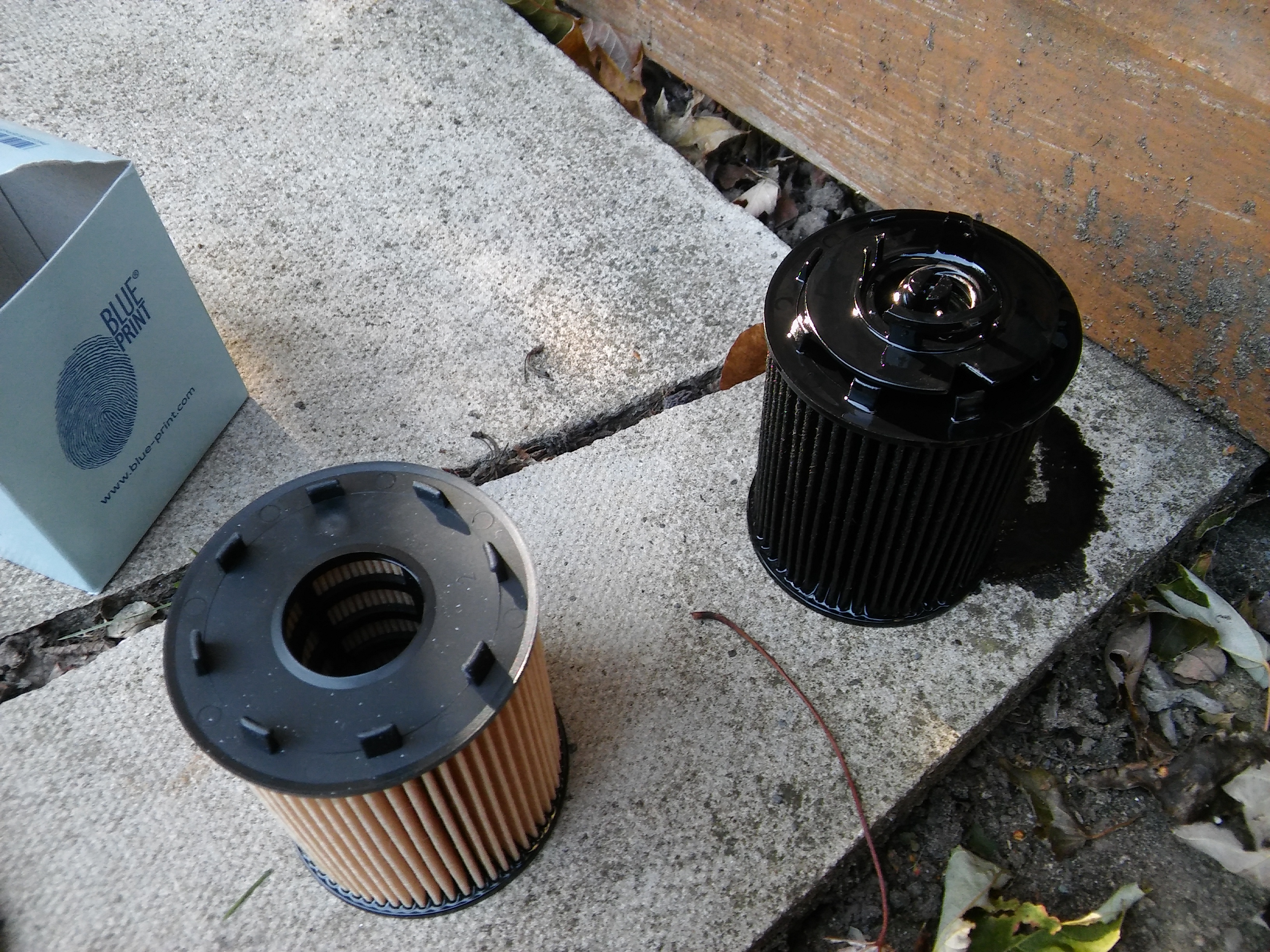

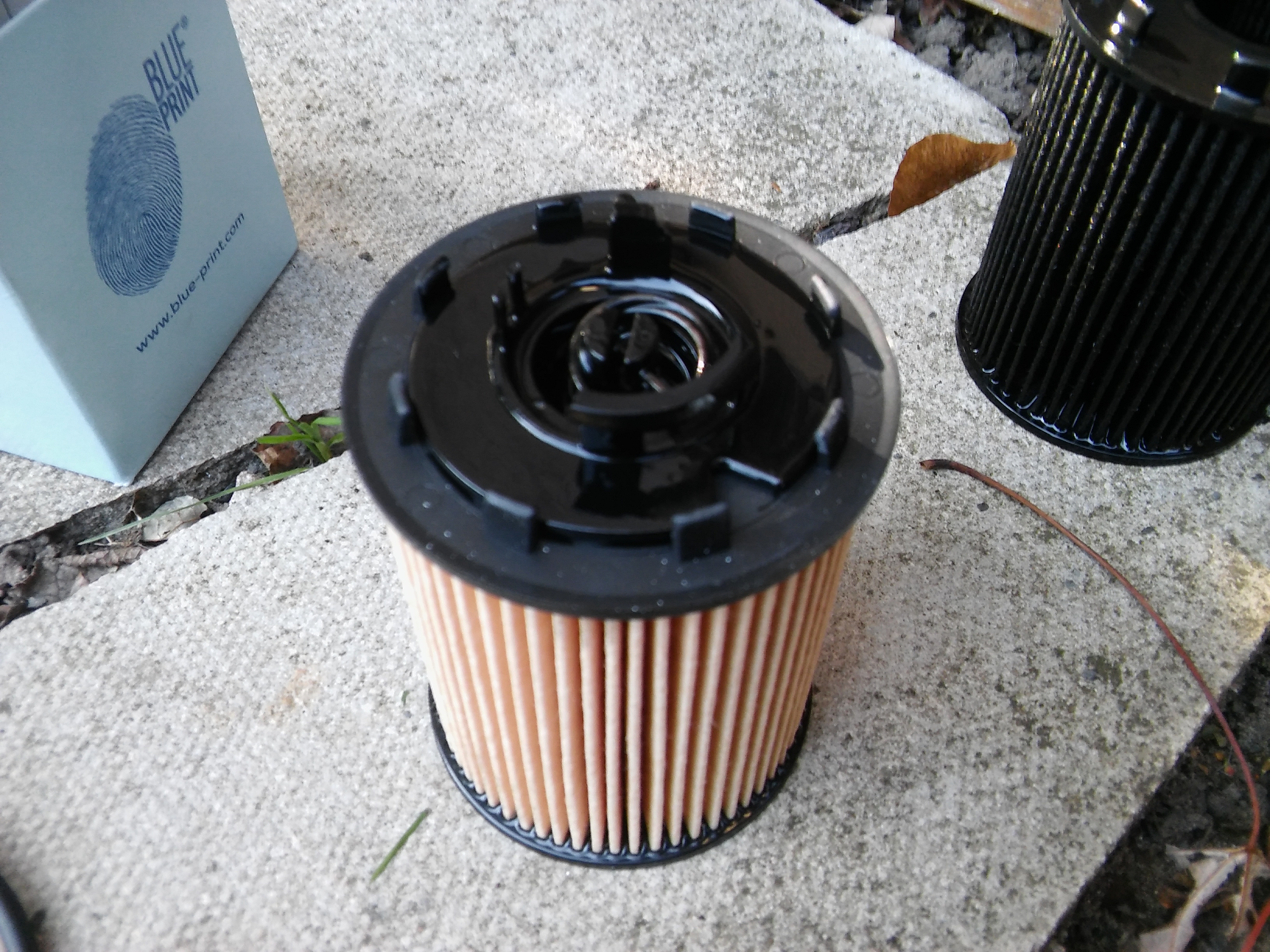

Back to the oil filter, get your new one out and make sure its the same, on mine there is a little plastic fitting in the top of the old filter, you need to transfer this to new filter.
Place the new filter into the housing on the engine.

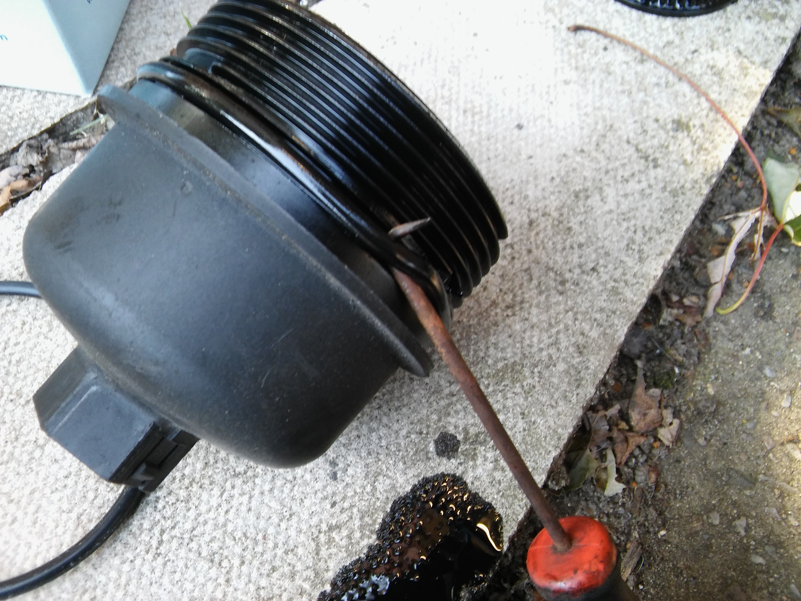

The housing cap, needs to have a new O Ring fitted, this should come with the filter, hook the old one off, and put new back on.
Refit the housing over the filter, it will all line up aas you screw it back on, sometimes you can clip the filter to the top housing to make this easier, screw the housing down and when it stops turning, give it around a 1/4 of a turn just to make it tight, remember its plastic, you will know when its tight.

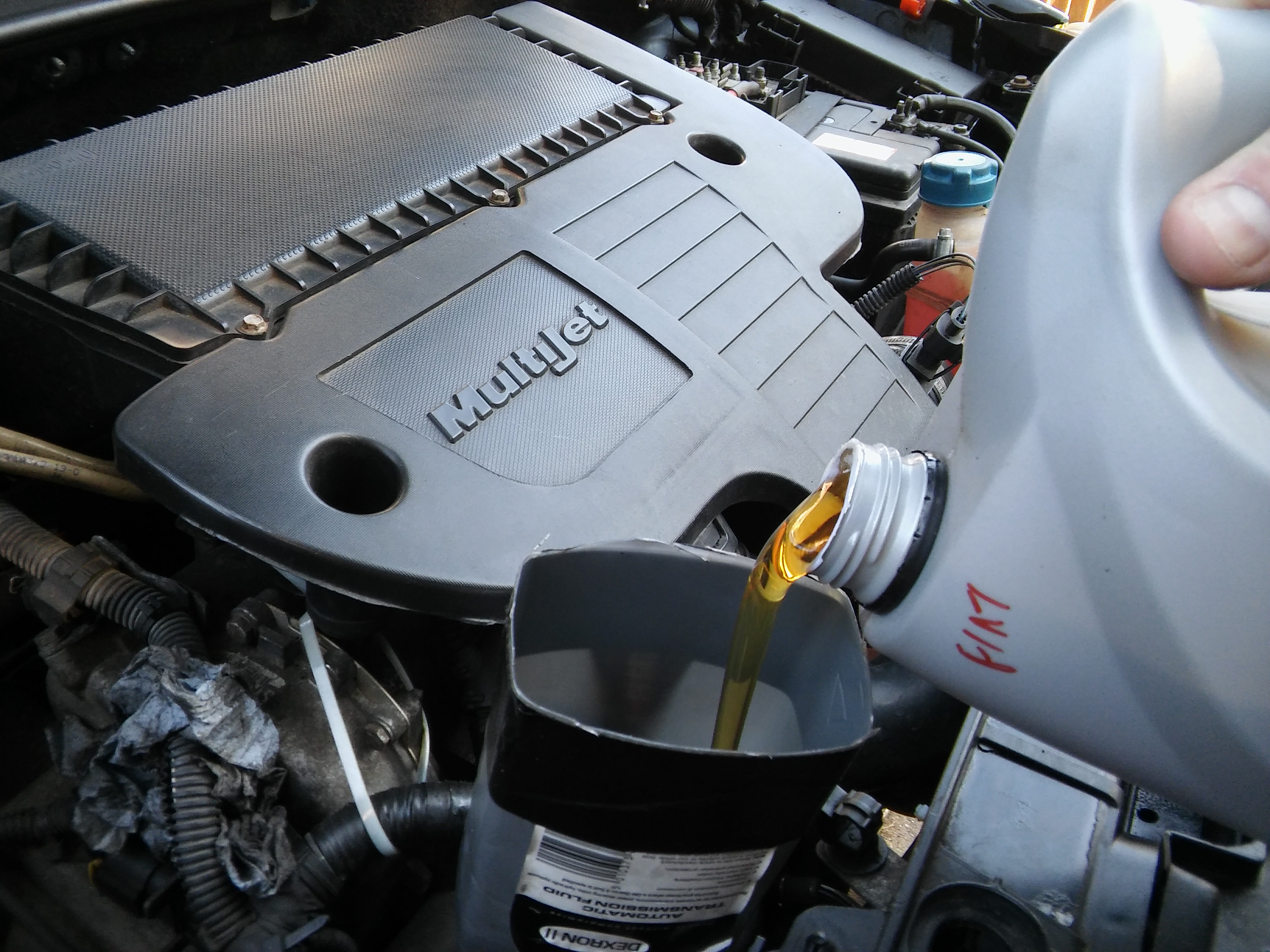

Now its time to pour the new oil in, check your filter is done and proper, check the sump plug is done and proper.

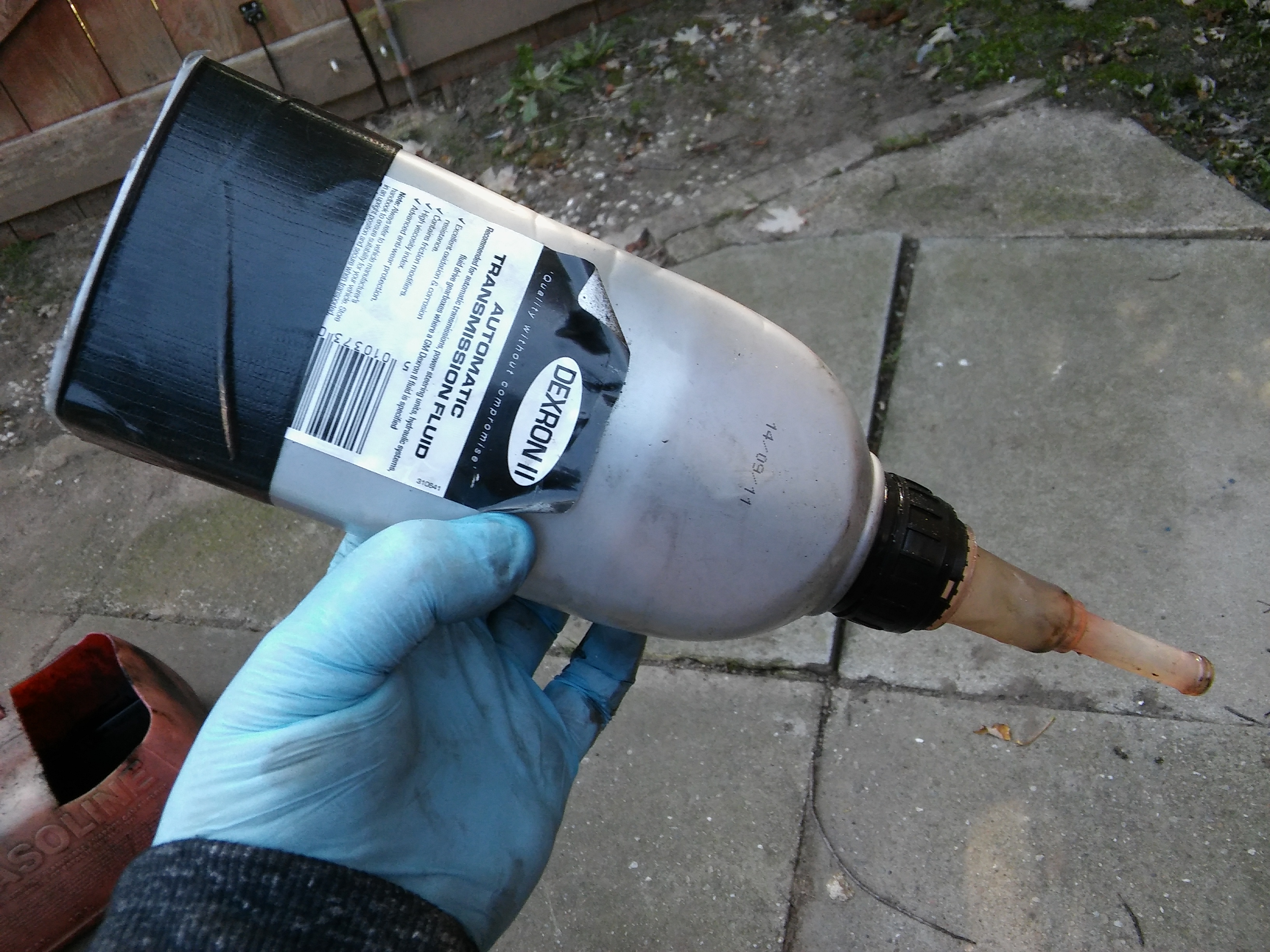

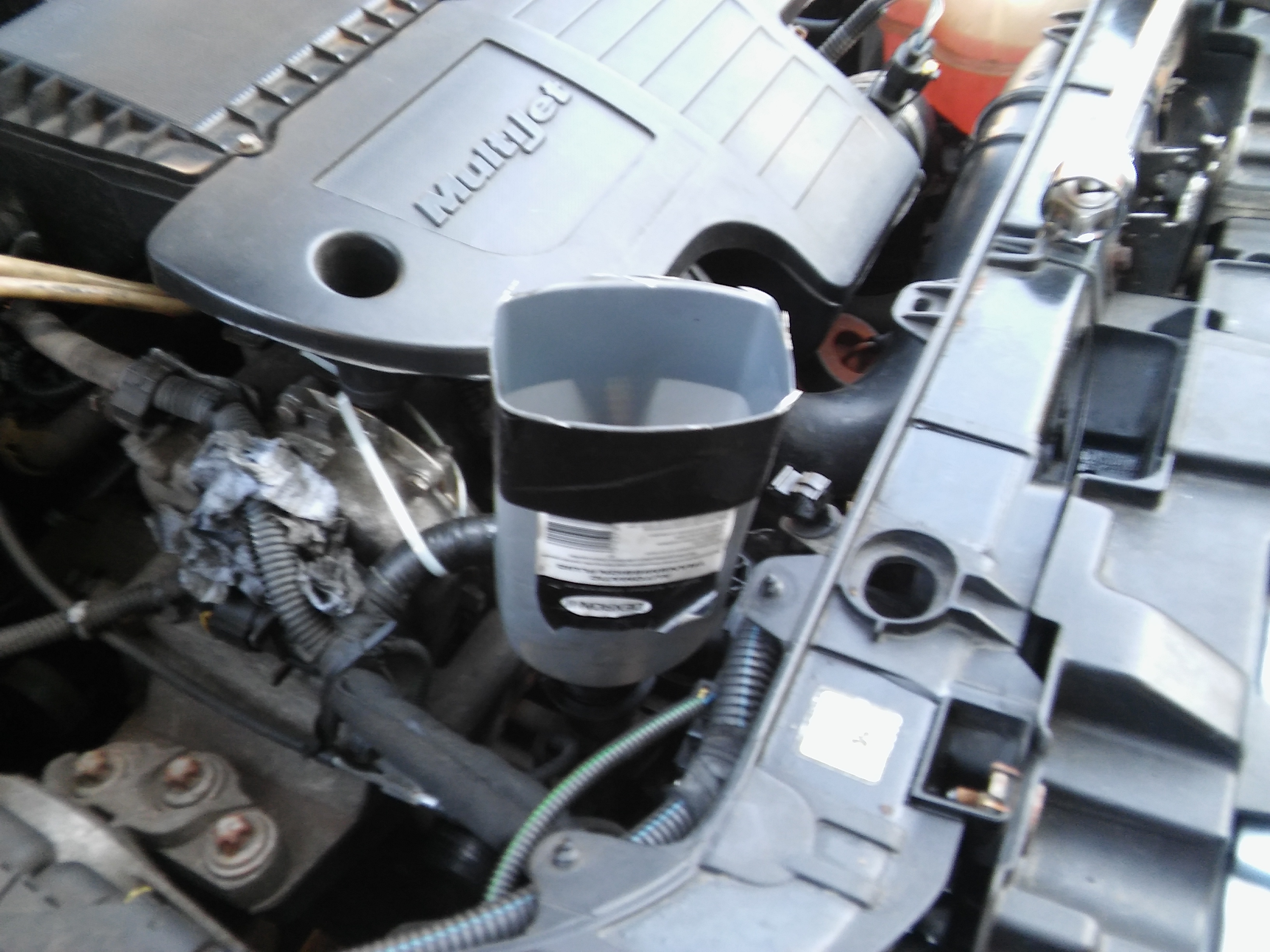

I use a brake fluid bottle with the bottom cut off, and a gearbox oil can filler on it, the spout is quite small so the oil takes a little time to drain through, if you pour the oil directly into the oil filler it will blob up and leak all over the place, it doesnt like oil being poured in very quick, so my spout works well keeps things clean.
3.5L of oil is whats recommended, leave it a few mins to settle and check your levels, top up if required, if overfilled it will be ok as long as its not too much.

- a 6 point [hex] 27mm socket to undo the oil filter housing

- something to catch the old oil in, I used a large plastic fuel can with the top front cut off, its very hand as it can be used to easily pour the oil into another container afterwards.
Let the oil drain
